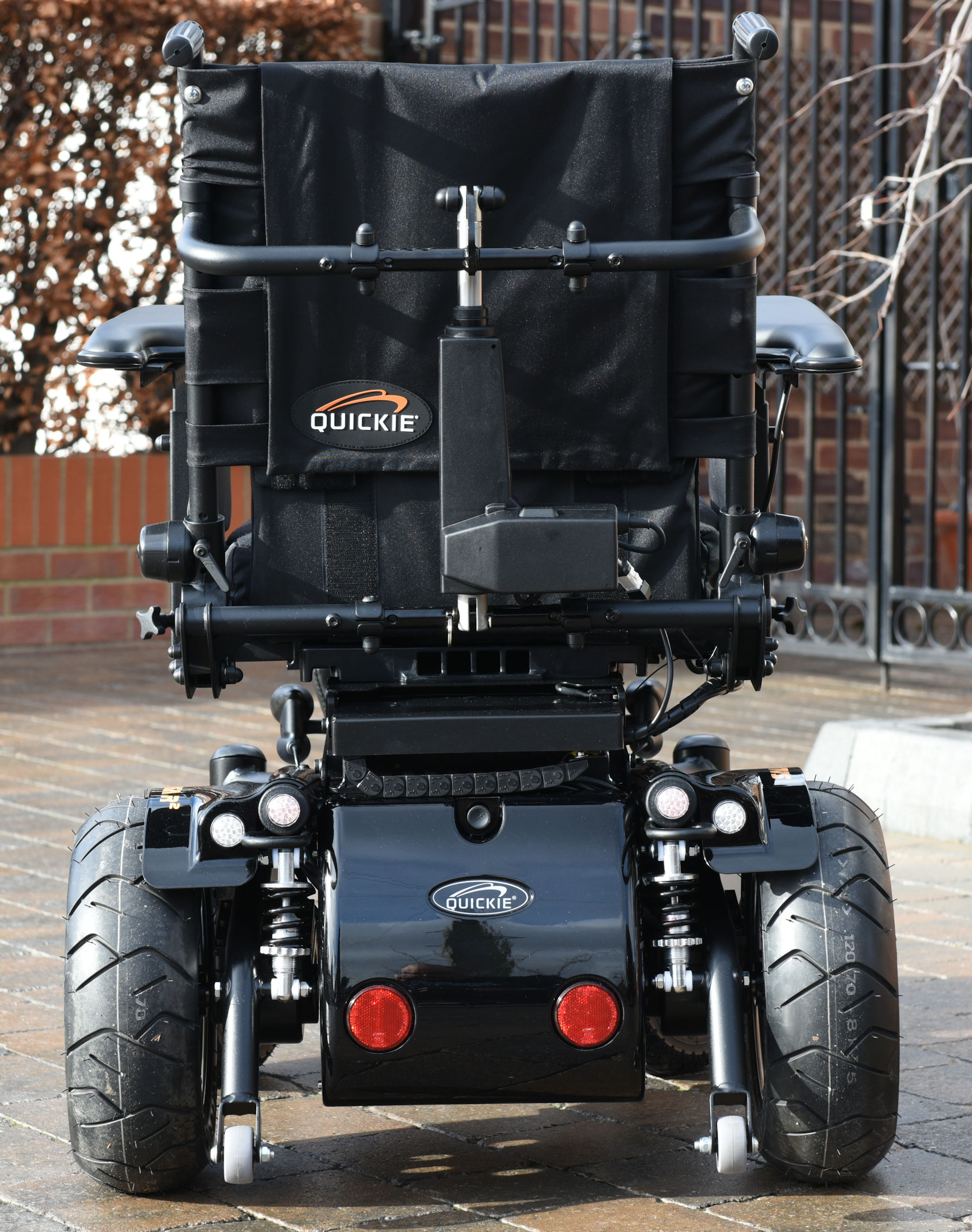

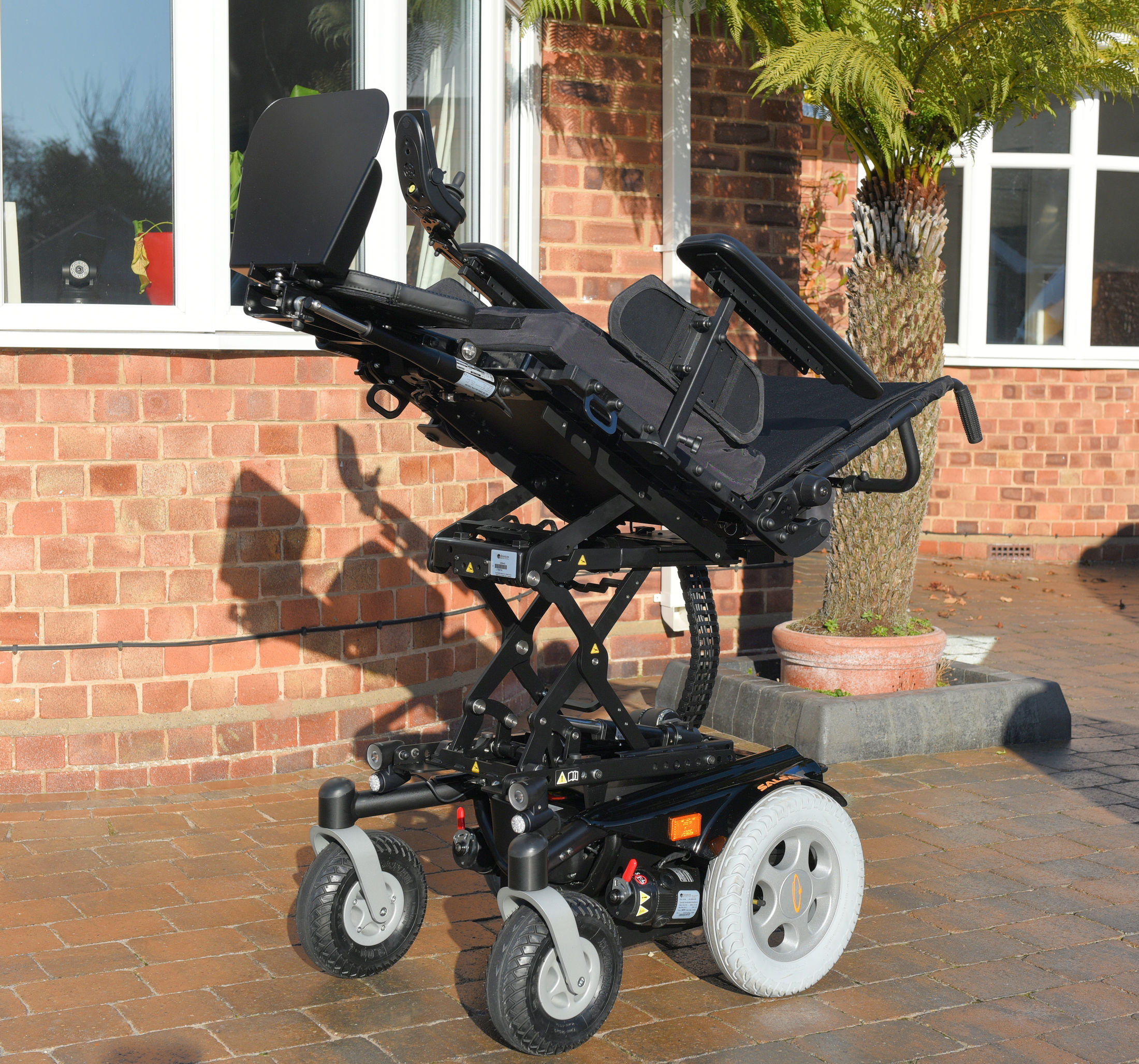

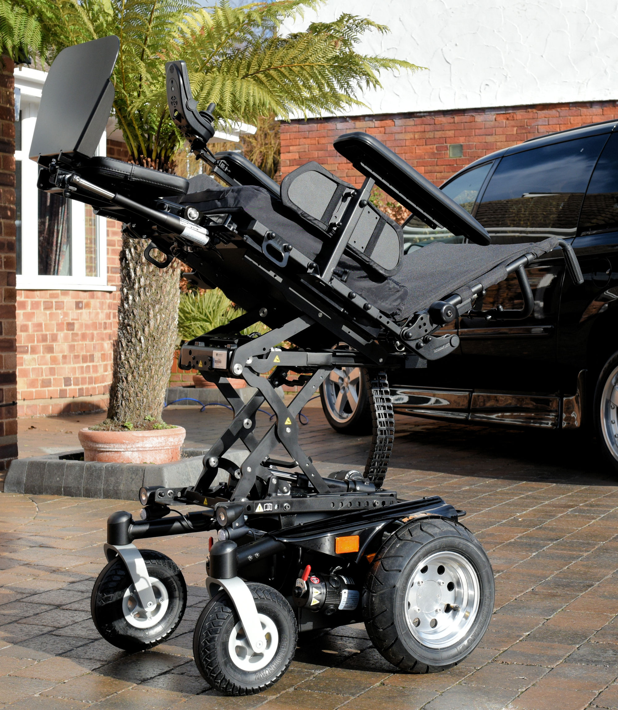

Before and after!
Bicycle tyres, fragile weak looking, overloaded, and tubes, and narrower than the arms so less stable laterally than it could be, for nothing. All stock powerchairs are like this with their flimsy stock 3.00 x 8 tyres. Looks so institutionalised and spindly with skinny grey tyres and they are too fragile for a 185kg rehab chair. And it looks bad, I cant drive this without a bag over my head.
Doesent look quite so fragile or effeminate now!
Wider base, greater stability, tubeless, heavy highway construction tyres with far higher max weight or load rating capability. No tubes to fail or go pop or deflate when you run over a thorn...
-Puncture seal installed, although much less likely to ever be needed due to lighter loading low pressures and stronger tyres. it actually works 100% garanteed on tubeless tyre/rims up to a 8mm hole.
-Also its now wider (bad for most people). But since I am fat, and have wide comfortable arm tops (P shaped jay ones), and an 18 to 20 inch cushion, the tyres are still only the same total width at 27.5 inches as the arms are across the top. So they are not going to stop me getting through any doorway that the arms also fit through. Wider tyres spread load, so dont sink as much on my lawn, last massively longer, and look better, and offer better lateral stability.
More comparisons! Before:
After, lnow ooks more like a grown mans chair... I can venture out without a bag over my head. Rather than looking like some institutionalized flimsy motorised deck chair.

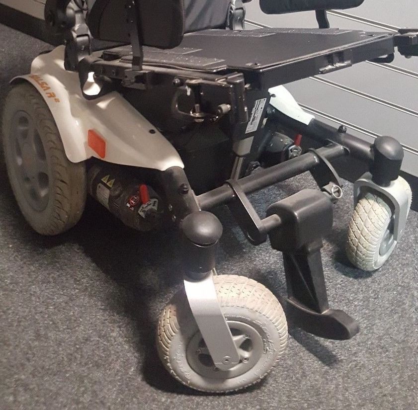

Just for discussion... I was browsing through chairs on eBay just out of curiosity and I saw this Salsa. Putting aside the limited batteries, controller, joystick, motors, etc? If someone like me who doesn't particularly need a tilting chair, the tilting actuator in the photo and that hideous front anti-tip thing could be removed. Then if I could buy a used footplate to fit or if not even with my limited engineering skills I'm sure I could knock up some form of fixed position footplate. I know i would have to be careful that it didn't foul the castors, but I would only need a small footplate. If you look at my rigid chair that only has small footplate. The tricky bit would be clamping the footplate mounting to that front seat tube? Then move the seat back and fit better wheels tyres. It obviously wouldn't be up to BM's standard and nowhere the same performance. But it would be okay for someone like me as a learning chair. I'll wait until WCS visit tomorrow morning and if not try and pick a used Salsa R2 on eBay to play around with before contemplating spending big bucks on a Kilmore chair.
Sorry I was just thinking out loud and I'll now shut up now as this is BMs thread.
Postby woodygb » 18 Feb 2018, 21:04
LOL....That hideous anti tip is a kerb climber ...you bump up hard against a kerb and it lifts the castor wheels for you .
https://www.youtube.com/watch?v=uD2IbGrtqZA
Postby Burgerman » 18 Feb 2018, 21:04
Other than the wobby arms that I personally would find hard to lift on without failure, and difficult to drive well as the joystick moves around nothing really wrong as such. It will work. Get a centre footplate, remove swingaway things. It will be nose heavy, need seat relocation, and programming. Its likely to not steer well regardless because of 2 pole motors, and be 4mph slow. But as long as you realise that its fine. It works in a fashion as most are like this!
But its a starting point at least. And 4 pole motors go for 200 used.
