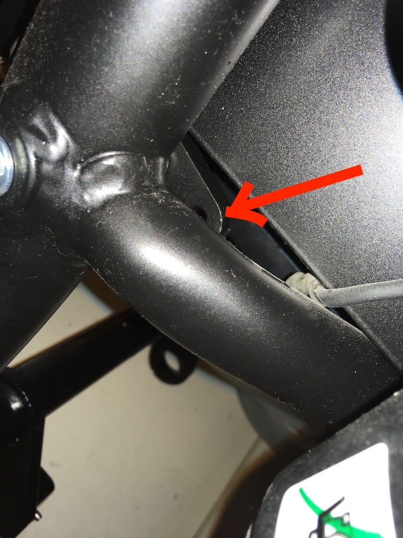

Changing the subject can you look at this photo. To remove the recline actuator mounting bracket is it these four bolts need removing?
https://flic.kr/p/25n1YjU

Dunno, Dofferent seat to mine. But probably!

Fair enough. I’ll have go, I was just concerned about 4 nuts disappearing into the depths of the chair and saving me fishing them out. :thumbdown: :)
Postby foghornleghorn » 23 Mar 2018, 21:06
Those 4 you pointed at, PLUS the 2 in the centre of the seat plate https://www.flickr.com/photos/50805221@N03/40239973314/
edit/ linked to wrong photo :roll:

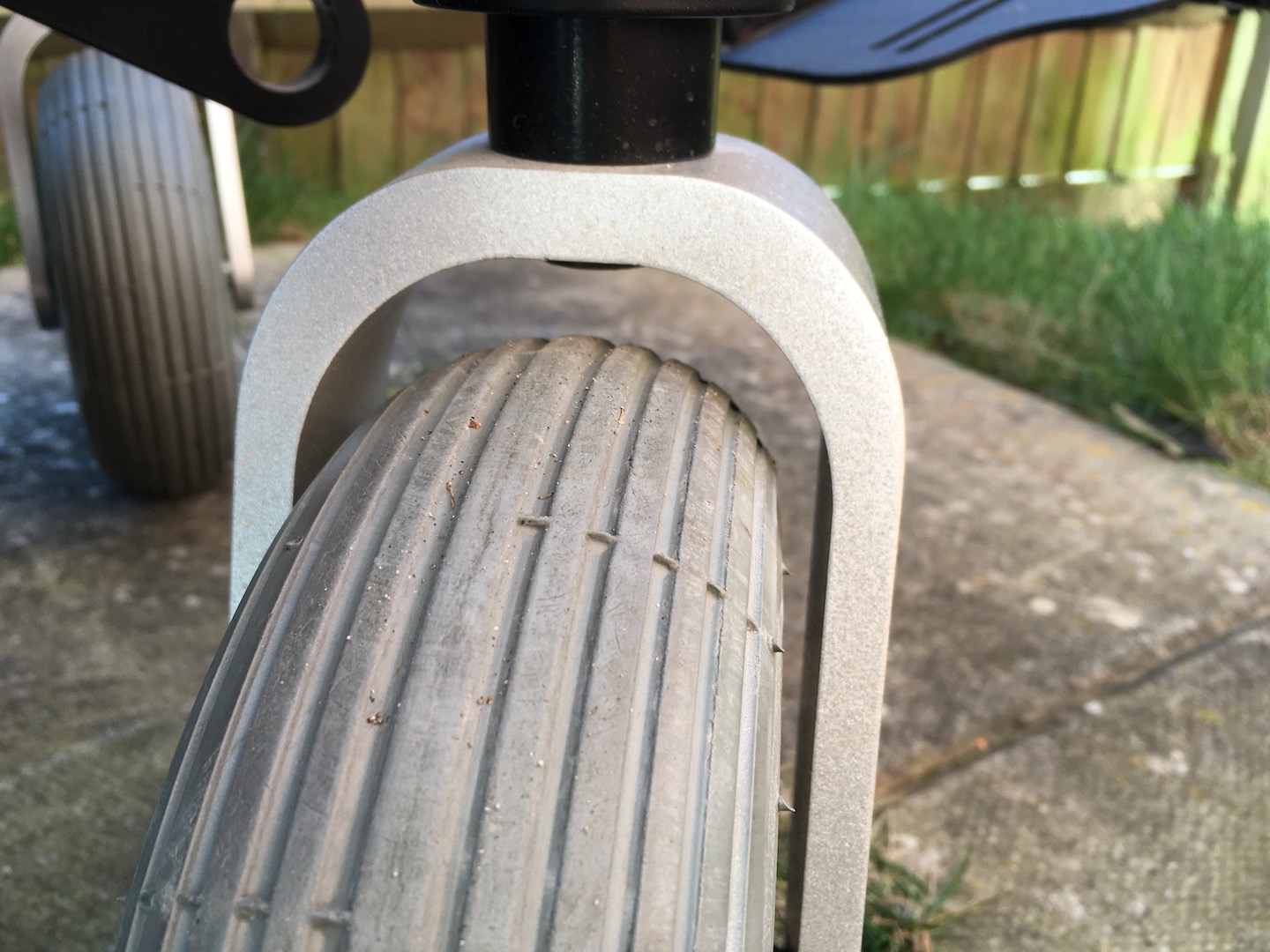

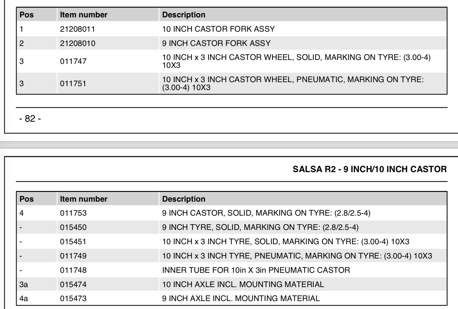

Front tyre selection conundrum, opinions sought!
Deffo go to go for 3.00 x 8 black knobbly tube rear to get chair on road and looking half respectable. Might also go for same rear rim, tyre, spacer, set up as BM, at later date, handy for forest paths, etc.
Front is the problem...
At the moment it's got grey 2.8/2.5-4 which make for a 9" wheel fitted into 9" forks.
BM's chair as well as 14" rear has got 10" front fitted into 10" fork.
But if I fit 14" rear keeping 9" front it will make the arse sit slightly high. Or I could try and squeeze 3.00 x 4 tyres into the 9" forks, but they would be a tight fit, maybe a bit of filing, and might look at bit odd?
So two questions...
1) Odds on squeezing 3.00 x 4 into 9" forks
2) Arse sitting high - is it a problem?

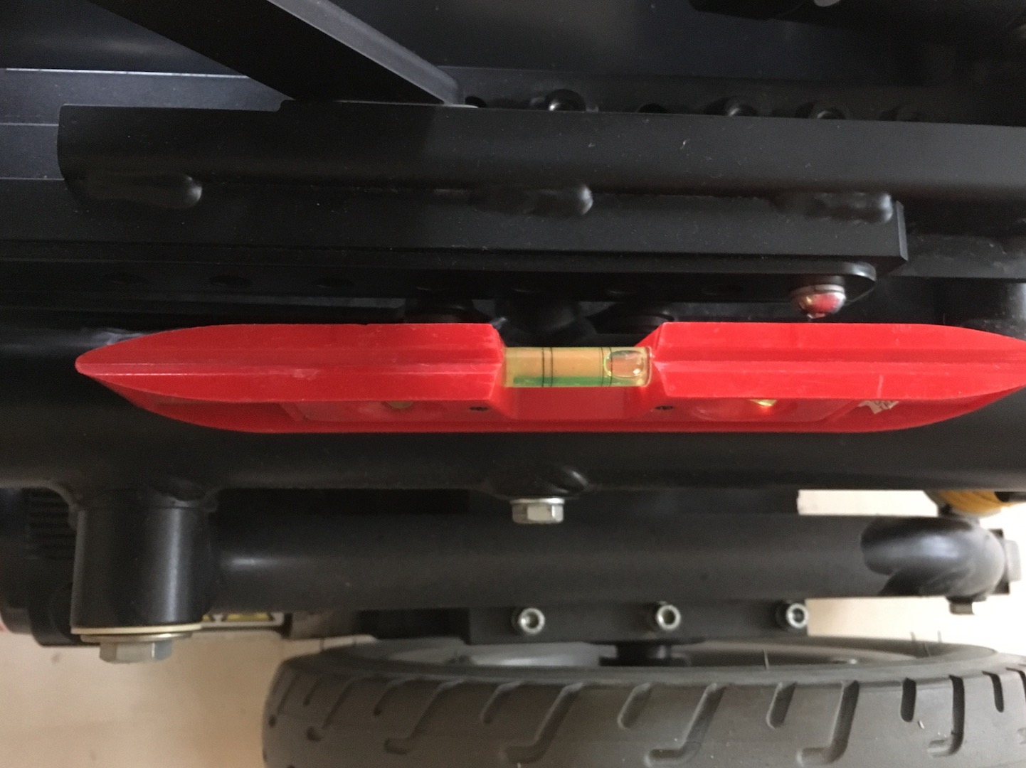

Related to previous question... Front rear incline rolling chassis as it is on 12.5" rear, 9" front.

Postby Burgerman » 24 Mar 2018, 18:37
DUNNO... The tyres I fitted are nominally 3.00 x 4 but measure a little less like 9.5. So get some the same and you should be OK. Black tyres the size you have are hard to find.
SHOULD be no problem. If it is, fit spacer and longer bolt.

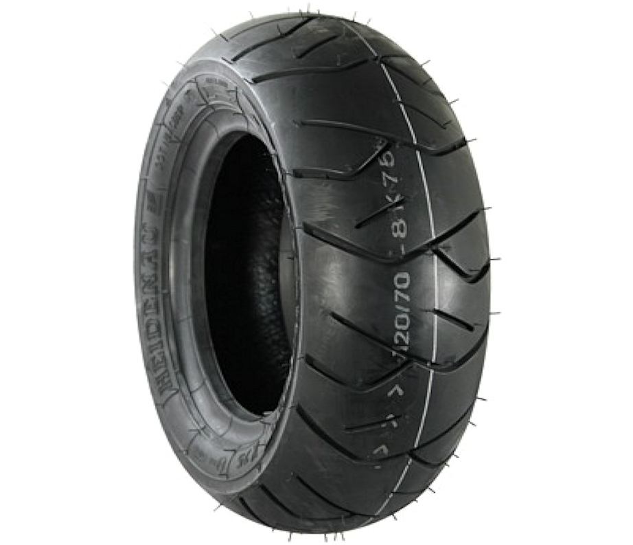

I can send you a set of unused 3.50/8 Heidenou or whatever they are called cheaper than new if you want. But they will look pinched on stock rims. At the moment the rear looks too low if you ask me! Stock tyres look like a pram!
But you really want a set of these, you know you do! See shirly...
Dont mess about, Go big! :thumbup:

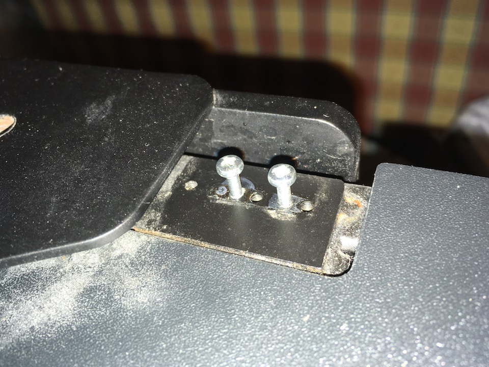

On one of your pics theres a microswitch visible behind the seat. That can be adjusted so you dont see the turtle as soon. And so can tilt back more. But better achieved by altering the seat base angle.
Posts: 70467

[quote="Burgerman"]I can send you a set of unused 3.50/8 Heidenou or whatever they are called cheaper than new if you want. But they will look pinched on stock rims. At the moment the rear looks too low if you ask me! Stock tyres look like a pram!
BIG is BAD for BUS! :fencing
But them 3.50/8 Heidenous are nice, it's just a shame they won't go on shirley's rims... :( I think they'd look silly on my rims.

Burgerman wrote:1) Odds on squeezing 3.00 x 4 into 9" forks
Your dead right, I emailed the dealer the only option was grey. The rear 3.00 x 8 are available in black.
When I was removing seat and backrest I remembered you mentioning that microswitch. :thumbup:

I THINK that that is the one. I may be wrong. But watch it as the seat tilts to see if that one is the correct one. If so some minor mechanical change/adjustment will stop it acting so soon. On the other hand, mine will be disabled in software completely when I get around to doing it. The reson its there is because if you tilt, esp when high up, or on anything but level ground the chair may tip over backwards as you move forwards. Made worse by moving the seat back. So recline, and tilt can be dangerous! Especially if seat is raised. But its common sense to me so I use my brain.

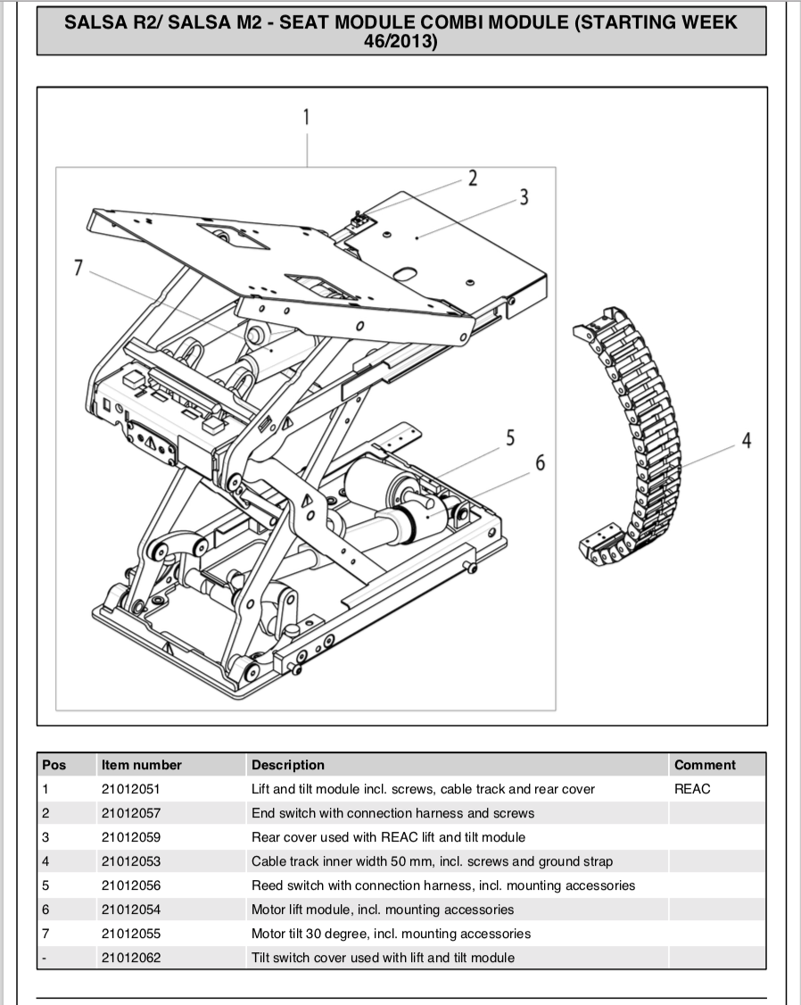

Postby Scooterman » 25 Mar 2018, 02:14

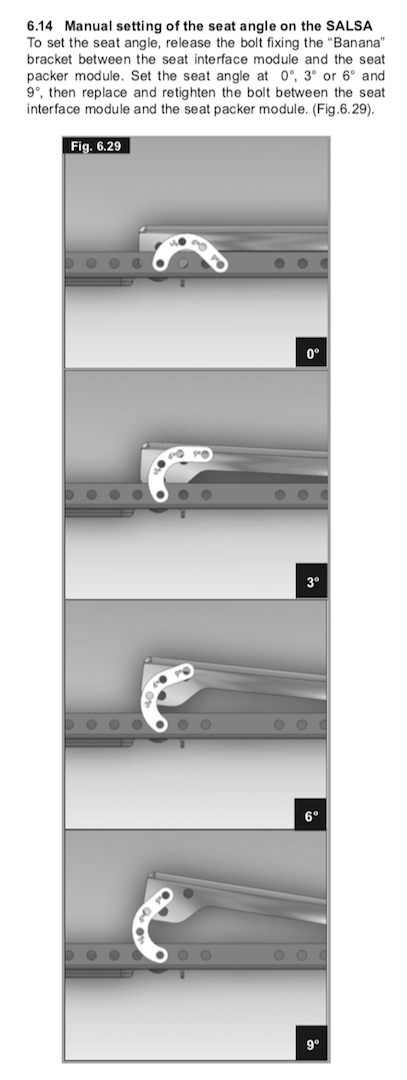

Burgerman wrote:That seat dump is adjustable in 3 far too wide positions. And depending on seating/options in 2 different ways where it connects to the frame. Basically 2 bolts. So I drilled 2 new holes in the correct place...
I've search high and low for what the manual refers to as a banana bracket which supposedly give a range of fixed position seat bucket. I can't see it and the only conclusion i can draw is that the banana bracket is only on the standard non-tilt/elevate seat?
My seat module
With the tilt/elevate module on my chair the only way I can see of adding a bit of fixed position bucket is to raise the front end of the tilt/elevate module by using this lower hole for bolting front of module to frame. Sorry that sounds a bit garbled, and the photo isn't particularly clear but I'm pretty sure it's the case. Any more bucket than that will as you said in an earlier post will have to be set by adjusting the position of the tilt microswitch.
NB: I think your chair being 2018 must be a bit different? Do sunrise manufacture their own salsa tilt/elevate modules or do they buy off-the-shelf?

Burgerman wrote:I THINK that that is the one. I may be wrong. But watch it as the seat tilts to see if that one is the correct one. If so some minor mechanical change/adjustment will stop it acting so soon. On the other hand, mine will be disabled in software completely when I get around to doing it. The reson its there is because if you tilt, esp when high up, or on anything but level ground the chair may tip over backwards as you move forwards. Made worse by moving the seat back. So recline, and tilt can be dangerous! Especially if seat is raised. But its common sense to me so I use my brain.
I think it is the one too, there are four threaded holes
These: https://www.oponeo.co.uk/moto-tyre-details/heidenau-msc1-3-00-4-35-b-front-rear-tt#185979767
Can you point me in the direction of what tubeless valve would fit the Salsa's stock rims? I've never fitted tubeless before and don't know if the valve has to matched to the rim?

Postby Burgerman » 25 Mar 2018, 02:37
Theres no banana bracket with a seat riser module. Th other bracket you saw is it.
But it has 3 holes. Too flat. Too steep. Really too steep. I drilled another! -In between too flat and too steep.
But you may also need to drill the two rails with holes as the lift mechanism may foul the freame at the rear when you raise the front edge. Mine did.
Posts: 70467

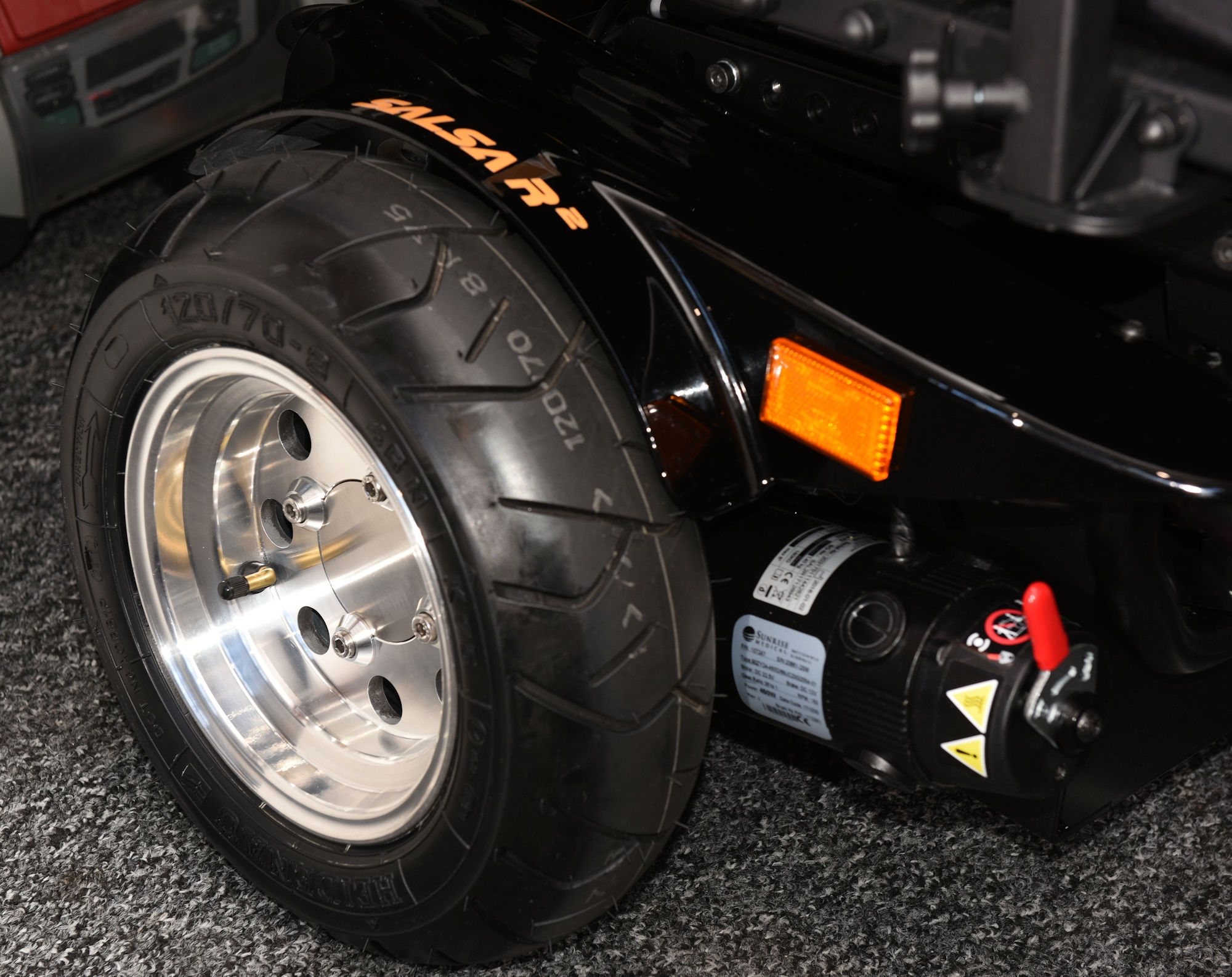

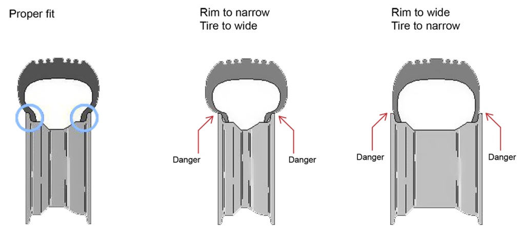

Just so I'm clear my mind...
Illustration 1. 120/70 - 8 on Shirley's 3.50 x 8 rim.
Illustration 2. 3.50 x 8 on Salsa rim.
Illustration 3. 3.50 x 8 on Shirley's 3.50 x 8 rim.
Illustration 3 the reason why I can't put 3.50 x 8 Heidenau K75s on Shirley's 3.50 x 8 rims?
