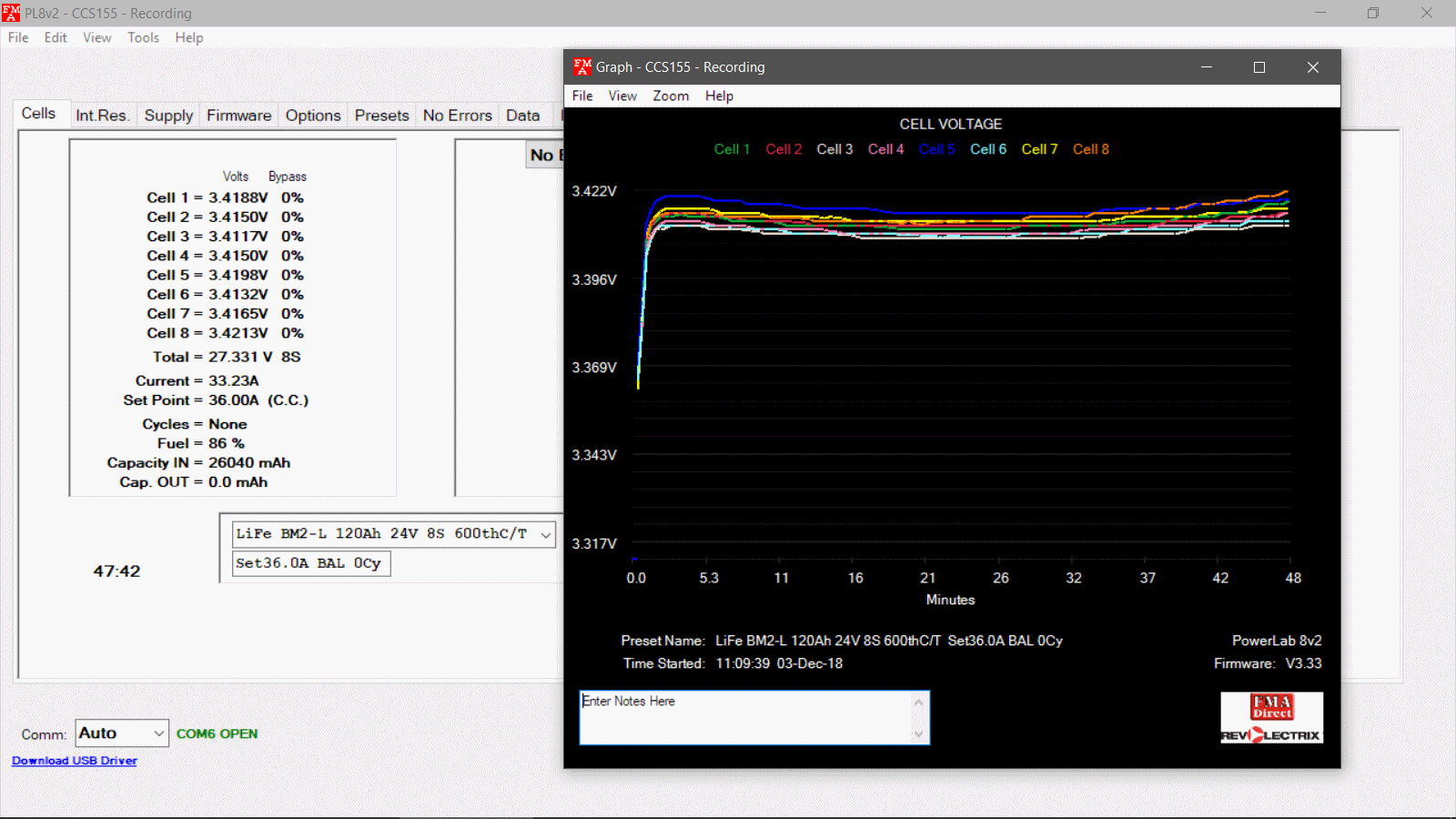

Heres why we cant just let it balance from 3.400V instead. If you start balance early, it does the opposite! There are times when the highest cells, are the least charged. And there are times when adding power to a cell REDUCES voltage. And the opposite is true. So trying to balance at these ties actually unbalances the cells. For e.g. trying to balance during the first part of this charge, would unbalance the battery. Heres 2 graphs.
Charging my BM2 chair. 120Ah pack. Note that as we charge the voltage begins by FALLING. And so adding power REDUCED votage. So trying to balance would take power from the higher volt cells (the least charged!) and put it into the lowest cells (which are falling in volts as we charge.
For E.G. we would have added power to the ORANGE trace. Which actually is already the most full cell. If we have patience and wait a while for the charge to continue. So that would have resulted in a buch of cells that were now unbalanced at the top...
Orange trace is low. (but really its the most full cell in Ah.) This is caused by internal resistance differences due to the cold battery. As it warms up, the resistance drops, so the voltage on charge is pulled up less by the charger.
Initially voltage falls as resistance drops. Note the ORANGE CELL 4 trace.
Then as resistance has dropped, and the battery begins charging properly 45 mins later that ORANGE trace is now the highest... And we would have pulled all the others down further had we been trying to balance at this voltage. Thats why balancing must only happen at or near the top CV voltage only.
Posts: 70487
Postby Burgerman » 03 Dec 2018, 13:21
And after 1 hour the BLUE cell, that was the highest, and would have been discharged at the 1A balance current, for an hour would be a huge 1Ah less charged than the rest. But it WASNT the fullest cell. It is in fact the lowest one. But it was also the coldest.
So as you can see here, the orange one is leaping ahead (it was 2nd lowest for 20 mins).
And the BLUE cells were the highest, and now they are not... And thats WITH NO BALANCE current at all.
Posts: 70487
Postby Burgerman » 03 Dec 2018, 13:36
And at 1 hour 20 mins, it becomes very clear that the orange and green cells were the most charged. And so any attempt at balancing these cells before about 3.45V would have made this situation worse.
Posts: 70487
