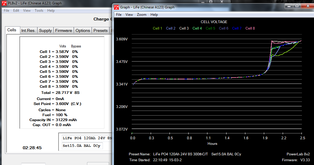

Postby terry2 » 14 Mar 2019, 20:41
Burgerman wrote:Scooterman, how do you get all those cells to stick upside down and the laptop too? :worship :eh:
Terry, yes it looks balanced and well full.
Now choose discharge, for 2 to 3 hours. And post a screenshot.
All cells should be very close like a single line almost.
Then choose recharge, and they should all be almost completely balanced straight away as soon as the charging finishes.
And another screenshot.

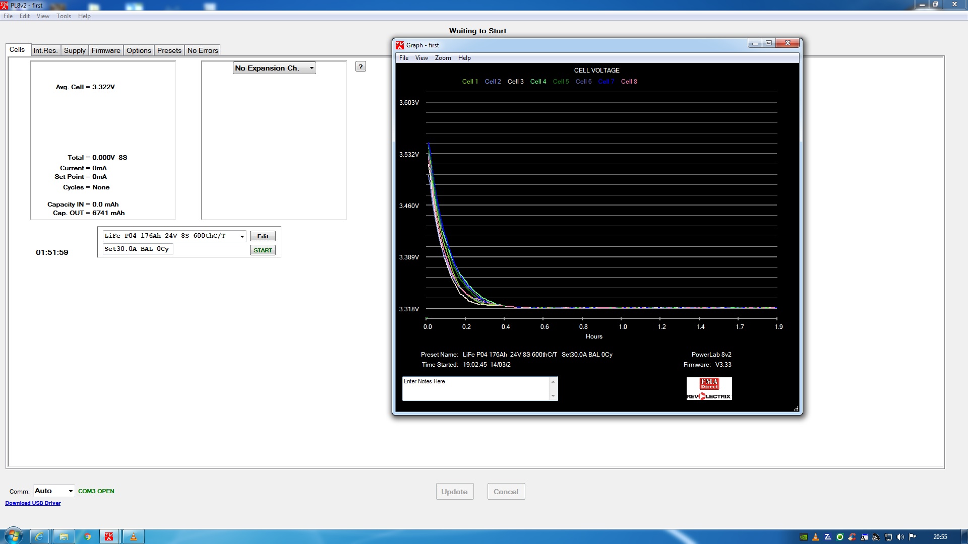

Discharging now.
All the cells are 3.318v as I have been discharging for 40 mins.

Postby terry2 » 14 Mar 2019, 21:57
I had to stop discharging as it's my meds time.
All the cells was 3.318v after 40 mins

Postby terry2 » 15 Mar 2019, 08:39
Here is a pic of the re-charge of my pack.

Before your meds you discharged your pack by about 6.5Ah (a tiny percentage of 176Ah pack).
Then this morning you put back in about 7Ah (another tiny percentage).
IMHO it doesn't really demonstrate much apart from your cells re-balance again at 3.6v after a tiny discharge.
If I was you, I would discharge the pack a bit, then dismantle it and re-assemble it in your chair. If it won't take long (i.e. a few days) to install the pack in your chair then leave the pack as it is, i.e. fully charged. If you won't be installing the pack for many weeks then discharge it a bit. About 50% is good for long term storage (months) but you obviously won't take that long to install it. You're not a slowcoach like me! :oops:
But as I've said numerous times before I'm just starting out with lithium so am not that sure of my ground :problem:
But everything you've done looks good to me :thumbup:

It was discharging for just under 2 hours.
I will do 3 hours now. I will be using BMs profile which works and is safe :)
The pack is built and wont be coming apart again until it dies.
After more testing and BM says it's good to go. I will clean up all contacts using IPA Isopropyl.

Postby Burgerman » 15 Mar 2019, 09:53
Just 1 hour is enough. To see if that gap dissapears. If not you have a dirty connection somewhere. When you clean dont use IPA use a that green scotchbright cloth. On connector and on terminal. The connectors are not crimped are they ?? :fencing Soldered hopefully or theres the issue.
Probably be perfect next charge regardless. Cell 4 seems to think its full faster. And has the lowest loaded voltage. So I suspect dirty connection on cell 3 4 or 5.
