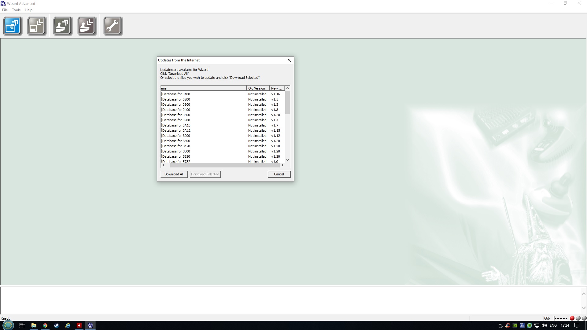

Re: DWIZ-ADAPT
Postby Burgerman » 18 Jun 2019, 17:20
Well strangely mine just says up to date... Screenshot.
And always has...
But all they are is a bunch of settings files. So not really needed unless you lost your own and dont want to start from scratch.
Note the weed burner dropped on the drive! Thats where everything I use ends up.
