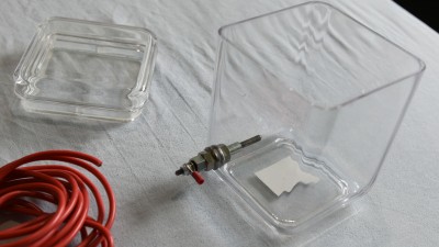

Postby Burgerman » 04 Jul 2019, 22:30
The best bit is that the green stuff needs to be warm to give a good shiny finish. So I am told, although it seems OK at 30C here). And thats the diesel engine glow plug I fitted as a heater... Works great!
Wasnt going to post it anywhere. But expresso wanted to know why you need an adjustable power supply. Because you never know when you want to nickel plate your copper money. This needs 2. One set to 10V to heat the thing, one set to 3V for plating. :clap Anyway I will leave this now as this is your build thread!
