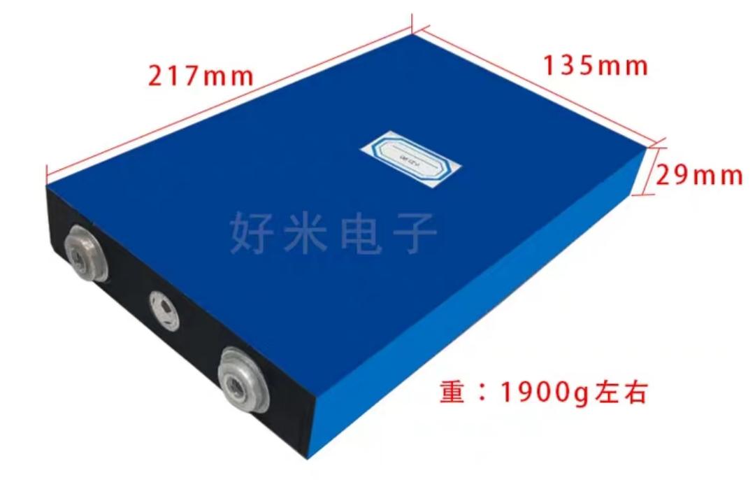

By any chance has or have you or anyone ever came across or found an Battery Cell solution to fit a group 22 NF size ?
any links to possible Cells ? i am looking to help someone who has this size battery.
Postby shirley_hkg » 03 Jul 2019, 07:38
Easy to fit 16 of this 60Ah cells , 120Ah @24V.

shirley_hkg wrote: Easy to fit 16 of this 60Ah cells , 120Ah @24V.
thanks Shirley they look good - would you have a link to them ?
