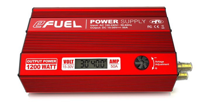

Postby steves1977uk » 15 Jul 2019, 20:24
terry2 wrote:
Burgerman wrote:Whats the max current of the power supply?
Set the PL8 to less in the SUPPLY tab.
It's a Efuel 1200w 30 amp.
I will try what you said and report back.
Are you sure it's 30A Terry? My EFUEL PSU is 50A@24v. Do you have another PSU to test with?
Postby terry2 » 15 Jul 2019, 21:13
steves1977uk wrote:
Yes it's a 30AMP 1200W.
The power supply comes on OK if I don't connect the PL8.
As soon as I connect the PL8 I get and error.
It was working great. Then the LCD on the PL8 went off. Look likes it's dead.
Wonder if there is a fuse in side?

Postby steves1977uk » 15 Jul 2019, 21:59
Is this the power supply you have Terry?
If it's blowing it's internal fuse, then there's a possibility it has developed a fault. In which case it's better to buy a Shirley ZXD2400 PSU which is better quality.
