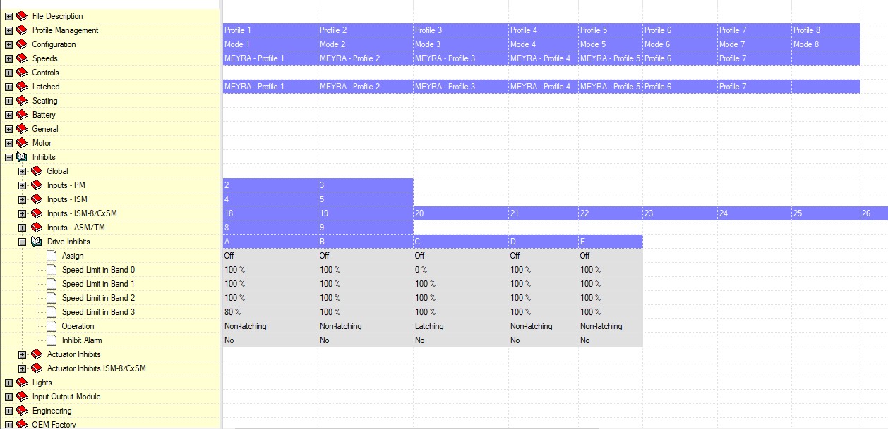

Yes it is just a case of setting the two inhibit settings to off Inhibits - Drive - profile 1 and 3

Can you post a picture of what you change please?
Re: Meyra optimus 2 a small review
Postby rickystyx » 10 Nov 2020, 11:11
Here it is - and a copy of the file with it already done for you
Updated Terrys with inhibits removed.R-net

rickystyx wrote:Here it is - and a copy of the file with it already done for you
Thanks dude.
