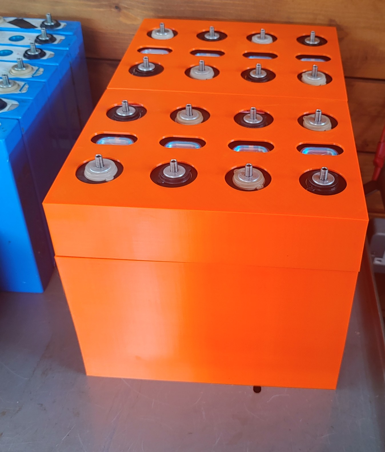

Postby ICEUK » 31 May 2021, 12:50
Here is a image of my 3d printed battery box

Postby Gnomatic » 31 May 2021, 15:26
That's awesome!!! :clap
What are the outside dimensions of your box?

Postby expresso » 31 May 2021, 16:17
very nice perfect fit -
Postby ICEUK » 31 May 2021, 20:59
My dimensions are
179 wide, 234 length. 208 high
I had my battery compartment enlarged by 40mm

Postby Gnomatic » 31 May 2021, 21:52
I don't have that option with my chair, but I'm glad it was for you. Again, great job!

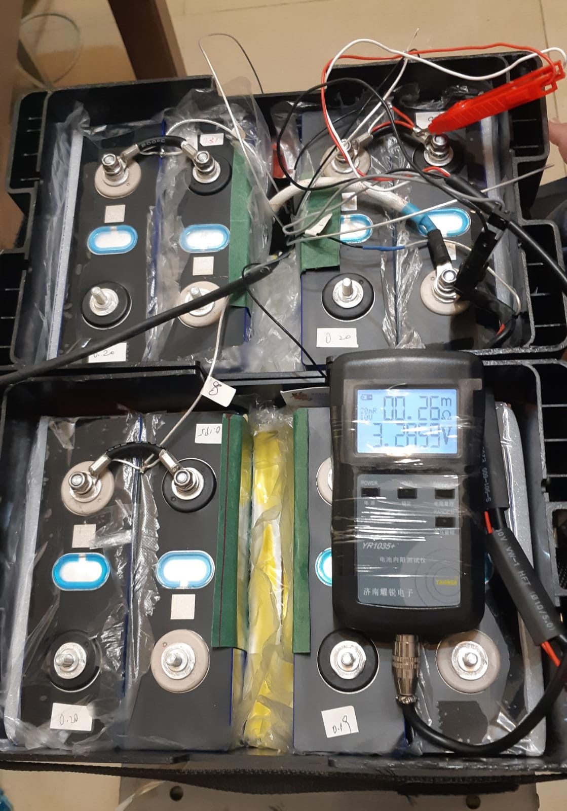

Putting 8 X 230Ah cells into pair of original battery boxes of an INVACARE .

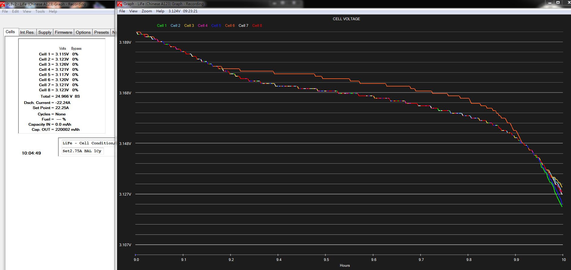

Postby shirley_hkg » 13 Aug 2021, 03:36
Just passed my threshold , still going .
Posts: 4483
Postby Burgerman » 13 Aug 2021, 04:06
220 Ah. Whats going on with cell 6? Has it been working out? This is why having a stupid bms that balances all the time would UNBALANCE your pack severely. Some do this and think they are doing a marvelous job!

Postby shirley_hkg » 13 Aug 2021, 04:24
It's the last hour shot I zoom in for details .
This is the first run , and #6 might have been kept at high volts longer than the others , during balancing.
