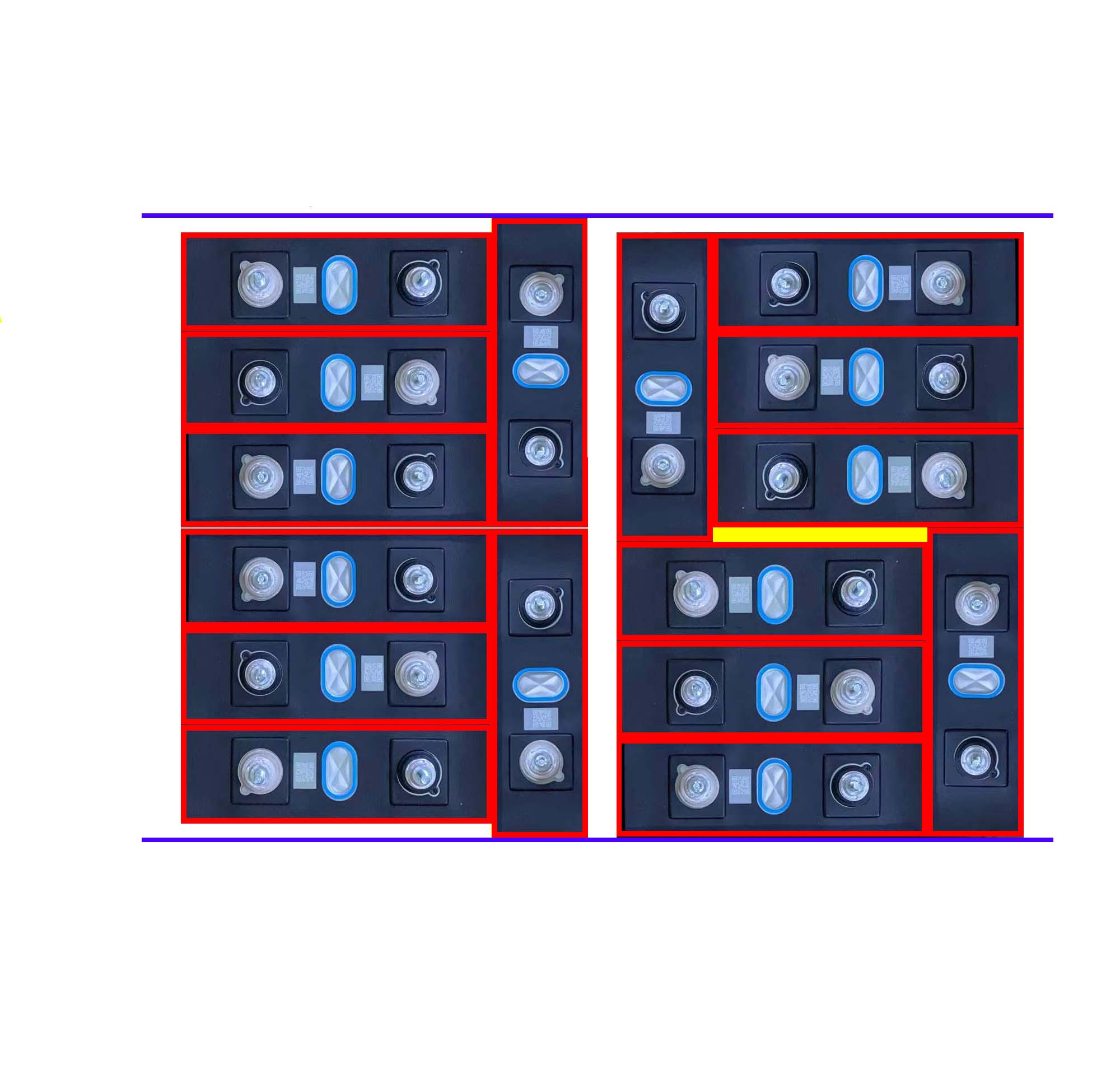

I think I'm going to have to cut a notch out of my battery box to get a few mm for the 2 cells going long ways. The 6 in a row will fit but the other 2 are slightly to long.
Any tips on how to seal my battery box after I cut a notch, maybe sheet of thermo plastic sheet? Reinforced black tape?
Here's a pic so you can see the 2 cells that are longways I only need to cut a 54mm wide notch to accommodate the length of the one cell

I've come to far and spent to much $ to give up now. My main concern is fitting the pack in my battery box I may need to cut a 54mm wide cut out in the back of battery box to accommodate the couple mm the cell going longways sticks out
But I could use some ideas on sealing the battery box after cutting the 54mm wide piece?

Postby foghornleghorn » 04 Feb 2022, 18:03
Why are you not building a rectangle with a hole in the centre?
Would reduce the length. See image.
Posts: 710
Postby fishinjunky » 04 Feb 2022, 19:11
foghornleghorn wrote:Why are you not building a rectangle with a hole in the centre?
Thanks that would give me just enough to fit right now I'm at 13.7" and I need to be at 13.1"
Looks like I'll be untapping an taping again banghead

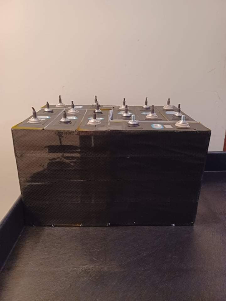

Postby fishinjunky » 05 Feb 2022, 17:18
Just took out the super heavy lead bricks an test fitted the cells :din the battery box an they fit perfectly :dance :dance :joint cheers I'm so HAPPY!!!

Postby fishinjunky » 07 Feb 2022, 18:29
Got the 8 x 200ah pack put back together
Posts: 1101

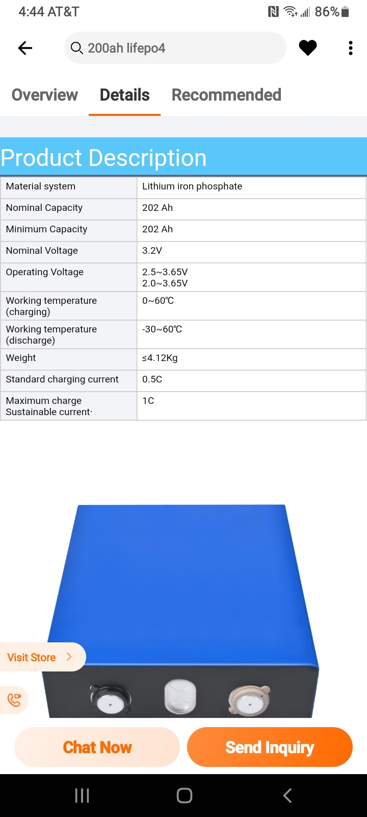

I'm charging each cell individually, I'm charging the first cell, at 15 Amps is shows 3.64v if I increase the amps over 15 amps it makes the voltage spike up to 3.8v. The balance lead shows 3.3v. Does that mean this cell can only take 15 amps?
Here is the specs
Posts: 1101
Postby Burgerman » 18 Feb 2022, 02:18
If I set the PL8 to 3.600V then charge at 40A as soon as it goes over 3.600V it throttles back the amps and the current gradually tails off to almost zero.
Here is the specs
So what you have written makes no sense to me. The charger is supposed to LIMIT its output to whatever CV voltage you have set. So I have no idea what it is you are reading or looking at. Or if the charger is doing as its supposed to be doing!
If the balance lead shows (read by charger or voltmeter??) then I have no idea why you see more somewhere else? On the charger??? And if thats the case then your charge lead has a bad connection.
Posts: 71100
