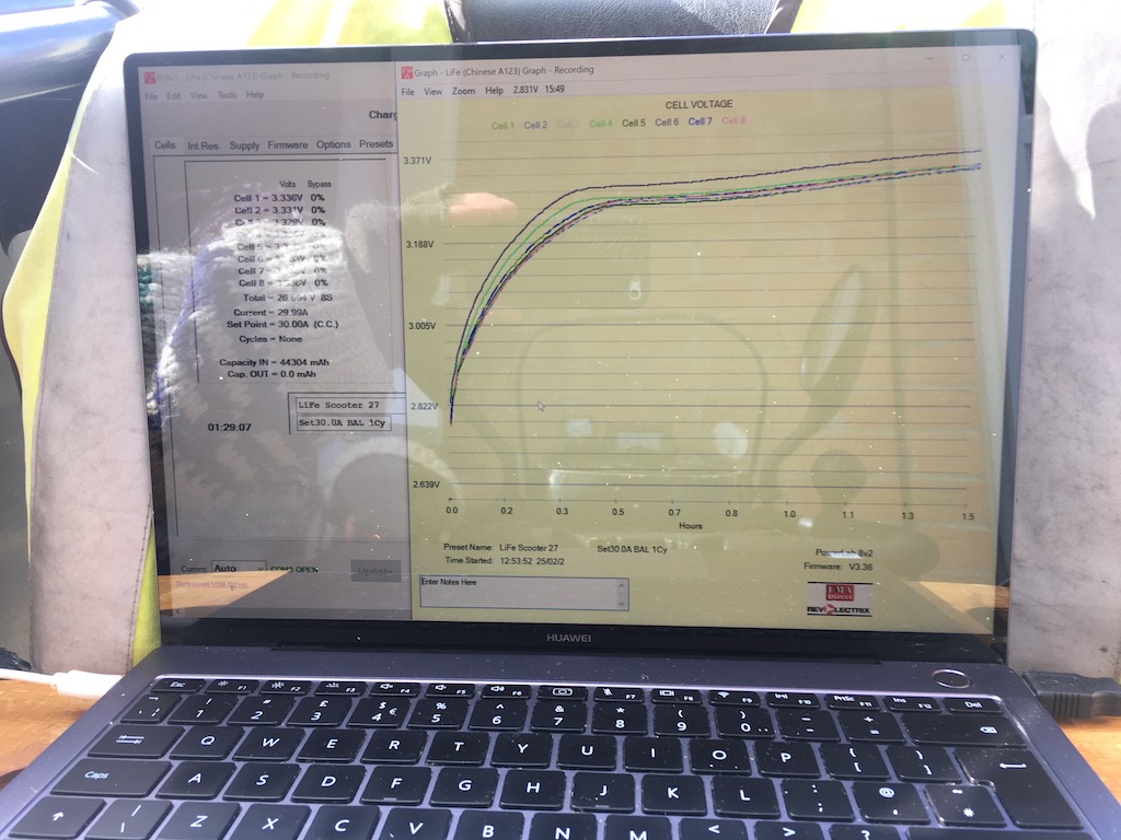

Postby Scooterman » 25 Feb 2022, 14:05
Well they're charging which is good.
Just have to see how it goes cheers

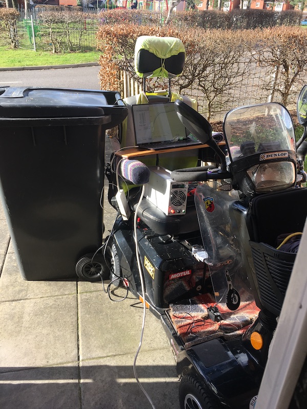

Postby Scooterman » 25 Feb 2022, 15:40
Still going, fingers crossed :|
I've come indoors and just seen your update Shirley.
I've got them charging at 30A, I'll take a chance and leave them.
If I reduce it to 10A they'll take too long cos I'm charging them on the scooter outdoors and can't leave my laptop outside when it gets dark. Some b'stard will nick it! :ak47 (steal it)
Postby Scooterman » 25 Feb 2022, 15:49
Postby Burgerman » 25 Feb 2022, 17:08
That looks promising. Cant really have been at 1v?

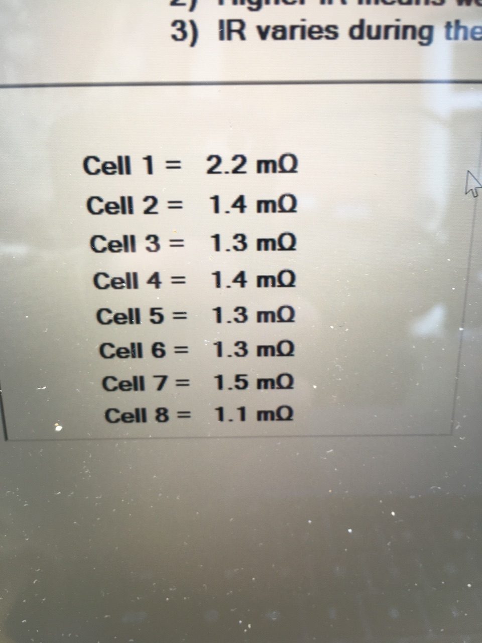

Postby Scooterman » 26 Feb 2022, 12:44
Burgerman wrote:That looks promising. Cant really have been at 1v?
Hi BM, yes they were you can see in previous photo here:
Yesterday I they took 182Ah and the IR readings was good. But they took a long time to balance and when they all finally came together the charge terminated early at about 2.5A? I don’t know why, but it late (9pm) and dark and I was knacked, and had had enough so I took a couple of amps out of the pack to pull the voltage down and packed up. I’m going to finish charging them again today at 10A and see if they come together again and stay together for 30 mins or so (horizontal wiggly line) and terminate at set TC.
