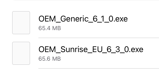

Postby Scooterman » 14 May 2022, 07:36
Just a quickie, I hope it’s not a dummie :fencing
For a sunrise chair I’d use the sunrise version, yes?
You obviously have to read from controller before being able to alter chair’s parameters, so what difference does it make which software version you use?
:problem:
Could it be that some makes of chairs have non-standard configuration, such as perhaps 4 motors or something?
Posts: 2892
Re: R-net dealer dongle not communicating with PC software
Postby Burgerman » 14 May 2022, 08:54
Use Sunrise but version 6.4.
You would just change motor load compensation if 4 motors are used.
The only reason that theres a sunrise version, rather than just use generic is because they use the CxSM module esp programmed to suite the fancy seating on the ERGO seat powerchairs. That cost twice as much...
The generic one will not adjust this. It will do almost everything else fine. Inc all the normal seating options on say my salsa or Q700R. And the same on other chairs.
The outlier is permobil. And then who knows what works.

Sorry to be a nuisance again.
But how exactly does the dealer dongle workaround work?
I’d previously borrowed an OEM dongle and saved the settings to file. So I can open the OEM file with software, alter settings, and write to chair with dealer dongle.
But for a new chair (or controller), the dealer dongle only reads the dealer settings?
How do you get it to read the OEM settings? :eh:
Posts: 2892
Postby Burgerman » 17 May 2022, 08:39
READ THIS... https://www.wheelchairdriver.com/board/ ... f=2&t=8035 before trying to set up your chair.
Now, when you use your dealer level dongle, dealer software and save a settings file to your desktop, that file is marked as DEALER access only.
If you now use the OEM software and then open that dealer file, it is still dealer restricted. You cannot edit OEM stuff. If you now SAVE it with a new name to your desktop it then becomes an OEM level file.
Now, re-open the OEM software, and use that to re-open that new file and you can edit all the OEM stuff and re-save to the desktop.
Now use the DEALER software and DEALER dongle to write that changed file to the chair complete...
