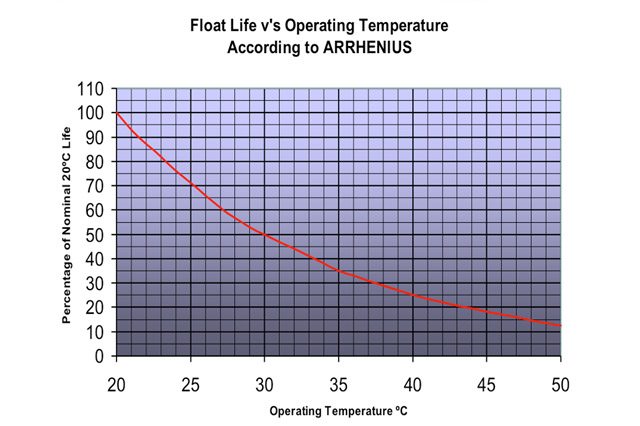

This might depress you...
If your battery, with a nominal 10 year float life, is seeing 50c in summer then it will last about 14 months. I keep mine cool. I keep hobby batteries in the fridge.

Postby wes4dbt » 11 Nov 2024, 23:54
I guess I was luck to get 3yrs. That is depressing because I really don't have any space in my house for the chair.

Postby Burgerman » 12 Nov 2024, 00:08
You got a few years because its not 50c all the time. And because long after it reached the 80% capacity point (end of useful life), you keep on using it.

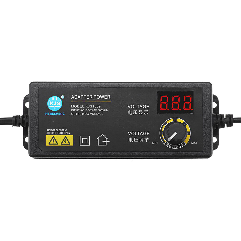

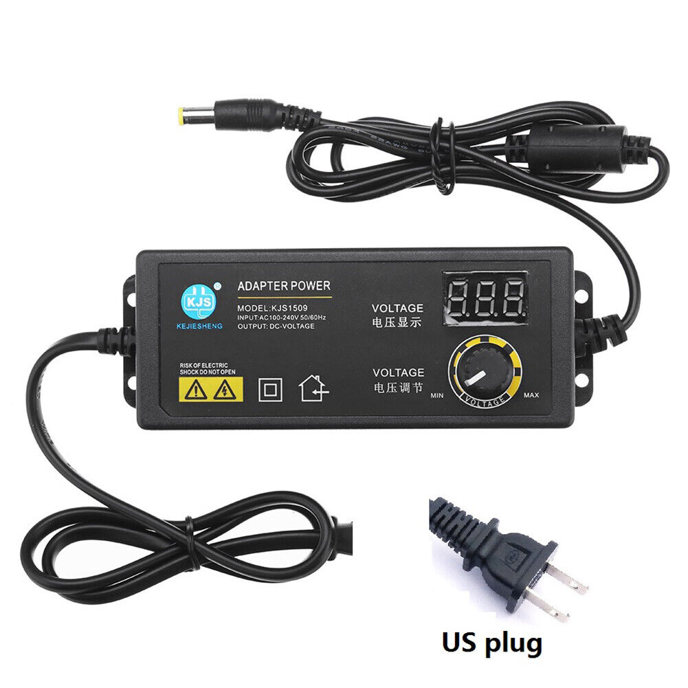

For storage you can use one of these. Set to say 13.5V in winter. 13.2V summer. For long safe storage. For a single battery or your van. (TWICE THAT if in a chair in series obviously)
https://www.ebay.co.uk/itm/405108313343
3 to 36V output, 100 to 240V ac input regulated DC out. 2Amps, 60W max 95% efficient.
£10
Fit XLR for whelchair and AC connector of your own country.

Burgerman wrote:For storage you can use one of these. Set to say 13.5V in winter. 13.2V summer. For long safe storage. For a single battery or your van. (TWICE THAT if in a chair in series obviously)
£10
You think something like that will do a better job than my Victron set at those voltages?

Postby Burgerman » 12 Nov 2024, 20:09
They dont know what you will use it for so its not going to have an XLR...
But those take 1 minute to add, cost a couple of dollars.
Will it work better than a victron? Not as a charger. Too weedy and 1 stage... But as a device to hold your battery at the voltage you decide then yes! And in storage thats all you need.
I have one similar from years ago, connected to my van over winter. It is in the house, long extention cable goes to the van with an anderson connector. It holds my vans battery at 13.35V most of the time.
In hottest part of the year I drop that to 13.1V. In COLDEST winter I increase to 13.5V
It just does what you tell it without going off on its own and doing aomething like restart charge or recondition... You cant tell what those victrons are going to do! And it takes very little power, and it gives YOU control over long term storage.
I set to 27.4V and top up a few chairs for 24 hours that are sat unused in the house every 2 weeks too. As well as a string of old batteries in parallel at 13.7V.
A useful gadget for pennies. Add a Anderson, an XLR, and a you get a choice.
Will it charge a dead battery? Yes. If you have till about xmas...
