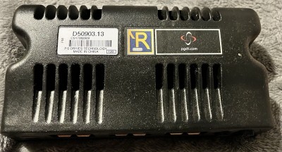

Postby Pierro » 07 May 2025, 12:23
The Optimus2 - 15 km/h version has a 4-pole motor with two connectors for the power module. The photo shows connectors 2 and 4.
@BM, could that be for forward and reverse? I don't understand.
Actually, it's a completely normal 120A power module. This one is mine:
Could I simply replace it with another used 120A PM if I then copy my driving program onto it?
My dream: drive a self-made power chair with a lot of power and high speed. For infinite range.
Pierro
Posts: 98
Joined: 06 Nov 2014, 12:37
Location: Germany
Re: meyra optimus shopping
Postby Burgerman » 07 May 2025, 14:08
No because it ISNT a standard R-Net part. It is a single channel 220A module running very different firmware designed for myra and their servo controlled steering setup. And you cannot copy your settings to it.
A 120A R-net standard module as uses in a powerchair is completely different thing. Yes they might LOOK the same...
The clue is that yours says 220 on it... All 6 of mine say 120 (120A per channel)
Yours is a single channel unit, with both channels elctrically working as 1 channel. Wiith very basic back/forward scooter power capability.
Same applies to the module they use to do that servo steering. The same casings are used. So they look similar... They are not.
The only one of the 3 modules that might work would be the 6 channel seating module.

Thanks BM we have made contact.
I took a leaf out of your book awhile ago and brought up Power modules, seating modules, etc including meyra stuff. As you point out it's surprising what you can get inexpensively if you keep looking. Oh my
