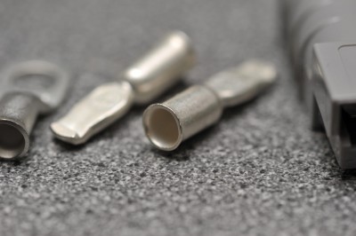

A picture is worth a 1000 words.
Almost every anderson gets sent out with soft cheap thin walled pins. These take bigger cables like 16sqmm. Or 6AWG or whaever. And no matter what you crimp them with they are weak. And I will pull them off.
And after a bit of salty winter road water or a few humid days they will oxydise and get problematic in some cases in the future.
If you can bend it by tapping with a hammer they are way too weak to crimp properly.
If your look like these, thin walls, solder them!
Then they are then fine permanantly.
If you really want to crimp in a way that is actually secure and will exclude oxygen, water and so corrosion from where it matters then you need some that look like this. Cast, heavy wall. I have a tray of them from ebay.
These are for 6 sqmm cable. You can almost fit 10 sqmm
Even after drilling a fraction bigger for 10 sqmm for a good accurate wire fit, as big as we will ever need on a chair, theres a still lot of meat still in them. You need a good hydraulic crimper as these are hard and once crimped these are never coming off! On that pull test, the cable snaps first.
