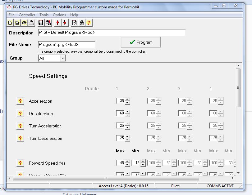

Postby brax » 13 Apr 2012, 19:25
Woody
your lead hooked right up and i got comms active!!!!!!!
I still have permobile dealer version installed and have to uninstall and reinstall oem version.
That is the file uploaded from my machine. Look at the Forward speed max setting and you will see why i've been so frustrated with this thing.
I have NO IDEA why my lead works in England but not in the US and yours works in both. :D Something about that lead my chair didn't like. I think we should make voltage level measurements on both leads later when we have free time.
For now i'm gonna reprogram this pile of scrap metal, so that i can at least have some hope when i'm trying to get away from the mormon missionaries preaching to me as i slowly crawl down the street.
I'll be running the wheels off of this thing shortly.

Postby brax » 13 Apr 2012, 20:55
I made some quick changes with just the dealer software, I'm twice as fast as i was!!!!
I'm going to go through BM's page and change things with a oem copy. I'm going to wait until tomorrow as i was up all night with a sick 3yr old. I need some sleep
I was headed that way when woody's lead arrived and i had to plug it in first. I got so excited when it worked i had to stay awake for a while and make at least some changes.
