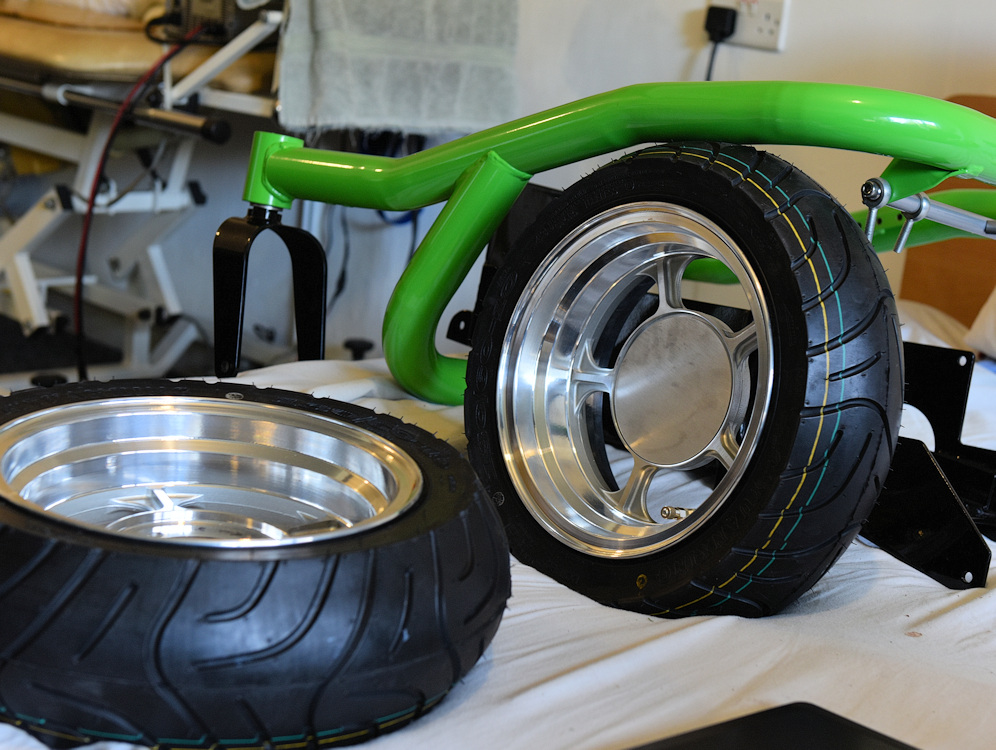

Postby Burgerman » 21 Oct 2015, 13:43
This is what my bed looks like today...
Posts: 70452
Re: Rebuild BM2 green...
Postby Burgerman » 21 Oct 2015, 13:45
Another... Making wheel adapters with a pointed bolt, 3 G cramps, some 120mm x 8mm alloy laser cut discs, and the olde worlde taperlocks from the BM2 before I pulled it apart!
Posts: 70452
Postby Burgerman » 21 Oct 2015, 13:46
This is just propped in place. Frame will miss the wheel by 10mm when fitted properly. And centre disk will have 4x M8 countersunk bolts, and be polished like a mirror...
Postby Burgerman » 21 Oct 2015, 17:53
Several reasons.
When rebuilding a BM2 that has survived hell and 3 previous rebuilds I decided to make a cheap chair that looks cool for going to the pub or whatever if needed. But mostly as spare chair. A cheap rebuild. All old 100A controller etc. But built for reliability, daft range, and looking cool.
So I went kawasaki green because I like the colour, low profile tubeless but very wide tyres because the alloys look cool the rims are light and tubeless, and because I wanted a larger rolling radius to give an easy ride. Easier to roll too for distance, (6 ply, strong tyre, bigger diameter, tubeless but still curved slightly even though its fitted to a too wide rim, so less power wasted on turning etc). And I want huge range so it is getting a 120Ah 8S headway 25.6v battery. Mostly because I cant bring myself to buy another hopeless lead brick... Its just wasted.
Total rebuild from scratch with lithium (almost 4x bigger range than lead) and new upholstery, tyres, bearings, loom, footplate, wheels, tyres, puncture fluid, bolts, motors, etc is approx:
Postby Burgerman » 21 Oct 2015, 20:27
The turf tyres are wide.
They can run at 5psi and give lots of comfort, floatation, and so on, and they eat batteries mostly while turning left/right indoors fast. Outdoors, mostly in straight lines like footpaths its not a problem. Esp if you have the pressures at a higher level. Swings and roundabouts...
The tyres I have now, are bigger diameter by about 2 inches. So you could try those - depending on how you built your chair. They will eat less battery power, and should offer reasonable comfort, but ride height will increase. Again I don't really know until I try it! Maybe too big, maybe horrid ride... Dunno yet! I like experimenting. Its why I have 4 chairs...
You MAY be better off with some wider 8 inch rims with say 130/70 8 tyres. Its more "normal", and had more sidewall.
Postby Burgerman » 21 Oct 2015, 22:41
DURO TUBELESS 120/70 8 on a 3.5 wide inch rim should be about right...
http://www.shirebikes.co.uk/products/12 ... eless-tyre
Posts: 70452
Postby hank » 22 Oct 2015, 09:18
Cheers for link. ;)
Postby Burgerman » 22 Oct 2015, 09:39
Fitted on 3.5 rim. 4may be better, will stretch it out. Problem is finding a tubeless rim.

Postby Burgerman » 26 Oct 2015, 15:45
Wheel adapter plates, are:
120mm by 8mm thick laser cut alloy disks. (online).
These are bolted to the old BM2 taperlock pulley adapter designed for the quad bike rims... So an adapter on an adapter!
These are to be drilled with 4x M8 threaded holes for the wheel bolts.
This was drilled by measuring, by hand, in my vice and countersunk on my bed!

Postby Burgerman » 26 Oct 2015, 16:23
But actual bolts used here will be high tensile ones, greased so they dont corrode. Because there are just 3 and high tensile are stronger. And I had some the right length!
These parts will be disassembled, countersunk by another 1mm, tidied up, painted/polished etc as required, and will never be seen! Covered by the wheel. Spacers are alloy ebay skateboard wheel spacers.
