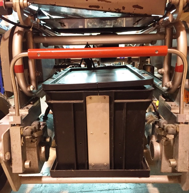

Postby nealnlx » 27 Nov 2015, 20:05
After a week of waiting just to know some dimension i finally have half of what i asked for, but thats tytical...if you want it properly done do it your self, right?...
So the news are...
The box is: 20cm width x 36cm long x 20cm height
That is a bummer to start with, but lets see...
The good part is its height that i thought would be just around 16cm and its 20 with the possibility to go up maybe a finger or two
The worst part is its width. I thought it would be around 30cm and its much less...
The guy said that maybe i can have some room left, like 10cm from side to side untill it reaches the motors. From what i can see in the pics, i think maybe 5 or 6cm is more realistic.
In the and and with it all touching all sides i will try to see if i can gain enough to squeez in a two rows of cells instead of just one in the midle to make it better.
How much space do you guys think two cells of headways 10ah need to fit side by side?
I refer the 10ah ones just because they are the smaller ones and that would be more menagable to put more inside.
Here is a pic of it back view
nealnlx
Posts: 41
Joined: 22 Nov 2015, 19:24
Postby Burgerman » 27 Nov 2015, 21:44
Well a 12A one is 174 x 40 x 40.
A 10Ah one will therefore be the same but 20mm shorter.
So 154 x 40 x 40.
So 2 will be 80 x 40 x 154...
Posts: 71086

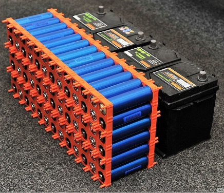

Postby nealnlx » 27 Nov 2015, 22:16
When i said two rows i meant like two packs, one on the side of the other.
Like the pic bellow show, buts instead of the led would be another pack/row of cells
In terms of each pack it self and to menage to fill all the space, i was thinkin...since i have 20cm of height it could get 5 cells upwards making to the top of the 20cm. And with 36cm length can get 9 cells.
So 4x5=20cm and 4x9=36cm
If the 10ah ones have 15cm long i would need a box with 30cm width to fill in those to packs/rows of 5x9cells.
One on the right and the other on the left.
Do you think tha this way it might short due to its proximity?
Even if i put like an acrylic sheet in betwin them kind of to avoiding the screws to make contact?
nealnlx
Posts: 41
Postby Burgerman » 27 Nov 2015, 22:19
154 mm inc the orange blocks. And yes, they must be separated.
The block of batteries shown here are in my BM3 chair. That's 78x 12Ah cells.
So 174 wide, 240 tall, 520 long. That's a 13S or 45V battery. If it was 24V and had 2 cells more it would be a 120Ah battery. That is what is going into my BM2 chair currently being rebuilt. See here: viewtopic.php?f=2&t=5380&start=60
Posts: 71086
Postby nealnlx » 27 Nov 2015, 22:21
would it safe? or maybe risky?
nealnlx
Posts: 41
Postby Burgerman » 27 Nov 2015, 22:51
Well terminals touching means a huge short circuit and thousands of Amps flowing. So not unless you want to get a very hot backside.
Posts: 71086
Postby nealnlx » 27 Nov 2015, 23:03
That means a two pack/rows side by side even with acrylic sheet like 3or5mm is a no no?
nealnlx
Posts: 41
Postby Burgerman » 27 Nov 2015, 23:40
No that would be fine. But you don't want a short.
Posts: 71086
Postby nealnlx » 27 Nov 2015, 23:53
No way, my ass worth ten times its weight in diamonds. I got a promisse to keep so i cant burt it.
Thats a releive to know that it can be side by side.
I was all most watchin my self going backwards with half of space capacity.
With acrylic in the midle of it it will be much better
Now all i have to do is to bring back my chair and find a way to gain those 32cm width.
