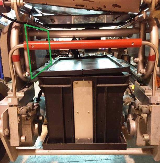

My chair have one box on the left side that has a on/off switch. When i try to climg on to hard curbs and it is in a bigger effort it just shuts down.
Thats when some good samaritan have to reach the on/off button and turn the power on again.
Then the joystick can be turned on and is like reseted to minimum speed. I have put it fast and furious again. Not that fast and neither furious but thats what we have...
What is that box cut off thing by the way?
Hard to know for sure without seeing it, but from the description this sounds like a circuit breaker that is cutting off all power when it senses that too much current is being drawn. It could be undersized, or it could be old and tired - especially if it's been tripped many times. If it is a circuit breaker, somewhere on it it will say how many amps it should continuously carry. It will trip after a significant delay at twice that current, and much faster the more the current exceeds its rating. If it has gotten weak, it may trip at a much lower than rated current.
If you suspect that it is tripping too easily, it is probably easier to just replace it rather than try to test it - for that you'd need a peak-hold ammeter to see what current was actually flowing just when it trips. If it is a standard type, you should be able to find a replacement at an electronics supply for a price much better than what a wheelchair dealer would charge. Even if you can't find it there, you may be able to find it online from a wheelchair parts supplier (such as Monster Scooter); they are not the cheapest source, but still better than the dealers.
Ciao,
Lenny
I dont know if its a circuit breaker or not. But from my expirence it those what i said.
Seams that mine is connected to the power module from what i can see, the pic i show below, the cable goes on its direction...
I dont even know what a circuit breaker does, but from what it sounds, looks like it works kind of like a fuse. It sees that theres is a overload somewhere (dont know where from) and switches off the eletrical circuit to avoid biger damages.
Go thing is that its resetable like turning on again so we ont have to carry fuses around where we go.
I dont know how much mine can handle. Also dont know yet how much my power module has in amps matter. But lets say that my controller is a 50amps, so it can only sucks out 50A max from the baterry at a given point, when in effort. So does it mean my circuit breaker also is 50A so that way it shut all down in a case of a overload to protect baterries to get that big puch that maybe they could not handle?
If so, it means that a circuit breaker is another protector when it come to the BMS issue.
Having this much protections such as the power module controller that only comands the entire chair to drain only untill the amount of amps it is suposed to, the circuit breaker with the same principle, a large Ah capacity and large C rate cells that have the double or more times the capacity that the circuit can drain it (remind me if im forgetting something) to prevent it to discharge so drasticly and kill the baterry, what job can a BMS do in the midle of this?

Postby LROBBINS » 30 Nov 2015, 20:35
The purpose of a circuit breaker is not to protect the battery from a heavy load, but to protect you from the fire that might break out if a + and a - wire shorted. Its rated value is usually near to the current-limit set in the controller (assuming that the controller actually is current-limited; current standard wheelchair controllers are, many hobby controllers aren't, and early-days wheelchair controllers weren't). If the controller doesn't limit current, that breaker becomes your primary protection from damaging the batteries or, more importantly, from frying the output stage of the controller itself. People do try to make a BMS substitute for current-limiting in the controller, but it's a lousy way of doing things because, just as a circuit breaker opening or a fuse popping, you just plain stop when the overload happens, while a proper controller keeps you from ever getting into an overload situation.

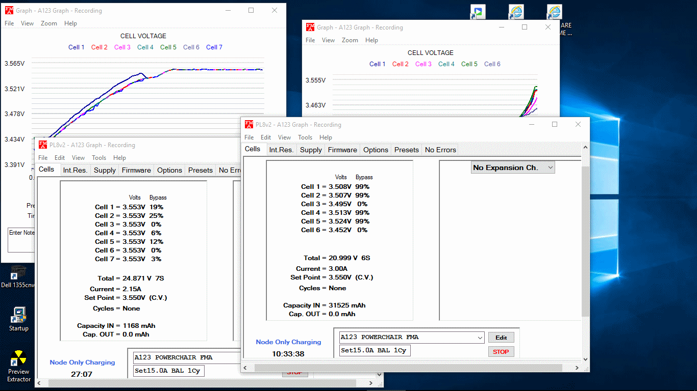

I know that charging cells and 3.55v is better so they dont go crazy, but can i still charge them fast like at 20a?
With this comes some new questions like how do i know if all cells are equaly well ballanced and what to do if one or more are lowerr than others?

Postby Burgerman » 06 Dec 2015, 02:54
Charge fast? Yes. Its best not to do so for longevity. But if I am in a hurry I charge at 40A. Otherwise I charge at 15Amps on a 72Ah pack, 20A on a 100Ah pack etc.
If you choose say 3.550 Volt, and set charger for 40A the charger will just throttle back and reduce power as the highest cell reaches 3.550V. The balance circuits will then drag the highest cell down as the charge continues until all read exactly the same.
There's 2 batteries being charged here. A 6 cell, and a 7 cell one. (it actually makes up my 13S BM3 battery. Its on charge now so I just did a screen shot).
The 7 cell one is almost topped up, and balanced almost, will remain at 3.550V (+/- 0.003V) until current falls to my chosen 50mA level, or CV and balanced, plus 8 hours whichever occurs sooner. Note BYPASS figures. That shows the percentage of the remaining 2.xA CV current being removed on a cell by cell basis. That will read all zeros once fully balanced.
