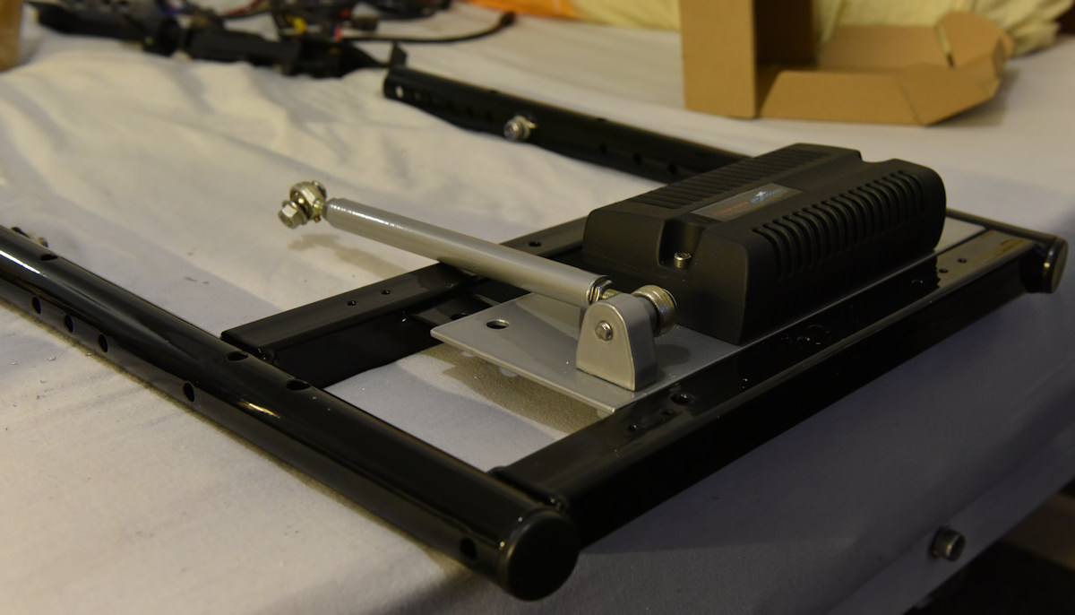

And the PM is mounted to the alloy plate, bolted to the seat frame under the front. I am considering adding 2 computer fans...

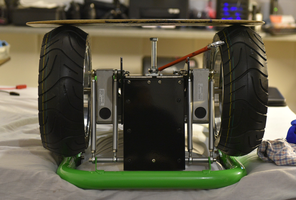

Postby Burgerman » 28 Jan 2016, 13:51

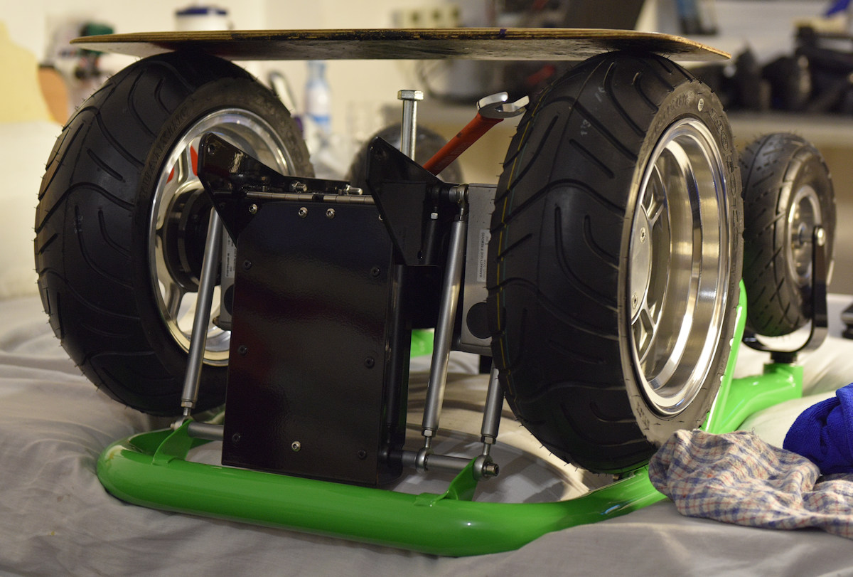

Checking wheel, tyre, run-out, balance & bearing seating etc, caster stem bearing preload, and finally adding the puncture seal. Because once you have there's no way to test balance for eg.
Run-out of tyre or wheel does make a difference. Caster preload does too.
Does balance "matter"? Not much if at all at 6 ot 8 mph. Unless its really bad and not central. But I use the same casters/wheel on my chairs and these are swappable. So these may end up on the 16mph chair. And then it does matter.

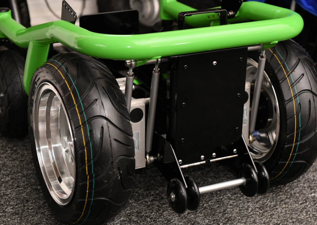

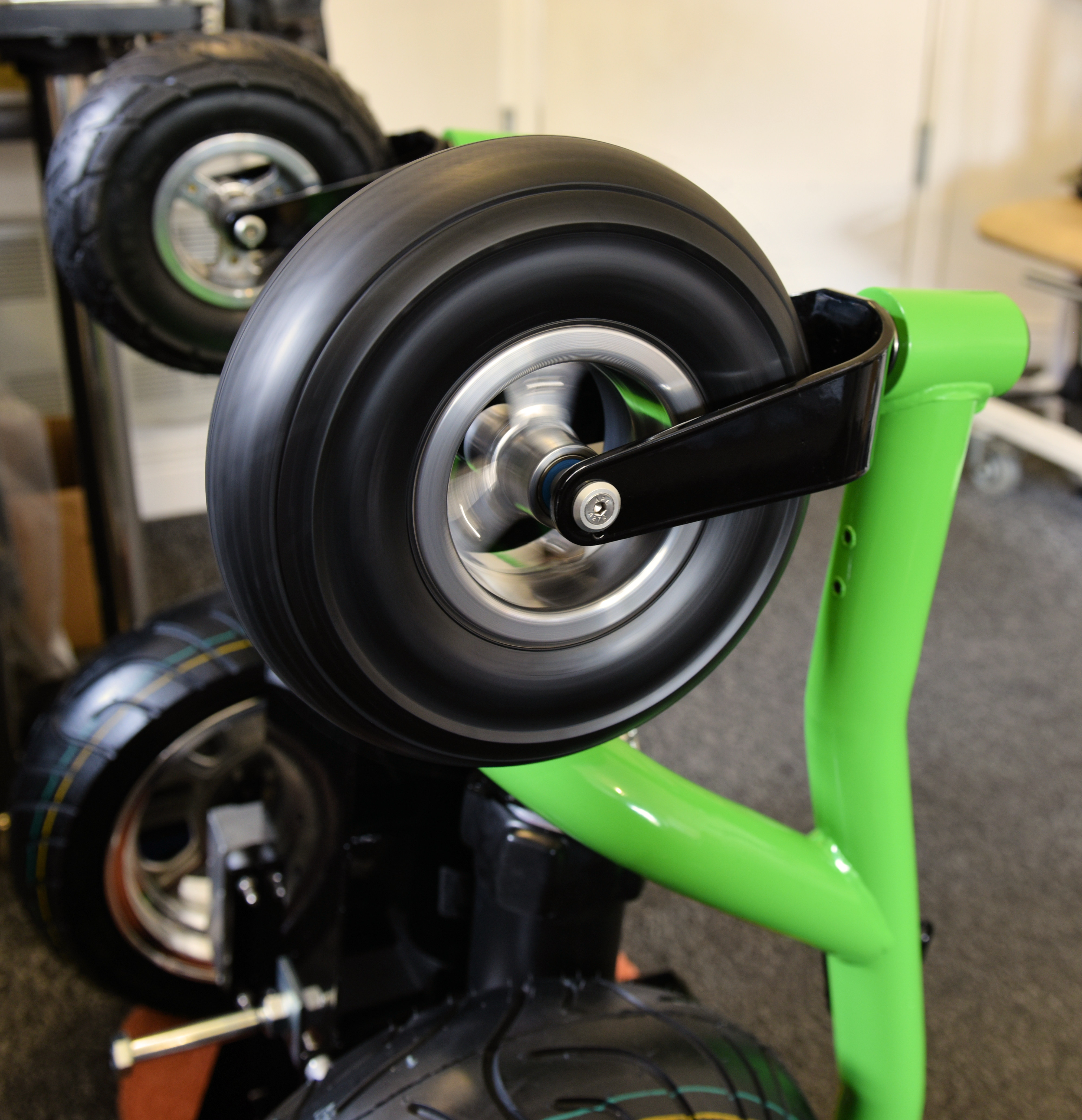

Postby Burgerman » 30 Jan 2016, 14:55

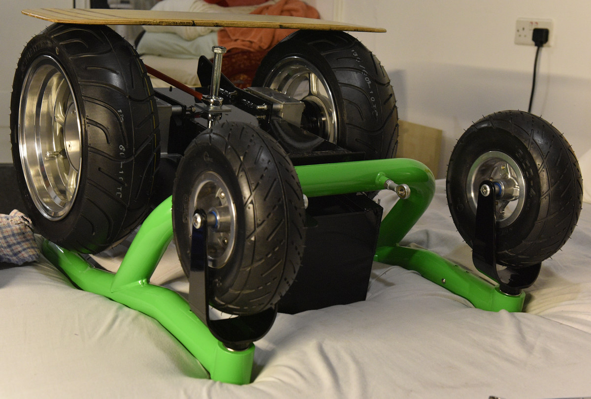

Anti tips fitted. 80mm inline skate wheels. 8 new stainless steel bearings. Because the new 10 inch wheels are about 30mm higher overall.

I am getting older. Now 55. And recently flipped myself out of my BM3 chair at about 8 to 10 mph over the back. So far I keep getting away with it and being rescued... But bigger wheels mean that the anti tips are affectively 30mm shorter, and higher! So may as well not be there. They may even make things worse as they lift the rear wheels off the deck preventing me from decelerating...

Postby Sully » 30 Jan 2016, 16:57
I would consider making your tippers closer to the ground, you can simply add two adjustable brackets to your existing original fixed brackets. That doesn't seem too difficult, and can be made not to extend the overall length, by sliding up and bolted in place. At my age 21 years older than you, tipping over like that may well create a very dangerous situation. I'm pretty sure there isn't much in my head, but I don't need to crack it open to find out. :lol:

Postby Burgerman » 30 Jan 2016, 18:21
I dont mind tipping. So would actually p[refer them a little longer but still high. For curbs etc. But also like this chair short! You cant have it all ways...

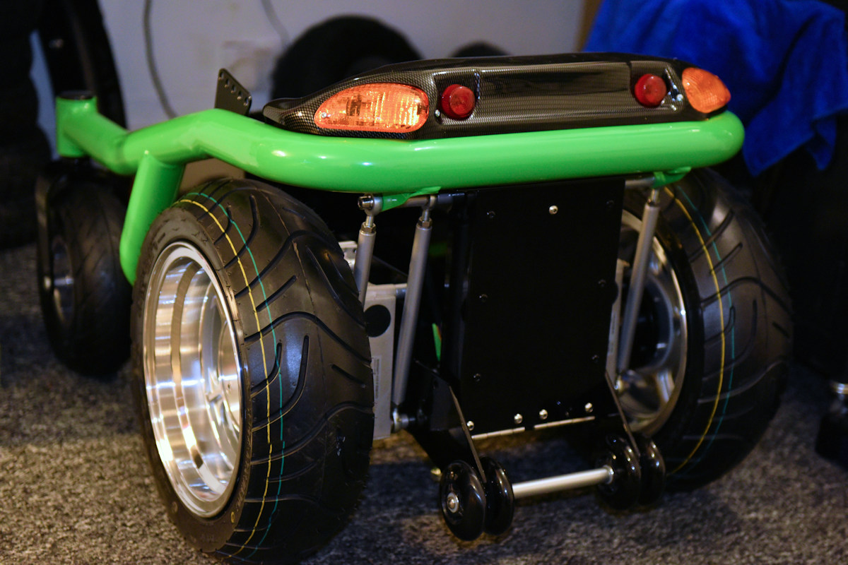

Postby Burgerman » 30 Jan 2016, 20:46
Now rims polished, rear light fitted and converted to LED, (one of the few original F55s parts I use. But it looks better and fits the frame. So why not!
Now looking at car seating. Or rather just the back. Will keep a flat area for stock 16 to 20 inch wide cushions.
Why dont all powerchairs use fat tubeless tyres? Beats me... The car industry do. The motorcycle industry do. And now 40 years late, the powerchair home built industry do!!!

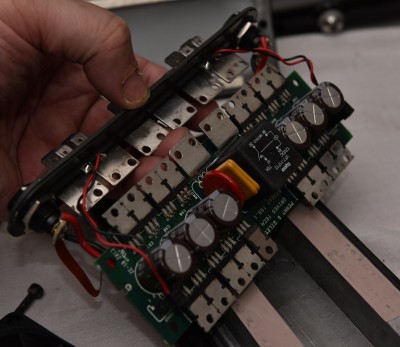

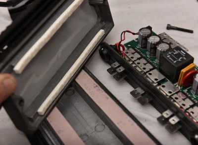

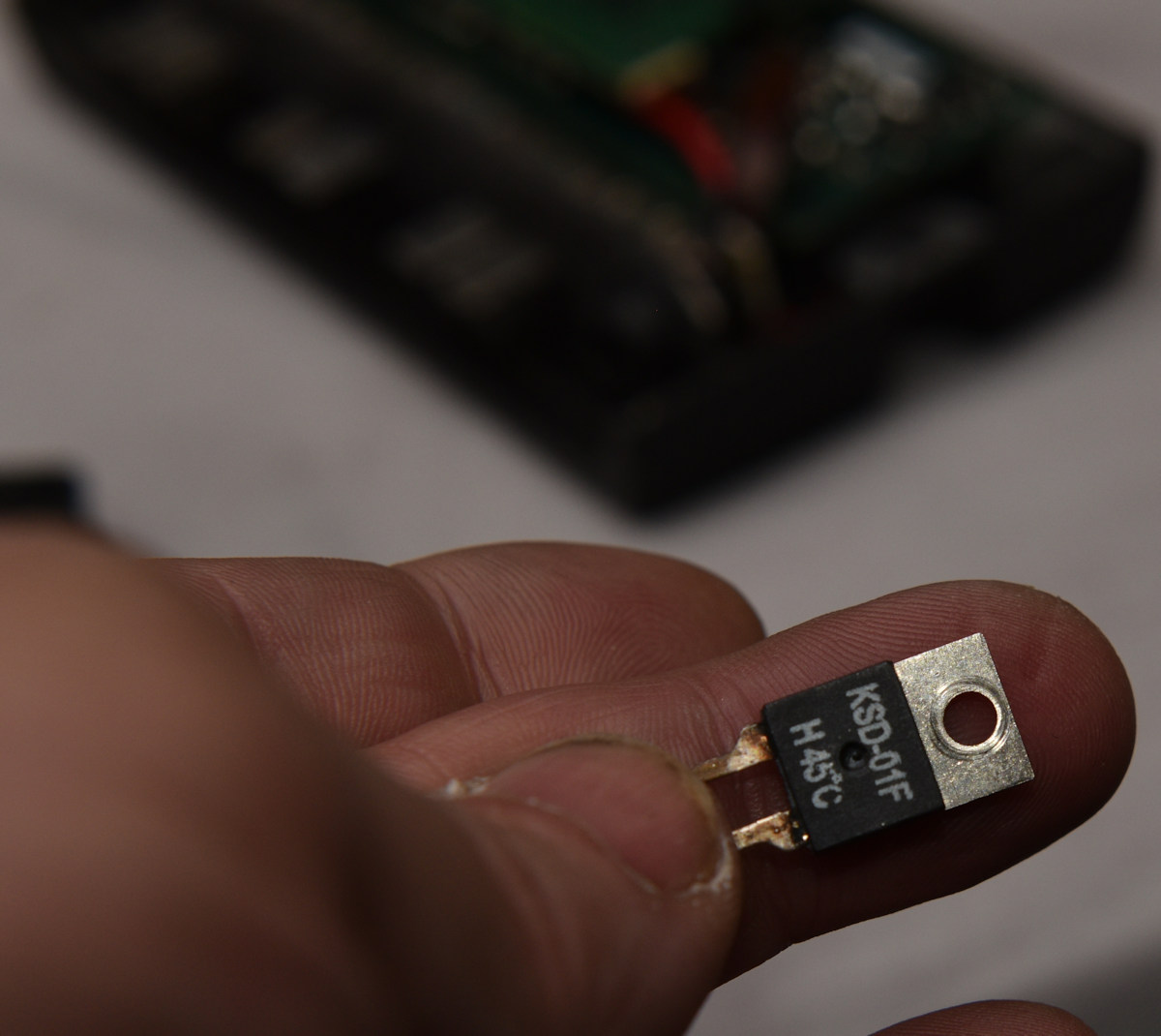

I am just checking out my Pilot Plus well used 100A unit.. All the contacts need cleaning up as they show signs oif burning. on the INSIDE and outside!
Take a look how the contacts connect battery and motos INSIDE. They just press togetheer with some foam strrips...
I am also adding a 45 degree thermostat switch. Because I am adding a fan to keep things cool. This will stop it rolling back and reducing power so soon. The best place for the tiny thermostat is inside bolted to the mosfets. But thats not easy... So will be next to them instead.
