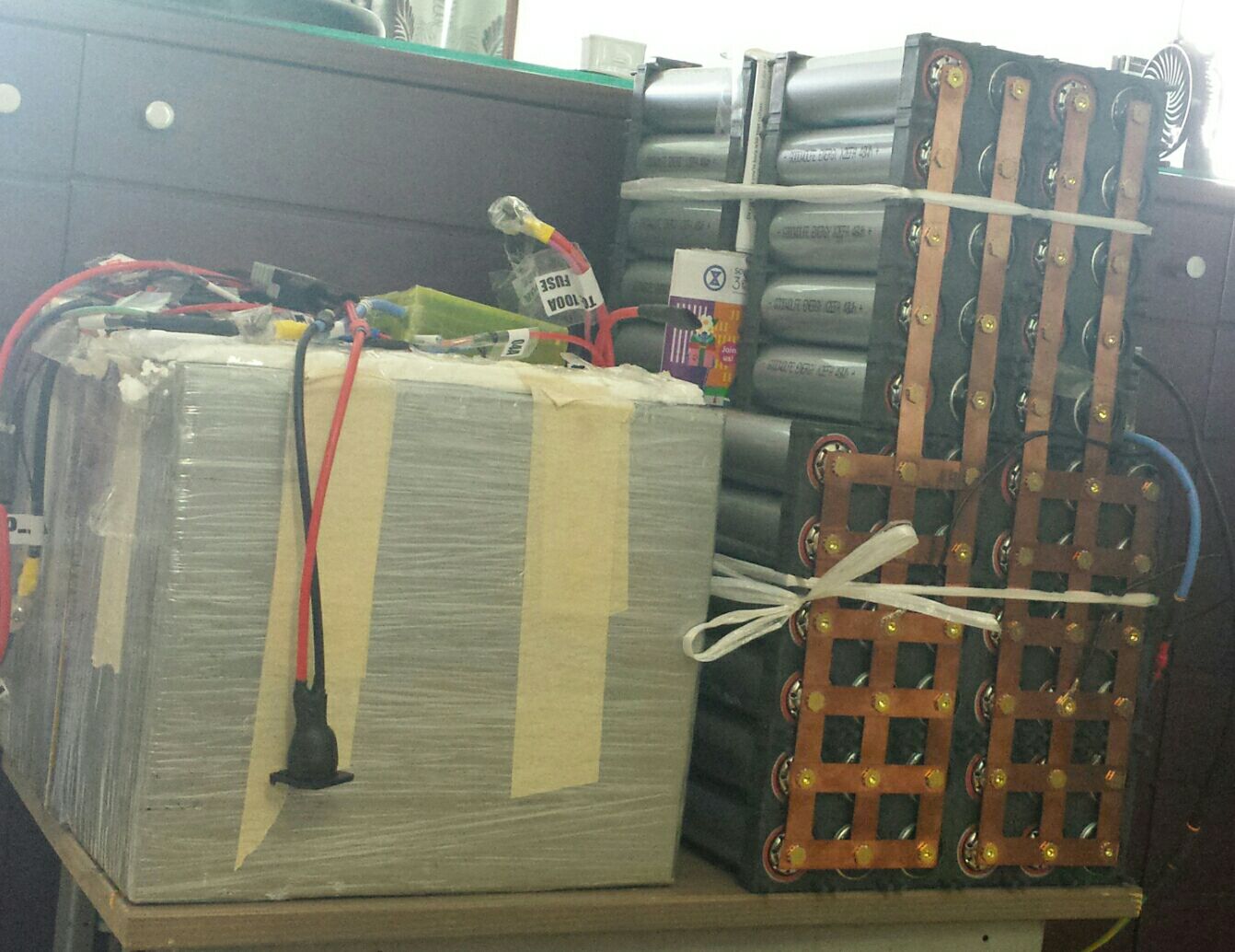

:D Line them up to a 14P8S rated 24V 210AH for testing.
Found only one bad among 112 cells, and get replaced.
After balancing, 200 AH were released on the first discharge, which was stopped at cell voltage @3.0X volt. Don't want to go too low.
Cells are good and capacity seems up to standard.
Together with Nandol's 190 ah pack , that is over 400ah here , and it is a BOMB.

Postby JoeP » 17 Aug 2016, 15:00
I like those custom CNC cut copper busbars.
Question: Headway's busbars are nickel plated copper, presumably to prevent oxidation. Will you are custom bare copper busbars eventually oxidize enough to interfere with electrical connectivity?

Postby Irving » 17 Aug 2016, 15:37
JoeP wrote:I like those custom CNC cut copper busbars.
AFAIK copper doesn't oxidise in air unless heated to >300degC. It does react with weak sulfuric acids such as 'acid rain' with a greenish patina of copper sulfate. Freshly cleaned copper will dull when handled as the surface traps 'dirt' ions, but these polish off quite easily.

Postby shirley_hkg » 19 Aug 2016, 04:59
:D OK. Will play more attention to exclude weather erosion when packing it .
The bus bar has a 12 mm square cross section, and there are 6 bars in every paths. There will be much left to use, even heavily eroded.
Nevertheless, when I inspected my 5 years old A123 pouch pack, which uses copper pipes as bars, I didn't see they are severely damaged... Hope they will last a decade more.
