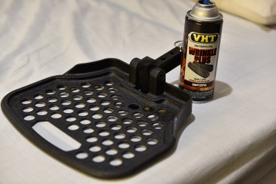

Postby Burgerman » 14 Dec 2016, 22:54
New footplate came. 20 quid eBay. Quick coat of wrinkle paint enamel, and into the oven. Looks as good as new and I just need to make up a mounting.

Postby hank » 14 Dec 2016, 23:17
Burgerman wrote:New footplate came. 20 quid eBay. Quick coat of wrinkle paint enamel, and into the oven. Looks as good as new and I just need to make up a mounting.
Is this for the new Storm Xplore 8-)
