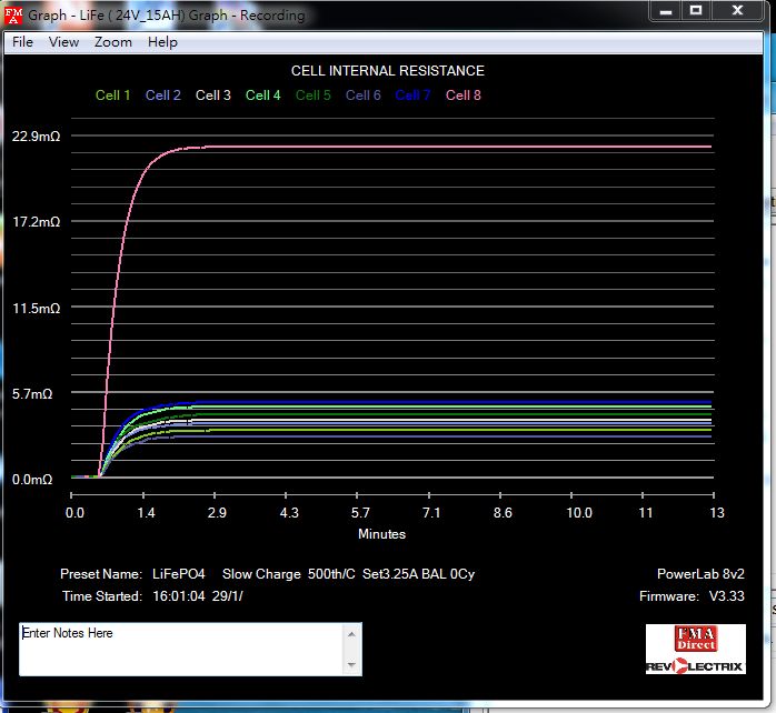

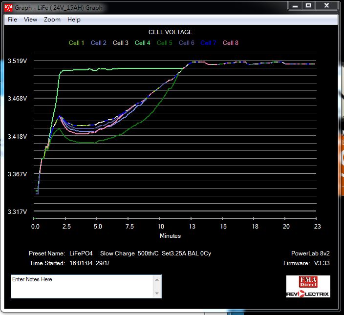

Postby shirley_hkg » 29 Jan 2017, 11:05
First run of PL8 .
Postby Burgerman » 29 Jan 2017, 12:13
I wouldnt worry about internal resistance reading because its so very hard to measure and you have long cables. But check for loose bolts etc.

Postby steves1977uk » 29 Jan 2017, 12:38
Isn't it odd that it's always Cell 8 that has the higher IR, the highest I've seen on mine is 2.5mohm and usually it sits around 1.3-1.8mohm. All the others are 0.7-0.9mohm.

Postby Burgerman » 29 Jan 2017, 12:58
It has to do with the way the length of the long power cables get added to the resistance of the last cell. If you were to use 6 inch long cables and charge hobby lipos, it works perfectly.
Shirley, the first couple of charges will show a lot of imbalance. The next few will show less and less until they show none. Set termination to 1000th of battery capacity for the first charge, so all cells are soaked at 3.6V for a long time. Then reduce to 320th. And set discharge to not balance... Because that will unbalance this chemistry. You can only balance LiFePO4 once over 3.5V unless you charge at a very low rate at which point you can use 3.5V balance start. But it causes problems at higher charge rates.
