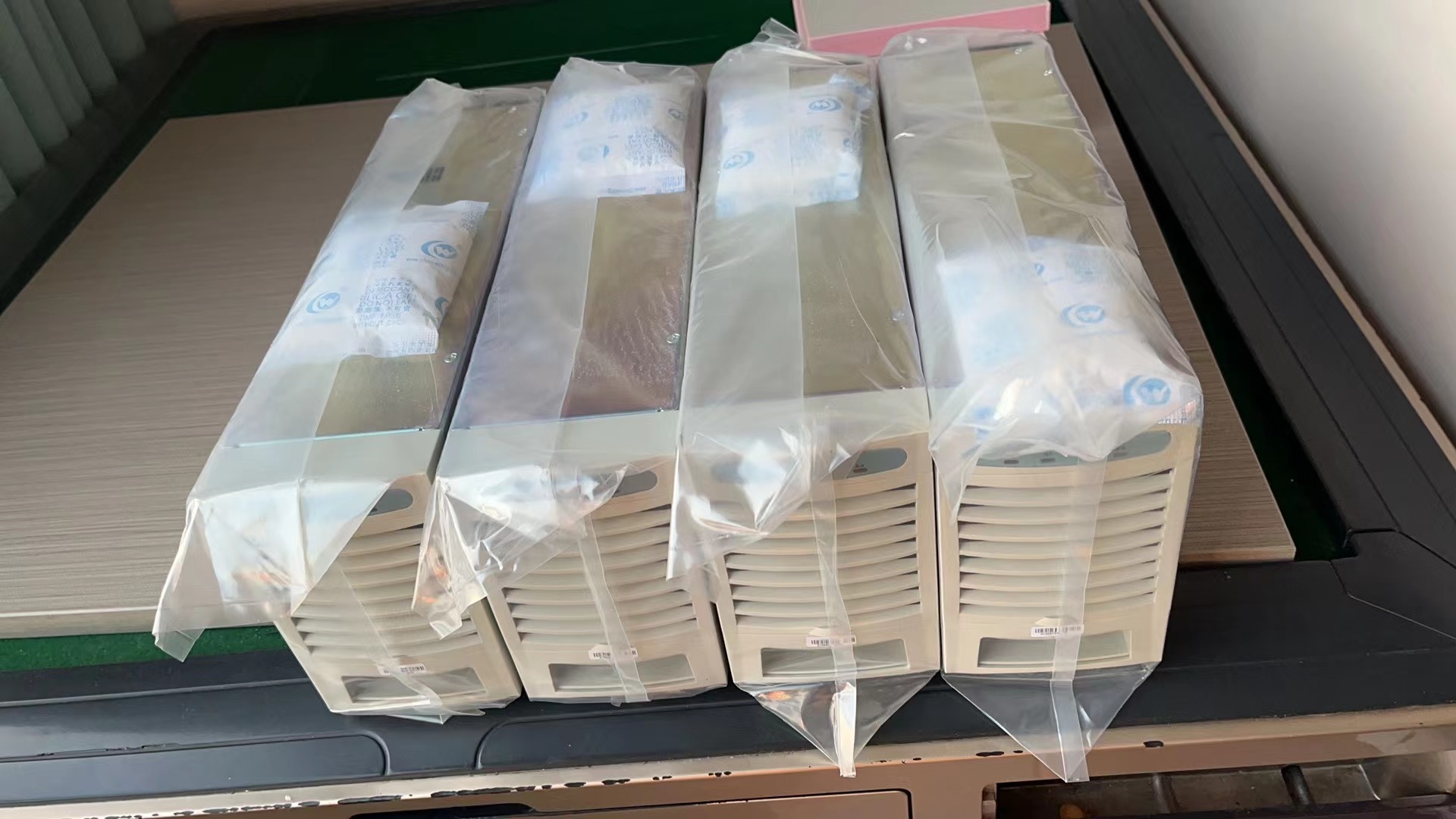

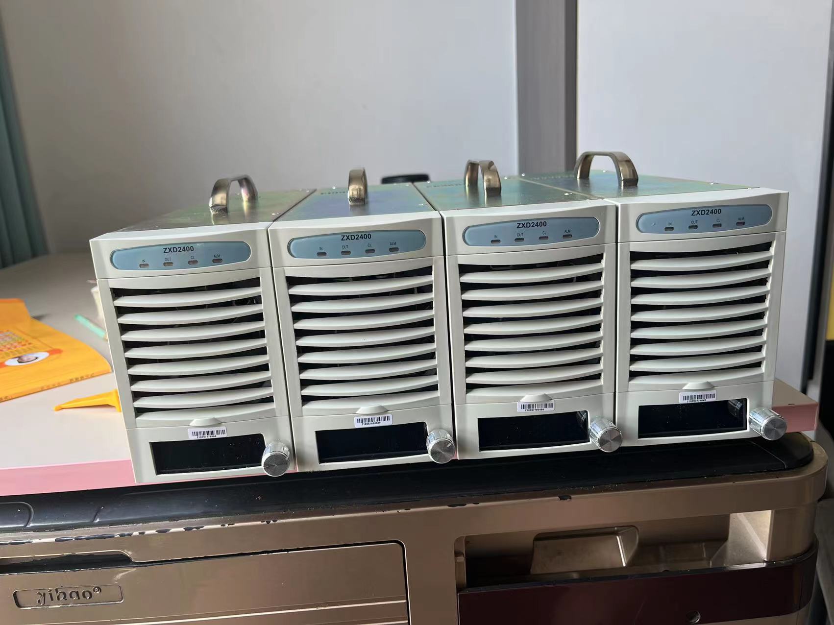

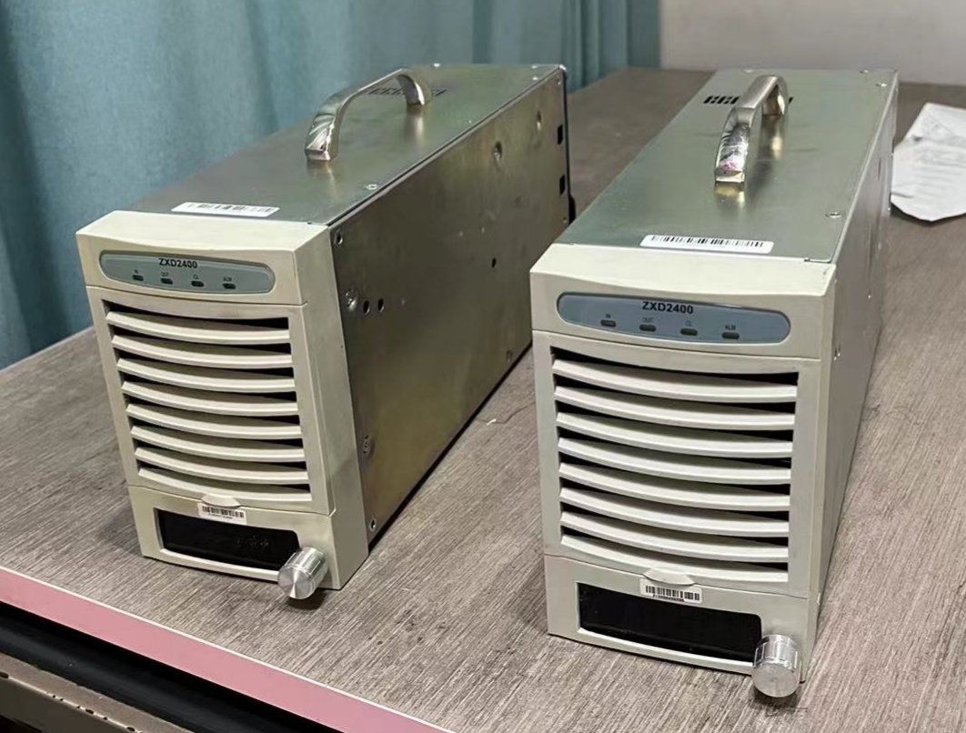

Spent quite some effort to find 4 brand new ZXD to feed members' appetite.
Now undergoing metamorphosis into 0-60V/0-50A adjustable.

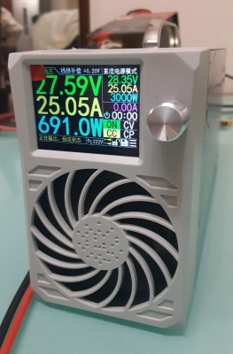

The new generation with colour display is much quieter, but it don't have English menu till 2024.

New breed has large LCD display. Don't mix up.
