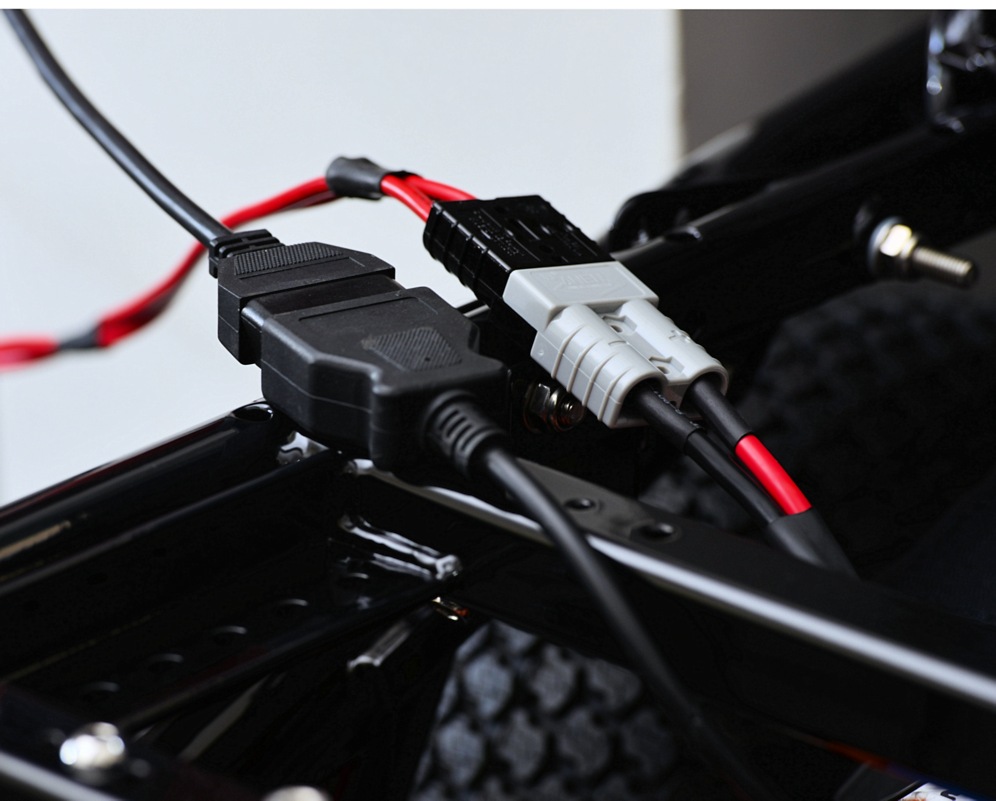

Postby Burgerman » 10 Apr 2013, 14:09
These are the 2 connectors I use now.
The BLACK one is 15 pin, easy to insert, and has the balance connections. Small gauge wires for a 13 in series 78 cell pack.
The Grey/Black one is the charge connector. An Anderson. Slightly harder to connect. But these are also available as low insertion force.
Both will be firmly bolted under the seat edge eventually. This is simple, cant be connected wrongly, and the charge cable/balance cable can both be heat shrunk or taped together as one if you prefer.
Alternatively just use one single connector with all wires in it. There no real need or much advantage with heavy charge cables on lithium.
Posts: 70469
