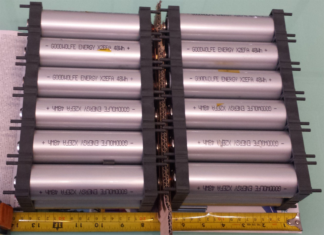

Postby Burgerman » 08 Oct 2016, 01:22
Yes a Nandol version of a 24v bm3 built by his blacksmith friend.
Posts: 71117
Postby Gnomatic » 08 Oct 2016, 02:46
Burgerman wrote:Yes a Nandol version of a 24v bm3 built by his blacksmith friend.
Ah very cool
