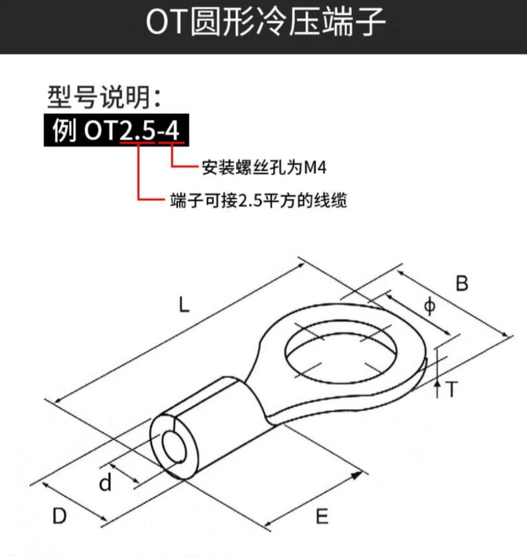

I'm struggling with my new 40Ah prismatic cells. Their terminals are M10 studs. I can't get it right with the wiring. I'm fine with the balance connectors, soldering the DB9 is no big problem it turns out, though no doubt attaching M10 ring terminals to 22ga balance wires will also be difficult. Can anyone tell me how to specify ring terminals correctly, so I can get ones that fit the studs and the wire?
I'm ok with being hit-and-miss with the lugs, but the cell connectors and output leads are also giving me some grief. I can't figure out what size to use - I've discarded the 6 gauge as it's too thick for me to work with, even for the cell connectors. The controller is a VSI, it draws 50A maximum. The Vienna chair has what looks like (errm - the insulation looks like) 12 gauge for the battery-controller wire. What wire gauge should I use on my pack?
I should ask in mm² because SI is much more versatile and sensible, but AWG is so much more visual! But I have a conversion table, so I'm ok with either.

Postby Burgerman » 03 Jun 2019, 13:59
yES, LATER. bUSY WITH CAR WAXING AT THE MO!
yOU NEED 6MM2 BATTERY CABLE. a 60a FUSE (MIDI) And my stupid keyboard is doing that thing again.
You need ring terminals with a 8mm hole. And 6mm2 cable entry.
And 8mm hole with whatever sqmm the balance wires are...
Why soldering difficult? Use a turbo torch lighter, some flux. And do not overheat it. Then it does itself!

biscuit wrote:I'm struggling with my new 40Ah prismatic cells. Their terminals are M10 studs.
Burgerman wrote:You need ring terminals with a 8mm hole. And 6mm2 cable entry.
M8 ring terminals are going to be a tight fit on M10 studs :?

Postby shirley_hkg » 03 Jun 2019, 15:06
OT8-10 for 8mm wire , I guess
Postby biscuit » 03 Jun 2019, 15:21
Yes I assumed M8 or M6 studs but when they arrived, it was M10 banghead

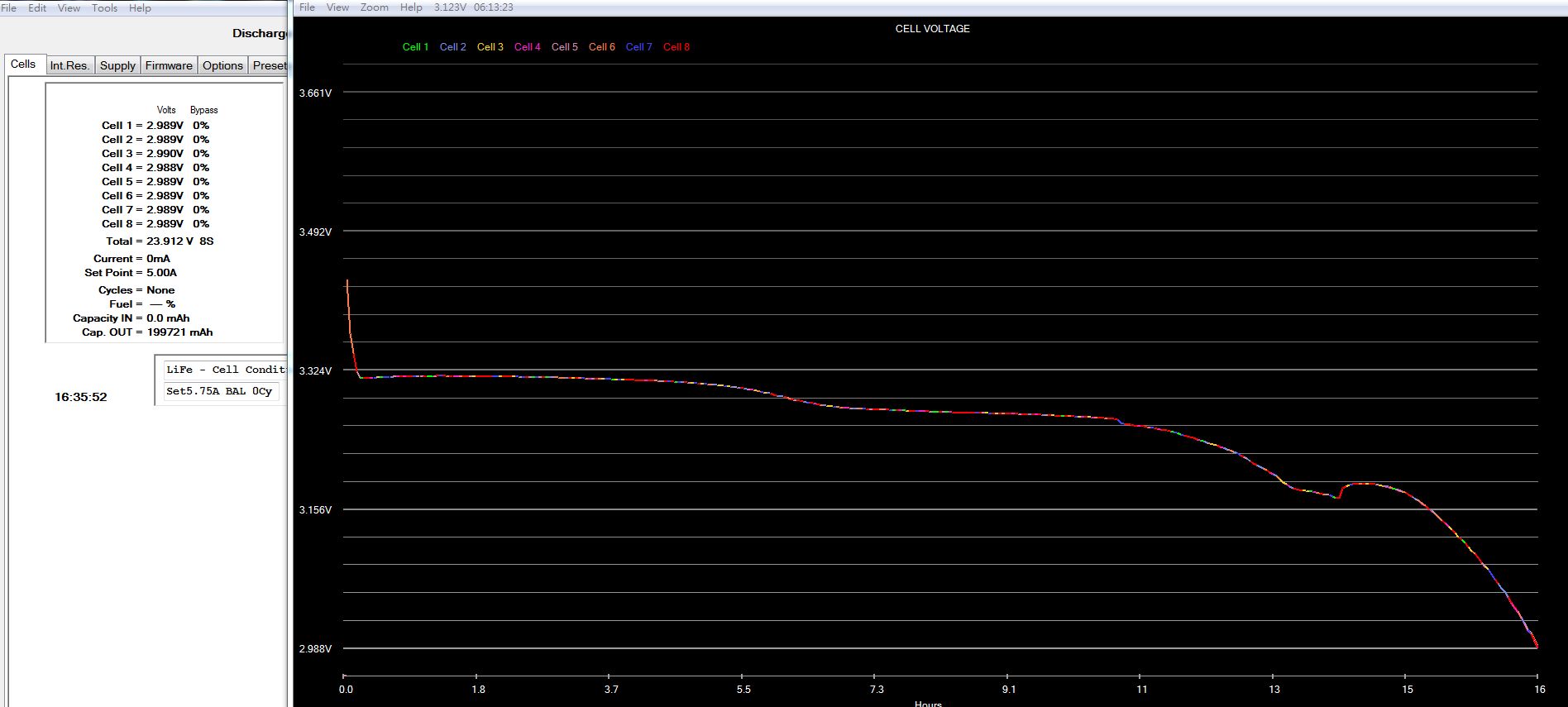

Postby shirley_hkg » 08 Jun 2019, 10:01
Did a quick match of 16 cells to form my 2P8S @EVE-LF105 pack , and perform a 200Ah discharge.
Voltages of the 8 groups stayed closely packed :dance , till the last Ah.
Will be a pretty balanced pack , down to 24V.
Chair's battery ran out of storage. PL8 switched to its internal discharge mode, AUTOMATICALLY. cheers drunk2
Postby shirley_hkg » 08 Jun 2019, 10:19
Only 1 mV , while discharged to the last 0.1 . . . . amphere hour. goodpost
