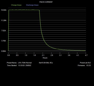

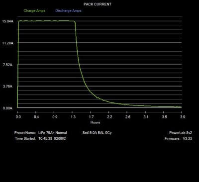

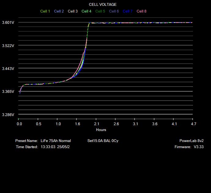

Postby steves1977uk » 02 Jun 2016, 22:43
For comparison, here's my charge graph from todays charge... Set balancing to start from 3.40v and terminates at 95mA.

Re: S646se - Full LITHIUM Pack Project - First Attempt
Postby expresso » 02 Jun 2016, 23:02
nice tight one you got there - haha -
i have to see what BM set for me - will post my results later tonight - i have balance to start at 3.5V i believe - Term. at 200mA
Postby Burgerman » 02 Jun 2016, 23:16
Steve, looks fine as is but set to 3.5v balance and see if that wiggly unbalanced part goes away next charge, and set termination to 500thC. (150mA)

Postby steves1977uk » 02 Jun 2016, 23:30
expresso wrote:nice tight one you got there - haha -
Haha expresso, I like tight ones! :D :mrgreen: :oops:
@BM, here's my previous charge graph with balancing from 3.50v.
Will up the termination to 150mA on my next charge.

Postby Burgerman » 03 Jun 2016, 00:12
Whats happening is that the 3.4 balance is unbalancing it, so it rebalances at the top. So you get the uneven lines at the top of the graph as it rebalances it again.
The 3.5 balance one is actually better, as almost no balancing was needed at the top where it matters.
But both are pretty good.

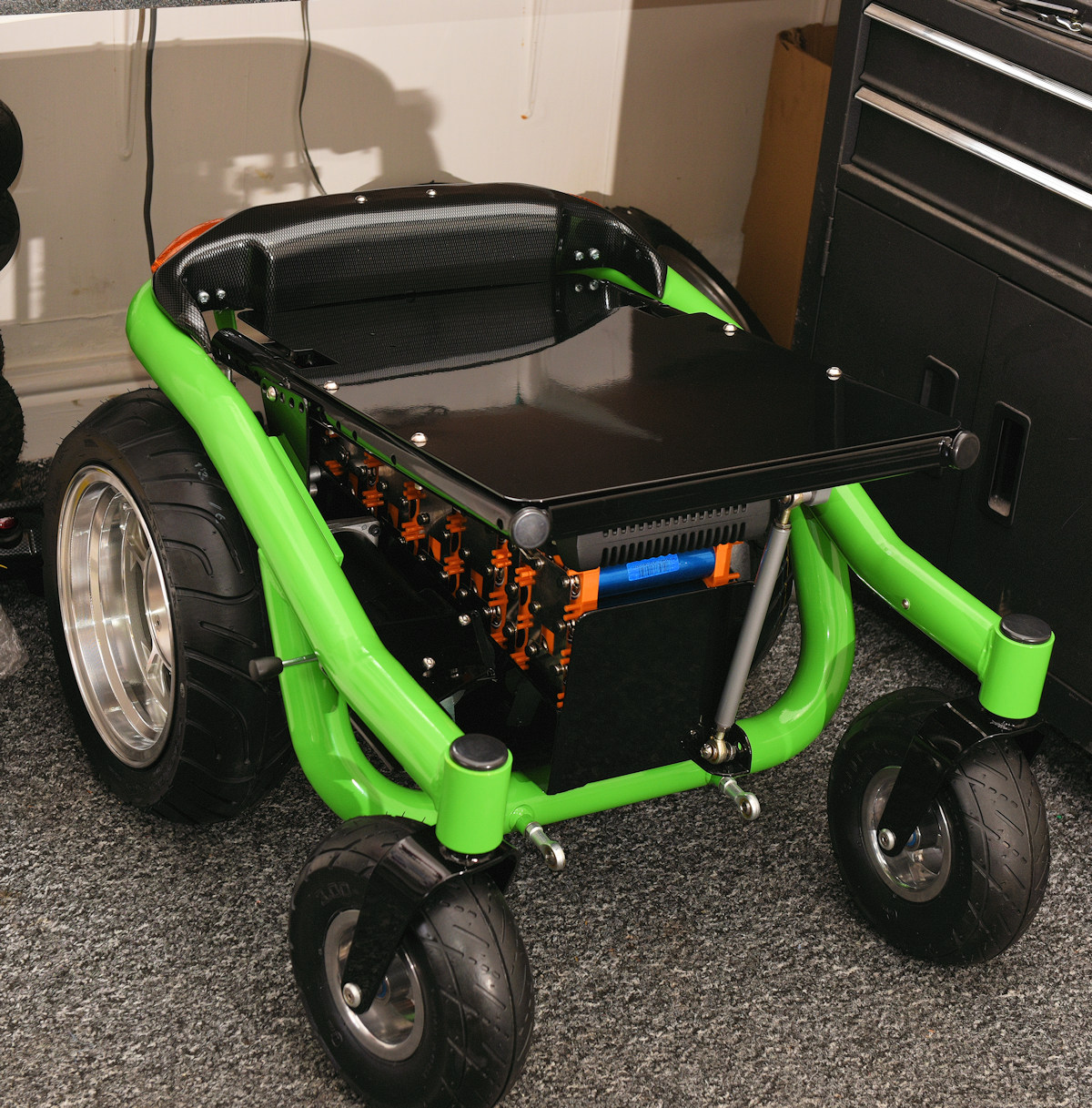

Postby Burgerman » 07 Jun 2016, 09:10
Tested and very loud. But physically bigger than it looked. So may not fit it. Still laid on my bed so cant anyway! :twisted: :evil:
I have a more mileage freindly green chair to test, since its a 6.2mph (now 7 with bigger low rolling resistance radial tyres/wheels) chair to test. With 120Ah life battery. That should also get 55 to 60 miles without addon.
