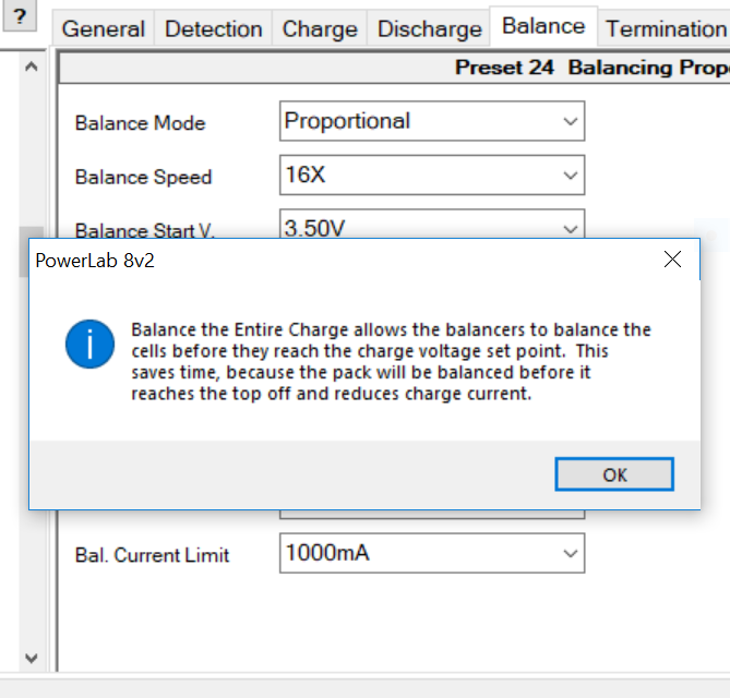

If you charge at 3.500V CV (or less), you must set the balance to balance only at CV.
Thats means JUST set balance entire charge? to OFF.

Burgerman wrote:If you charge at 3.500V CV (or less), you must set the balance to balance only at CV.

BM - When we charge at say 3.6v and balance at 3.5v, do we start balance at 3.5v to reduce the overall charge time?
Or is it because if we to balance at CV 3.6v we’re a bit too near the cells top range?
But we can charge/balance at 3.5v CV because we’ve got a safety margin?
Just trying to learn.... :geek:

I just checked the CCS and have set 'balance entire charge' to NO. The dialogue boxes are great on the CCS cos it says BEC to NO means cells only balance at CV and do not balance at CC. Setting BEC to ON shortens overall charge time. But I'm just testing cells at the moment.
