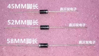

Postby shirley_hkg » 31 May 2018, 01:43
:ban
Or my novice way .
Twist 3 , 4 , or 5 these small 5A diodes together . Solder / terminal to the negative cable . Expose it to open air and they dissipate heat .
I tried for years without problem . It is not that hot as thought actually .

Postby Burgerman » 31 May 2018, 02:54
15A max? He already blew a fuse 3x that size! And I would expect 100A or so to flow at times for short period.
Posts: 71092
