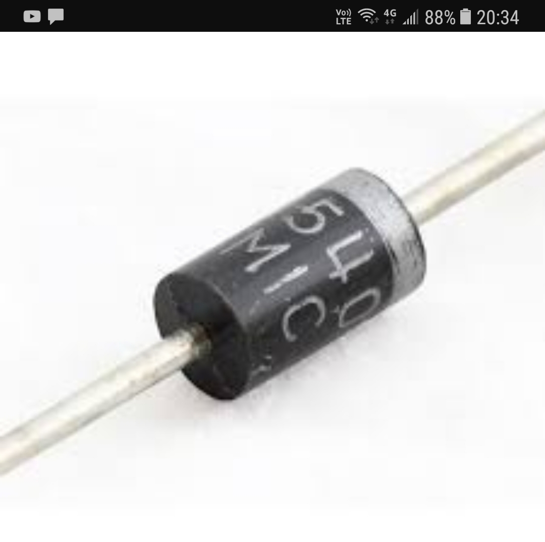

Burgerman wrote:Any 50 to 100A schottky diode.
https://www.ebay.com/itm/Vishay-VS-100B ... m570.l1313
Free shipping from UK?
Ok done - i ordered two of them - worth a shot - 20% more range - that wont be bad - what does that translate to ? 5 miles extra or more ?

i will making an adapter with xt90 one end and SB50 other end - and this in line - - thats how i have it now - i can then just replace with new one with this installed inline - long story but this Cable i had was my first one made and had both sb50 ends - Since i have changed over to using xt90 for other reasons - i had to make an adapter to use this cable or make a new cable - - nothing wrong with the cable so i left it and made adapter instead -
Schottky is the one you posted - i ordered that one

both ends are different - does it have to be added in a certain direction ? or dosnt matter
Postby Burgerman » 17 Jul 2018, 23:36
Yes but thats easy. Wrong way, no power flows. So you will soon know. Your lead will run out...
A diode is a one way valve for electricity. Lets power go one way. But nothing flows the opposite way. They are used to turn AC into DC for example. Or to prevent a device getting connected in reverse causing damage. The only problem with them is that they lose a little voltage. But thats useful here!
A silicone diode loses about .65v. It loses a little bit more as the Amps increase.
A Schottky Diode is the same. But they are good at high frequencies which we dont care about and good at high currents which we do. They drop between .2 and .4V. Usually around .25 at idle to .4 under load.
So will allow the voltage of your addon to be around .3V less after the diode. So the lead will get used a little more as the voltage drops. At the end of your run, when the lithium is at 3.1V the battery will be .3v lower. Does this matter? Yes, you will use a little more lead. Maybe not much. The .65 to .7 drop from silicone diode will use more lead.
There are lots of types of diodes. Laser diodes, germanium diodes (.2 drop) and the LEDs you see lit up everywhere, etc.

ok - i got the one you linked too - you said that can make 20% difference in range for the better give or take ?
you would know which end to attach it ? i dont want to do it wrong and run on lead only
Postby expresso » 18 Jul 2018, 03:19
ok - i can just heatshrink the metal parts and leave the Main body alone and it would be safe ?
the easiest way to do it for me now is to put it inline in the bag - so its safe to leave it exposed the main body only - ?
in this pic - the xt90 thats not in use there - thats where i will have an adapter from that xt90 to sb50 end - and will sit in the bag on top there somewhere
that would be the best way for me to add it -
have you had any issues where it failed on you ?
https://www.ebay.com/itm/Vishay-VS-100B ... 2749.l2649
which end goes where ? Neg. wire not Pos wire ?

I did it for years . Twist a few of them together to allow bigger amp . Just warm to touch . Long way to get my finger burnt .
Shield the wire ends only so as to expose the diode bodies to open air for cooling . You can put it outside your bag , near the chair's end .
Prefer to put it in the NEG path that it won't have sparks , in case getting in contact of metal .
Worried still ? Put a 20A rocker switch , in parallel with the diodes , to cancel / bypass it anytime . cheers drunk2

If it were in the NEG wire , the end with silver strip should towards the battery .

the diode i purchased is this one -
https://www.ebay.com/itm/Vishay-VS-100B ... %7Ciid%3A1
which end would be facing the ADD ON pack ?
