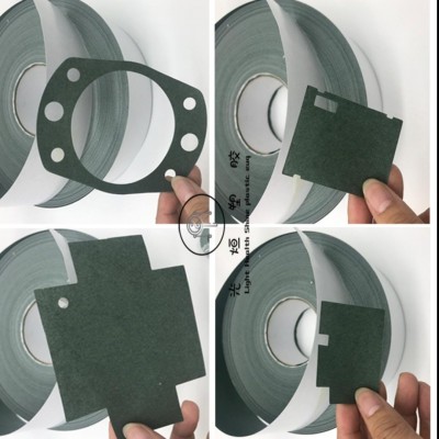

Working on a 1P7S 70Ah power bank, I begin to love this self-adhesive "fish paper"
very much . :dance cheers

What is fish paper? :eh:
Posts: 71102

Burgerman wrote:What is fish paper? :eh:
I use the 1mm thick ones .
Posts: 4657

Postby Burgerman » 06 Mar 2019, 02:35
Fish?
Do you mean gasket paper?
What is it made of? Dont say fish... :clap

Postby shirley_hkg » 06 Mar 2019, 02:49
Burgerman wrote:Fish?
viewtopic.php?f=2&t=1813&p=133204&hilit=Fish+paper#p133204
Um *,gasket paper . :clap

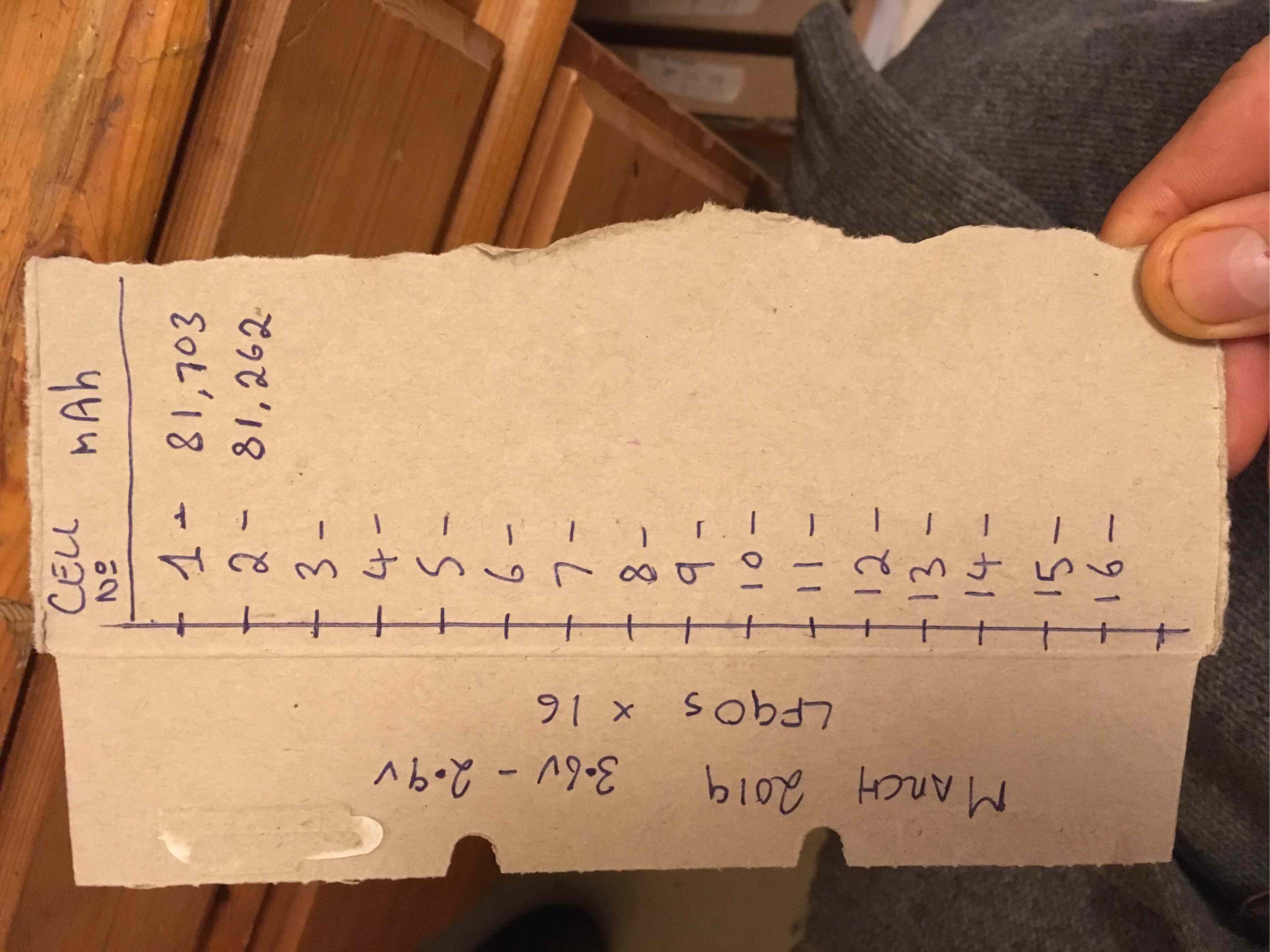

I thought I'd test the capacity of each cell just for the hell of it while I'm waiting for your bits to arrive :thumbup: . My PS can't handle anymore than one at a time. The first two are very close, I'm on no.3 now. When discharged I put about 30% back in +/- and few mAh.
Am I wasting my time testing each cell? I'm writing the mAh rating and date tested on each cell.

Postby Scooterman » 06 Mar 2019, 09:36
Well it won't be you were only discharging at 4A for 50secs! :lol:
