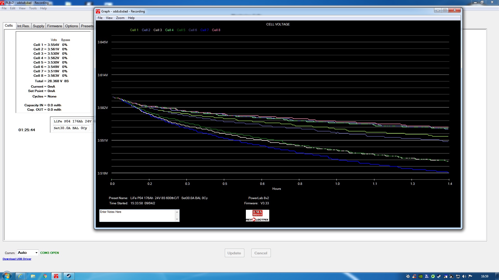

Postby shirley_hkg » 09 Apr 2019, 14:49
Experience tells the weaker cells rise sooner . The IR seems too good to be true to me also . PL8 is not good at this.
Switch to MONITOR as soon as recharge ended , to log the voltage drop and graph it for an hour or two .
Discharge the entire pack as one to 2.95V to find out . You will be well rewarded.

Here is the graph from monitoring. Any thing stick out?
Postby Scooterman » 09 Apr 2019, 17:30
terry2 wrote:Here is the graph from monitoring. Any thing stick out?
Nope, not as far as I can see czy
