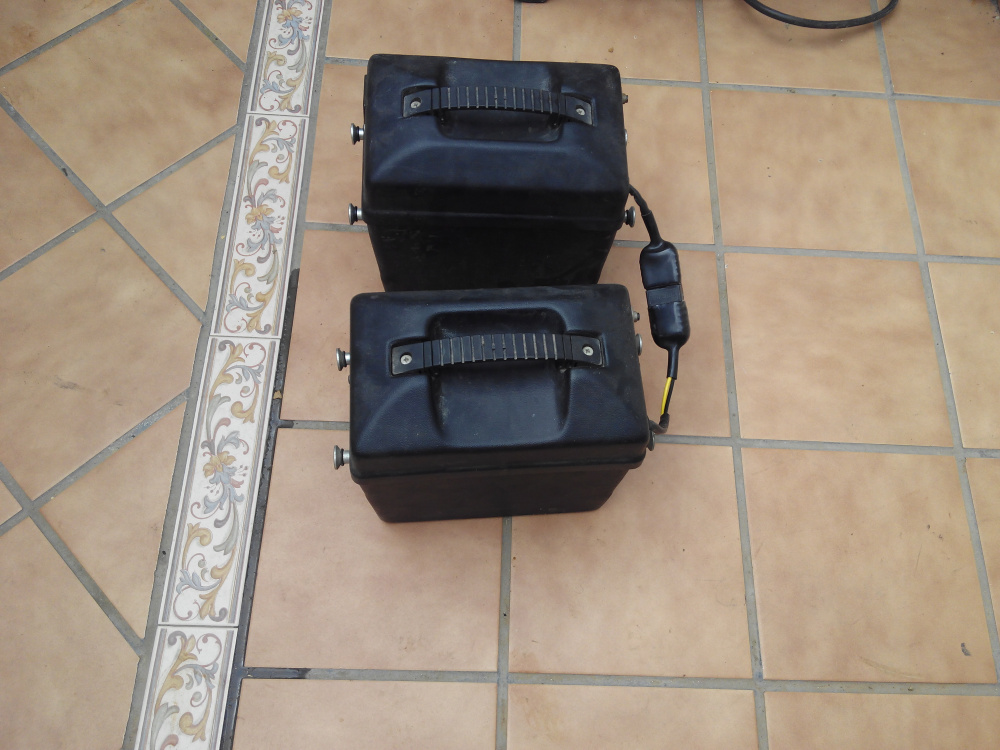

Hello.
I'm considering adopting Lifepo4 batteries.
The main obstacle is how to fit these batteries into my chair.
Ideally, a metal box.
How have done you?

Postby martin007 » 08 May 2019, 00:11
Boxes...

Re: Make Lifepo4 cell box
Postby martin007 » 08 May 2019, 15:11
What size are the lead bricks?
30 ah - 33 ah
I have boxes on my small scooter but would do away with them if convert it to lithium. Simpler
What alternative do you suggest?

Put all 8 cells in a single box. Buy or make the box.

Postby Scooterman » 08 May 2019, 18:33
Down the road, I think you may run into connection problems with two boxes. Especially if you sometimes remove boxes to transport chair by car.
Just my opinion....
Postby Burgerman » 09 May 2019, 01:17
If both are 24V boxes, and both connect via andersons, then it will run on one or two boxes, and no connection issues with those. The charge cables will be sub D connectors, one on each box.

Postby martin007 » 10 May 2019, 19:20
Does anyone know if those boxes are used outside the field of powerchairs?
Do those boxes have a technical name?
Posts: 4105

Postby shirley_hkg » 07 May 2020, 04:46
You can convert / modify the 2 boxes into ONE easily , with 3 thin sheets of PVC boards glued by silicon sealant.
You then have a better compartment , or even more height to accommodate more Ah. cheers
Postby Irving » 07 May 2020, 11:20
Would be good to have pics of boxes in chair to get feel of layout. Personally I'd ditch boxes, make new 4S packs out of largest cells in space available and fabricate simple U-shaped hangers to match the fixing points - maybe just webbing straps would suffice since LiFe packs are much lighter...
