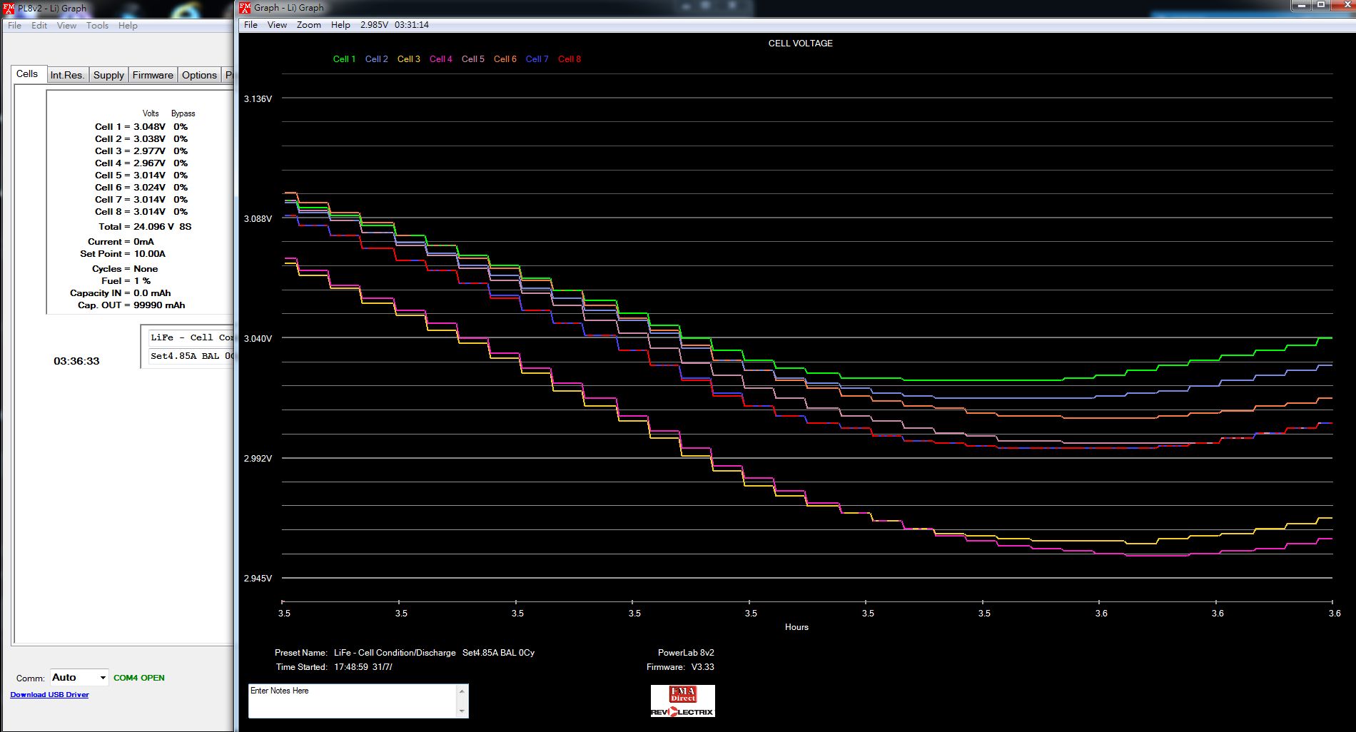

Postby shirley_hkg » 01 Aug 2019, 13:04
Bulk discharge stopped with 99,990 mAh.
Cells' actual readings @3.605V - - - 2.98V
101,212
100,971
99,998
99,990
100,511
100,680
100,561
100,606
Posts: 4568
Postby Burgerman » 01 Aug 2019, 13:19
You stopped too soon. The voltages bounced back. Thats not a full discharge. But its close. But you can see that too.
