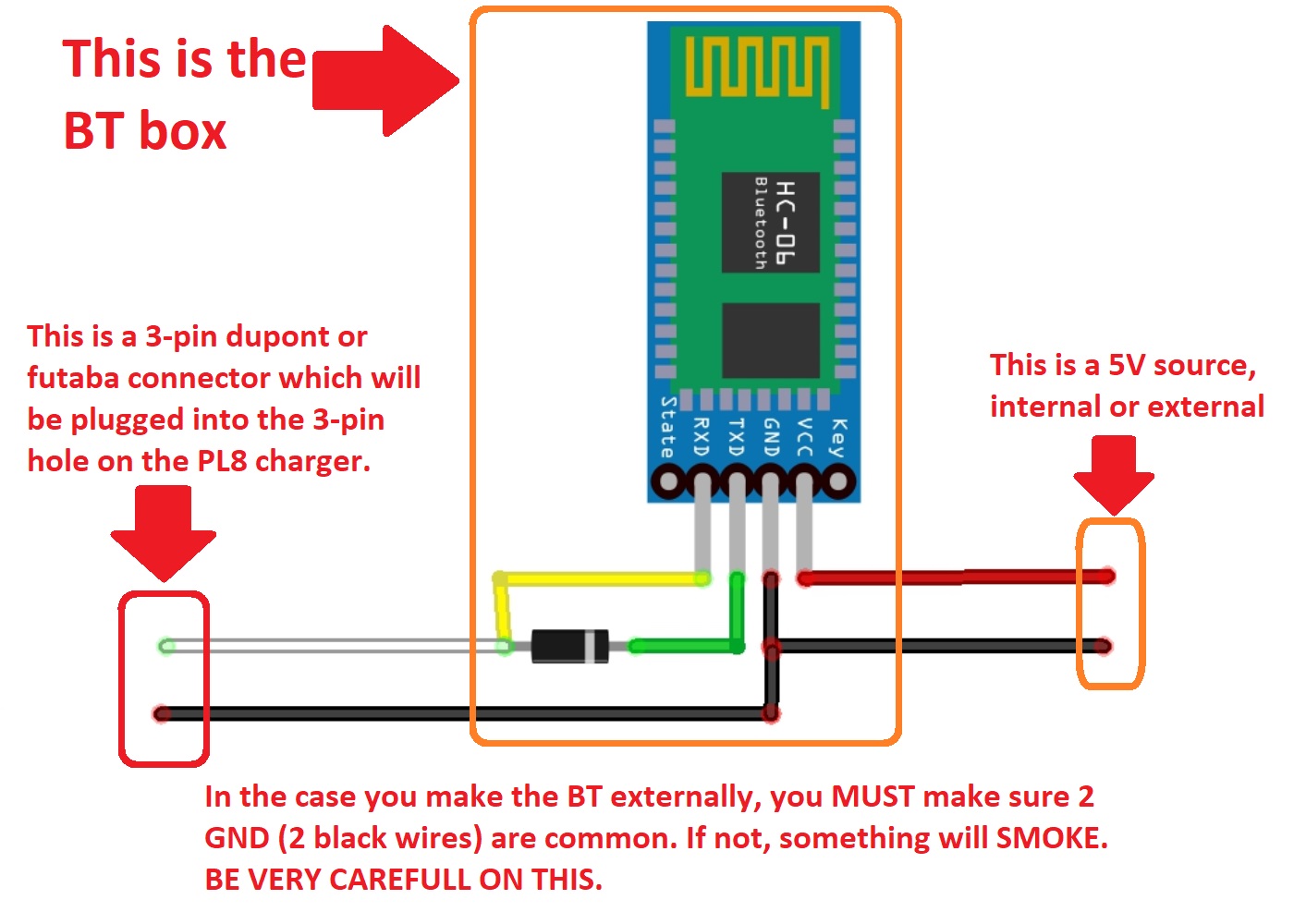

Postby snaker » 24 Feb 2021, 03:00
This is the diagram of the BT internal or external. As you see, components are very simple. Mainly a HC-06 BT module, a schottky diode plus some wires and connectors.

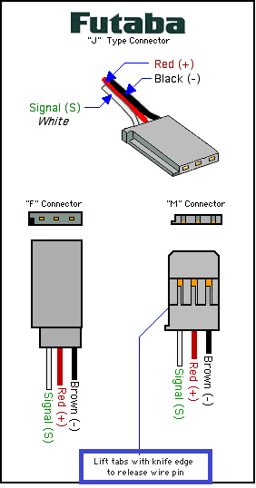

Postby woodygb » 24 Feb 2021, 13:19
Additional info ....The wires can be removed from the plug by simply lifting the tag with a Stanley knife blade or similar.

Postby snaker » 25 Feb 2021, 01:38
Beware of the diode's direction too. Its head (the white ring) must connect to the TX pin on the BT module.

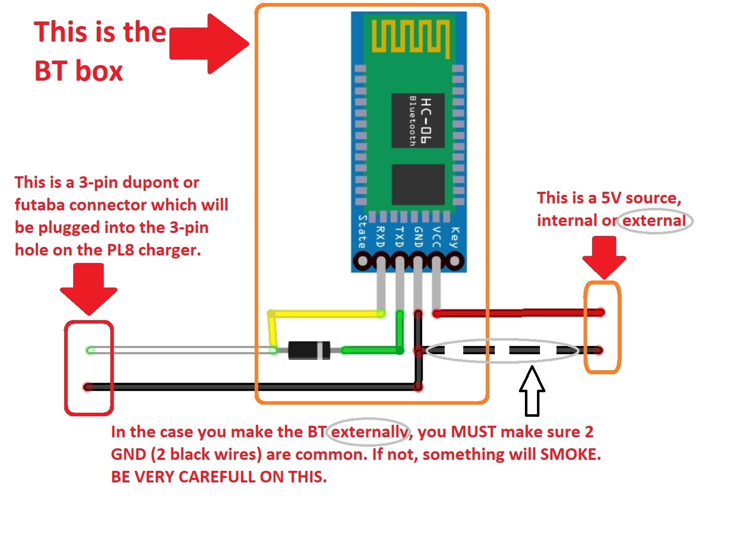

Postby Irving » 25 Feb 2021, 13:54
One major caveat to the diagram on how to connect the BT adapter negative ground (black) wire.
If you are using an external buck (down) converter DO NOT power it directly off the main charger supply unless it is an isolated DC-DC converter. If it is non-isolated, connect the + input to the PL8 + (red) input only and be very careful that the - (black) connection of the buck converter does not come into contact with the - input to the PL8. Better, for safety, use a stand-alone isolated 5v USB charger, a stand-alone 5v USB powerpack, or a 3 x AA cell switched battery holder and do not connect the negative side to the negative power input.
Now, I know there are those that say they've wired it directly and it works, and yes it will, most of the time. But it is a problem waiting to happen...
The negative input to the PL8 goes to a pair of parallel 40A fuses, a MOSFET isolation switch and a high frequency noise filter BEFORE it becomes the internal 0v rail and ground connection on the 3-pin remote control connector. So connecting the BT ground to the negative power input ground bypasses all of that and under fault/overload conditions and/or when doing high-power discharge into a dummy load, that connection can potentially become the main current flow in or out of the PL8 which is almost guaranteed to do some serious damage to the BT adapter, the PL8, the wiring and/or the local environment...
