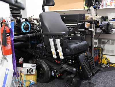

On most chairs the seat lift modules are pretty similar. And about 2 inches thick. So on most chair it means that with group 24 batts, the seat does sit 2 inches (or at least 1 inch higher). And on some cairs that can be lowered but at the cost of battery size being group 34 as they are the same but an inch shorter in height. And lower capacity. And seat depth, dump, and width is usually just a relatively quick spannering job!
I am presuming the Dietz chair is similar?
Posts: 69775
Re: Dietz-Power wheelchairs
Postby rover220 » 19 Mar 2021, 20:32
Burgerman wrote:On most chairs the seat lift modules are pretty similar. And about 2 inches thick. So on most chair it means that with group 24 batts, the seat does sit 2 inches (or at least 1 inch higher). And on some cairs that can be lowered but at the cost of battery size being group 34 as they are the same but an inch shorter in height. And lower capacity. And seat depth, dump, and width is usually just a relatively quick spannering job!
Yes pretty much.
Steve's is set on the highest of 4 positions to help footplates clear the 10inch castors. Will be able to drop the static height down no problem and tweak footplate position if it results in clashing. No need to remove lift module.
Just nuts and bolts to tweak. Always going to be required when going from a 20yo plus chair to something new.
Posts: 1935
Postby Burgerman » 19 Mar 2021, 20:37
Maybe those 8 inch x 3 inch wide "smooth" tyres I used on that q700r will give him a couple of inches extra.
Posts: 69775
Postby rover220 » 19 Mar 2021, 20:38
Burgerman wrote:Maybe those 8 inch x 3 inch wide "smooth" tyres I used on that q700r will give him a couple of inches extra.

Postby Burgerman » 20 Mar 2021, 00:02
The smooth caster tyres are 8x 3.00 - 4 and thats what I meant. Those are 2 inches smaller diameter giving the ability to move the footplate back.
Thats 8 diameter, 3 wide, fits a 4 inch caster rim (or: 8x 3.00 - 4) https://www.terraintyres.co.uk/turf-law ... mooth.html
The 3.00 x 8 are the rear tyres. Although mine are 120/70-8.
My bad, I thought you meant the smooth castors then noticed you'd put 3.00-8.
Kenda 8x3.00 - 4 caster tyres. 2 inches more footrest clearance.

Postby Burgerman » 20 Mar 2021, 19:11
Its fine even without dropping the rear with a removed spacer. Its not a huge difference. The tyre may be 2 inches smaller but the front sits 1 inch lower. You can usually adjust the suspension to have a little less preload (height) at the rear if it really needs it. Those tyres - esp the carlisle branded ones are very tough. Probably a good candidate for not getting a puncture. But will give a harsher ride that the 10 inch ones you have.
Take a look at the pic of the q700r above. That has bigger rear tyres AND smaller front ones. Its not had any suspension changes or spacers moved or anything. Yes it leans forwards a fraction (maybe 2 degrees?) like a dragster! Its not critical at all. Works just fine.
