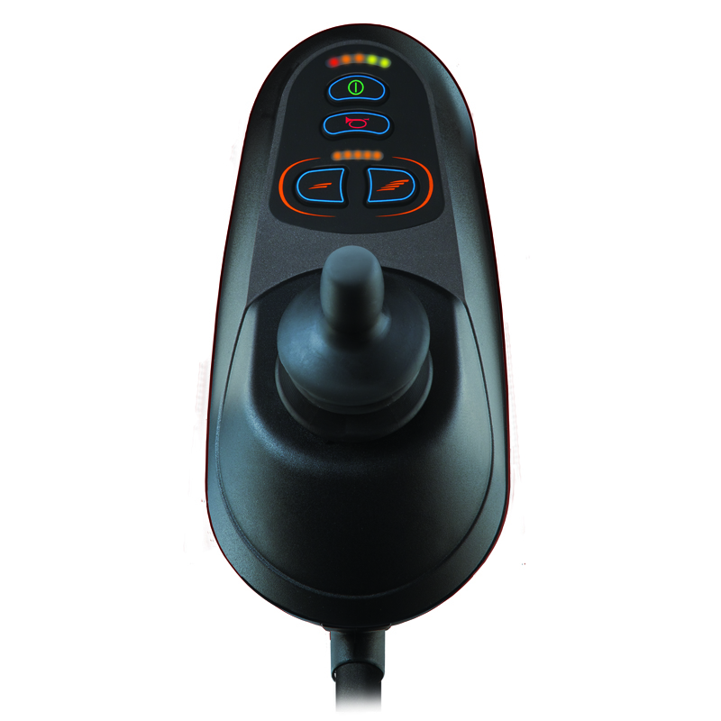

Postby nani13 » 15 May 2021, 06:34
Hi, I am currently a Year 3 Student doing a Final Year Project that requires us to hack the P&G VSI 50A controller and I was wondering anyone here has the schematic or joystick connect for it. I was also wondering how to hack the controller as we are replacing it with another control.

In a nutshell, I am trying to hijack the signal of the controller so I can replace it with a sensor. What this project is trying to do is help people with cerebral palsy gain motorized control of their powered wheelchair, and in order to do so we have to replace the joystick as people with CP have lack of hand movement and control so replacing it with an alternate controller will help them learn how to drive a wheelchair with more ease and convenience. So I am trying to find either the schematic of the controller or joystick of P&G VSI 50A in order to hijack the signal and replicate a similar signal to the alternate controller.

The VSI almost surely uses one or another serial protocol to communicate with the rest of the system and hacking that may be a tall order. It may be much simpler to make an adapter that connects to the same leads as the joystick pot and mimics the joystick output. Do a search here for postings by woodygb to see how he's done that for using RC controllers to mimic other joystick controllers - yours will be similar. Years ago I had done something similar just using 4066 ICs connected to head and foot switches to select among a set of simple voltage dividers, but Woody's way is a much more flexible solution.

I would agree w/ Lrobbins about the easiest method being to mimic the joystick.
I'd also point out that while I am not sure what is available for the VSI series (which are pretty much the 'lowest grade' controllers for use on low-end chairs, w/ 50A being really low-end) there are a lot of existing alternative input devices available for the better series of controllers like R-net, etc....
While possibly interesting as a 'learning exercise' I'm not sure how practically useful this would be as a project.... It seems likely to me that a CP (or other disability) user with enough functional challenges not to be able to use a regular joystick is probably going to be needing a more sophisticated (i.e. multiple seating controls) rehab chair than the very basic sort of chair the VSI series controllers are designed for.

Postby foghornleghorn » 24 May 2021, 10:55
The newVSI controller pictured is an all in one brain and joystick pod. No talking backwards and forwards from it to a separate controller.
I'm guessing you are in Singapore where this appears to be the commonly used control.
The simplest version of what it sounds like you want to achieve is 4 buttons:
1. Forward - both motors forwards
2. Backward - both motors backwards
3. Rotate the front of the chair to the right - left motor forwards
4. Rotate the front of the chair to the left - right motor forwards
I would have all buttons only work by themselves. Push one for a command to happen. Push two or more and nothing happens.
It may be better to have the left and right aiming send a time limited burst of power to the motor so one click turns 5 degrees for example rather than having the chair rotate forever if the button is held down.
One thing you need to be very aware of in an example where the driver doesn't have full ability is that an electric wheelchair can exert a lot of force on the person in a situation where they catch their leg against furniture or the wall. Broken bones happen very fast and heal very slowly.

No, you don't need to use RC. What you have to figure out are the X and Y voltage swings of the joystick pot inside the controller and make a circuit that mimics that. (One exception to this that I know of is the Dynamic Shark series which uses an digital rather than analog joystick pot.) That will be MUCH easier than trying to hack the serial digital signal (which may be of any one of a number of different protocols with a proprietary "dictionary" for the messages).

I might add that once you figure out how to immitate the stock joystick dc voltage swings, reference voltage etc, to be able to control the chair without the joystick. That you will need to be able to interface with the your new control system, then you will come across several new problems.
ONE of these is that that in order to travel in straight lines and go where intended, rather than influenced by where the casters are pointing or need to change position, or influenced by carpet pile, or lateral slopes outdoors for water drainage on footpaths and roads, that you will need either a finely tuned gyro system, or a wheel encoder setup. Because it certainly will not go straight just because you tell it to do so. The stock motor load compansation algo isnt capable of this. The R-net system you should have started with, already has all required modules and firmware/software available to do this as part of its more advanced system. These are very much required if your system is to be any real help to an end user with only 4 buttons and no ability for steer correction in the usual way. Dont believe me? Try using a MANUAL wheelchair along a road edge. And THEN you will understand the problem. Right now you dont.
https://www.cw-industrialgroup.com/Prod ... ions/R-net System.
https://www.cw-industrialgroup.com/Prod ... -Interface omni for your speciality input control system.
https://www.cw-industrialgroup.com/Prod ... der-Module encoder module for accurate straight line tracking regardless of obstacles and wheel load.
https://www.cw-industrialgroup.com/Prod ... yro-Module gyro, acomplishes much the same thing.
All the settings and programming of these parts (modules) is built in to the system and can be configured with the OEM level programmer.

I have severe athetoid CP and can use a normal joystick mounted on my right footplate, I can drive the chair with my right foot. The simplest joystick pod for this is the Pilot+ Chin control which has two switch stalks that can be lowered or raised. Some CP users use head switches.
Re: P&G VSI 50A
Postby Burgerman » 26 May 2021, 10:30
What do you mean I am starting with the wrong system? I am starting with this controller as it is BUILT IN and either way I am replacing it with my teammate's DIY control switches. So you recommend me getting this R NET System for steer correction? Is getting this system a must?
Not sure what you mean by "built in". Its a ONE PART system. Its JUST the joystick pod. If you unplug that joystick and remove its two mounting screws then its no longer built in! The whole system is in your hand. So when you say you are replacing it with yours, then theres nothing left! Just batteries and motors. So replacing with yours makes no sense!
The problem with it is that:
1. Its all built into the one component. There is just one board. Theres no seperate power module anywhere.
2. Its super low powered. So much so that it will not likely be able to climb a threshold, or turn in place reliably without the user correcting it with manual control corrections. As such you need a better more powerful system for reliable control.
3. It got zero flexibility. No inputs, outputs or any advanced control programming that would allow use of your switches properly.

Postby nani13 » 27 May 2021, 07:39
LROBBINS wrote:The VSI almost surely uses one or another serial protocol to communicate with the rest of the system and hacking that may be a tall order. It may be much simpler to make an adapter that connects to the same leads as the joystick pot and mimics the joystick output. Do a search here for postings by woodygb to see how he's done that for using RC controllers to mimic other joystick controllers - yours will be similar. Years ago I had done something similar just using 4066 ICs connected to head and foot switches to select among a set of simple voltage dividers, but Woody's way is a much more flexible solution.
Is this it?
