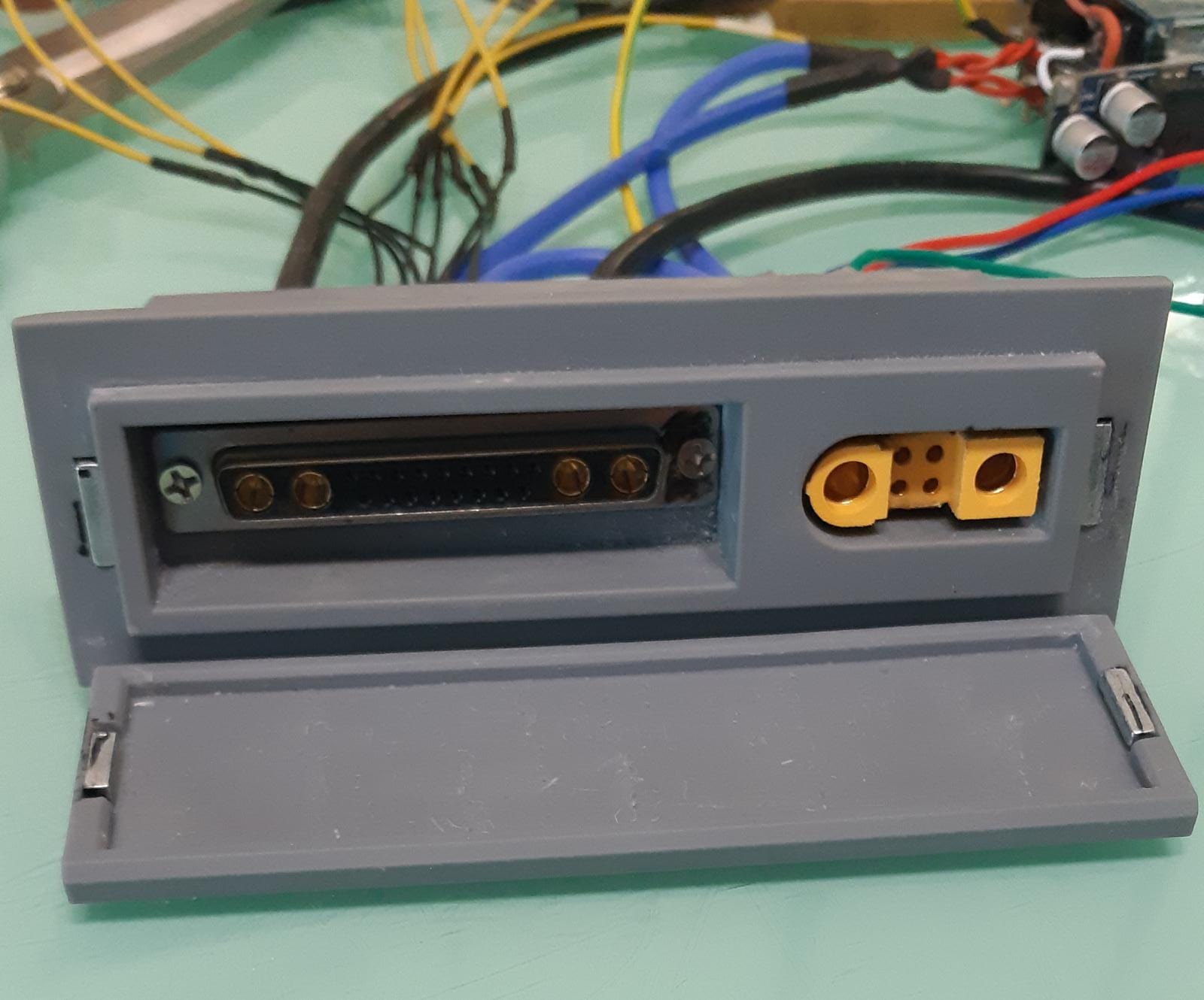

Postby shirley_hkg » 28 Dec 2021, 01:45
Battery box has room left, after 8 of these 230Ah cells.
I'll incorporate both PL8 & BMS charging into my next pack.
Dsub + XT120 connectors.
Posts: 4656

Postby shirley_hkg » 28 Dec 2021, 16:07
My BMS need the 4 signal pins that SB50 couldn't provide.
