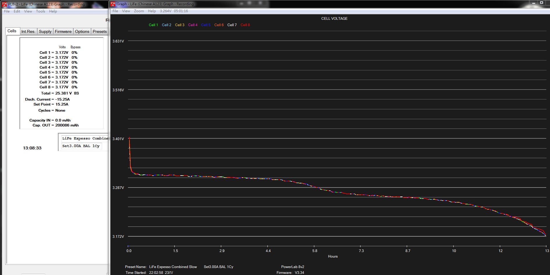

Doing a capacity test of my CATL lithium pack, @3.00V.
Posts: 4656
Postby Burgerman » 24 Jan 2022, 05:40
Those look closely matched.

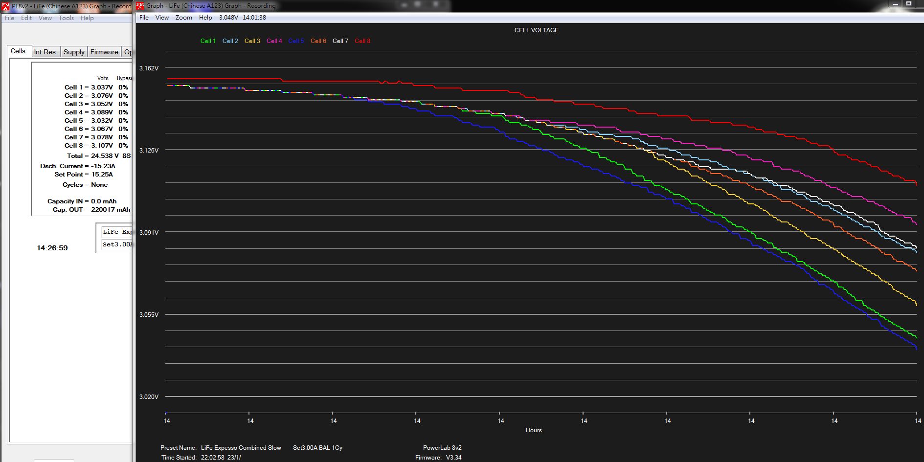

Postby shirley_hkg » 24 Jan 2022, 05:51
cheers
Almost end now. Same as last pack that I did for a friend.(220Ah)
{The PL8 is new}
Paid £500 including shipping for these 8 cells. drunk2
drunk2
Posts: 4656
