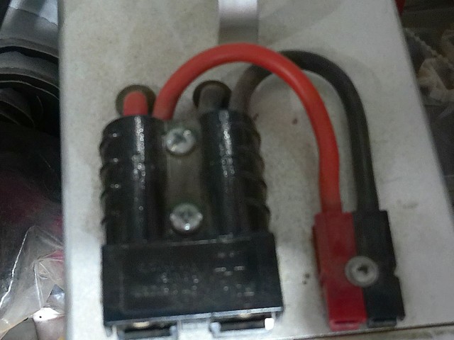

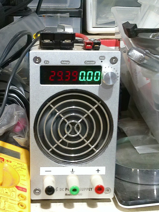

Postby ex-Gooserider » 06 Nov 2024, 23:52
Promised photos of how I did Andersons on my early model ZXD I also cut out the three leg thing in the front panel, so that I could get rid of the restrictive intake screen and replace it with a wire guard. I didn't care for the way they laid out the original banana jacks, so I rearranged them...
front view
top view
close up
The cable is AWG 10 superflex going down to the bananas
Postby Burgerman » 07 Nov 2024, 02:17
You took a thing of beauty or at least neatly stylishly engineered and made it "redneck" build. :cussing

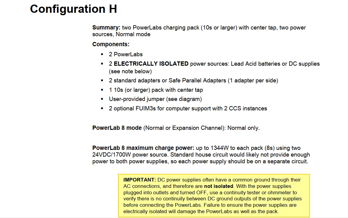

Postby c500user » 08 Nov 2024, 12:42
I don't know the PL8 as well as you do and have never used two is series, so I looked up the manual.
As you can see, to be able to use 2 power supplies for 2 PL8s that are connected in series, the power supplies need to be isolated (which is what I need too).
As you can see in the yellow box, they warn that DC power supplies are often not isolated, which is the same reason why I asked my question in the first place.
The fact that your ZXDs allow you to work with 2 PL8s in series confirms that the ZXD models you have are isolated. What I would like to have confirmed before ordering them is if the newest ZXD that shirley sells at the moment have floating outputs. Shirley, are you able to confirm? If so, please let me know the price for two units sent to Australia, either in HKD or EUR.

Postby Burgerman » 08 Nov 2024, 12:53
I know all that. I know that they are isolated. I halso read the PL8 manual repeatedly. And the new ZXDs, old ones, and everything in between use the exact same internals.
If they were not free floating, and isolated from AC that means that when you connect to any 110/120VAC that is reversable then the negative / neutral would be live! So they have to be fully isolated. Ground (ac wall) goes only to the case. It isnt connrcted to the negative internally.
Server supplies for e.g are not isolated grom ground. They have the neg output connected to chassis ground. And so to Earth in the plug. Two in series = smoke...
You are safe to buy.

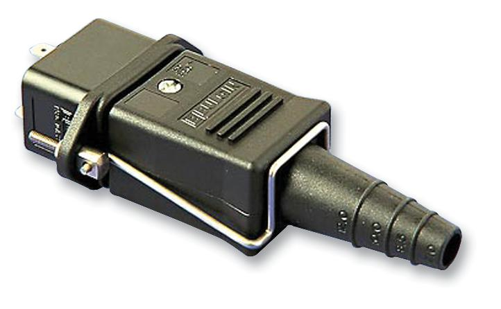

Not the first time I recall.
Have to find a way to secure the AC plug.

I can't find a link to one but the respirator I use has a DC connector that has a wire lock that prevents it from disconnecting.

Postby woodygb » 12 Nov 2024, 13:23
martin007 wrote:I have a problem with ZXD2400.
It makes a "click, click, click", but it doesn't start.
Any idea what the problem might be?
Like this?
Postby Burgerman » 12 Nov 2024, 13:36
I threw away the stock one, used a different one from ssomething else. Fits better.
Posts: 70445
Postby Raro » 12 Nov 2024, 14:58
woodygb wrote:
Like this?
That's exactly what I was referring to. You can also put a fixed one as John says.

Postby ex-Gooserider » 19 Nov 2024, 01:39
Burgerman wrote:You took a thing of beauty or at least neatly stylishly engineered and made it "redneck" build. :cussing
No - redneck is leaving the added plugs dangling... I screwed them down securely, and made it a more beautiful thing because it does what *I* want it to do!

On my older ZXD, with three banana jacks, + and - are isolated, but the ground jack connects to the fancy case, and so does the earth ground from the AC outlet...
Postby Burgerman » 19 Nov 2024, 03:18
Thats exactly as it should be. The grounded case is designed in all AC metal devices to keep the case that you touch at 0V (earth/ground) in spite of any possible fault condition. Anything that tries to make the case live trips or blows a fuse.
The reason for vaving a ground (green) 4mm connection on the front of the case is so that you always have a grounded connection for testing, reference, leakage testing etc.

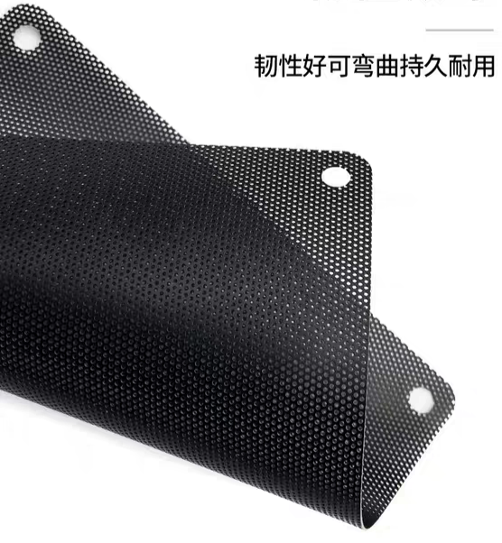

Postby shirley_hkg » 23 Nov 2024, 13:34
youtu.be/T8KwmK7jiho
BM, this is the same fency aluminum case as yours, except that it lacks Anderson SB 50.
I'm afraid that I might have to stick with the stock fan grill.
Postby Burgerman » 23 Nov 2024, 13:42
Grill?
Posts: 70445
Postby shirley_hkg » 23 Nov 2024, 13:57
Your's will have SB50
cheers
Postby Burgerman » 23 Nov 2024, 14:15
Those are restrictive. Means fan runs faster and so more noise?
Posts: 70445
Postby shirley_hkg » 23 Nov 2024, 15:02
Maybe not. Pore is bigger.
How about get rid of it ?
Postby Burgerman » 23 Nov 2024, 15:07
Dont know. Isnt there something like what they used in that picture? If not send as it is and I will swap later.
Posts: 70445
