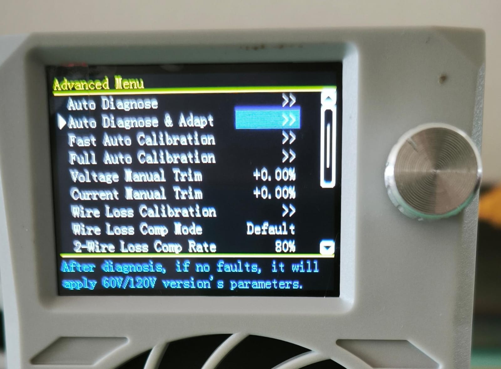

emilevirus wrote:I just received mine. It won't go past 25A. Any idea why?
I received the 120v version. It goes up to 120v and 25A
Go to Advance Menu and run
(Auto Diagnose & Adapt)
It will check the hardware and assign itself accordingly.

Postby emilevirus » 31 Dec 2024, 17:46
All good. I ran the calibration and it detected 60v50A.

Postby Burgerman » 02 Jan 2025, 22:18
In FACTORY menu
AUTO DIAGNOSE
Try it. Finds any faults, doesent fix anything. DISCONNECT ANY BATTERY OR DEVICE.
AUTO DIAGNOSE & ADAPT
Same thing but configures and sets up everything as stock. And you lose all customisation and personal settings.
ADAPT IN ADVANCED MENU
Moves this stuff to the advanced menu
4 WIRE CABLE USABLE
On the rear is a black and red 4mm banana connection sockets. This enables/disables them. And makes the settings for this available in the ADVANCED menu. It allows you to run 2 extra (thinner) sense wires to get totally accurate Voltage at the actual battery terminals. It corrects for cable and connector resistance losses completely.
VOLTAGE LOWER LIMIT
Sets lowest voltage that a user can set.
VOLTAGE UPPER LIMIT
Sets the highest voltage its possible for a user to set. So if you only EVER charge powerwheelchairs and never need other settings you might set 26.60 and 29.40 Volts as your minimum and maximum. Makes it faster to set up and helps garantee no errors.
CURRENT LOWER LIMIT
As with Volts above. But lowest current a user can set in Amps.
CURRENT UPPER LIMIT
Sets the highest current a user can set. So to save time in settins up, and to be sure its impossible to fry your Joystick XLR input you could set a minimum of say 3A and a maximum of 12A.
POWER LOWER LIMIT
Sets the miniup power a user can set. In WATTS. No idea why you would need that!
POWER UPPER LIMIT
Sets the maximum allowable Watts. Maybe to protect an AC supply or generator? No idea. Remember this is output watts. Input watts will be 10% greater.
FAN SETTINGS. - MAKE IT SILENT!
If you watch at idle, or very low current, with a torch (flashlight) you can see the fans rotating.
I set FRONT FAN START to 0%, which stops the fan and then gradually increased the percentage to the point where the fan JUST began to rotate and then I added 1% extra. I ended up with the front fan turning and starting very reliably, but turning so slowly that you can count it. Totally silent.
Note this setting WILL be very slightly different for every unit, so best to check your own.
And in the case of mine (with smaller front fan, larger screen) this final figure is 28%.
I did exactly the same for the rear fan, and this figure ended up at 30%.
The fans will STILL ramp up as needed if you start hammering it at high Amps. But for charging at 12A next to your bed its as close to silent as doesent matter! Also means litle dust gets drawn in. Doesent even get warm.
VOLTAGE FACTORY TRIM
Use ACCURATE voltmeter to set voltage - dont bother its super close already.
CURRENT FACTORY TRIM
Use ACCURATE current meter to fine tune current. Again dont bother as its not critical.
VOLTAGE MANUAL (USER) TRIM
Use ACCURATE voltmeter to set voltage - dont bother its super close already. (I added +0.2)
CURRENT MANUAL (USER) TRIM
Use ACCURATE voltmeter to set current - dont bother its super close already.
START-UP SCREEN
2 options. Manufacturer logo/Progress. I set this to Progress as it shows a boot progress bar at start up.
DC POWER MODE USABLE
On settings at top, allows this to be visible or not.
LI-ION MODE USABLE
LEAD ACID MODE
On settings at top, allows this to be visible or not. You may disable the other two, if you only charge lead batteries. So no mistakes.
PFC WORKING STATE
No idea.
EEPROM EDIT
Dont!

Postby Burgerman » 03 Jan 2025, 17:26
Well for the 2nd banana here's the simpler ADVANCED menu.
AUTO DIAGNOSE
Looks for faults, changes nothing, disconnect battery as may send high voltages while testing.
FAST AUTO CALIBRATION
Calibrates a few voltage settings. But disconnect battery as may send high voltages while testing.
FULL AUTO CALIBRATION
Calibrates a few voltage settings. Tests cable resistances, and losses and sets current calibrations as well, needs you to short output. But disconnect battery too as may send high voltages while testing.
VOLTAGE MANUAL TRIM
Allows you to fine tune the voltage measured and seen on screen ifyou have a calibrated multimeter. It was pretty close anway on mine.
CURRENT MANUAL TRIM
WIRE LOSS CALIBRATION
What it says. Requires you to short the wires on your charge lead. Otherwise it gives a estimate of a fixed 8mOhm.
WIRE LOSS COMPENSATION MODE
Default (8mOhm), 2 wire requires you to set the calibration above, 4 wire requires you enable 4 wire in the MANUFACTURING menu and use a additional cable and the rear red/black connectors. So theres 3 options!
VOLTAGE ZERO THRESHOLD
Sets the display to ZERO if you see for e.g -0.02V when no battery connected. It just means you need a tiny voltage plus/minus to shift it away from zero.
CURRENT ZERO THRESHOLD
Sets the display to ZERO if you see for e.g -0.02A when no battery connected. It just means you need a tiny current plus/minus to shift it away from zero.
And I ignored the obvious ones.
