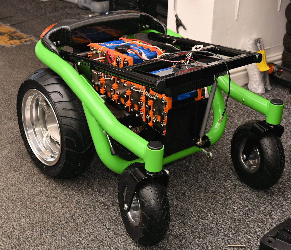

Battery fits... Thats a work of art!
Now sort wiiring, lights, and the fan controlled by the recently installed thermostat, and make a footrest...

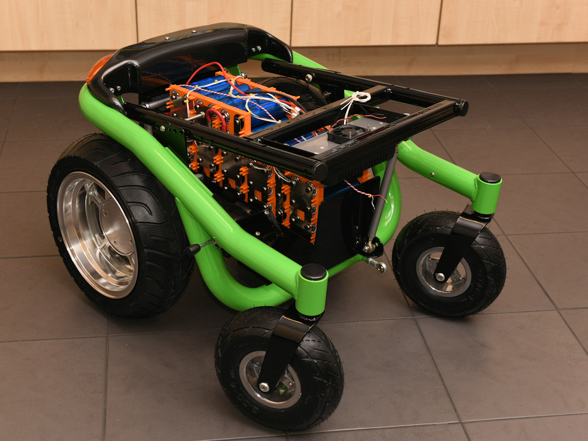

Postby Burgerman » 10 Feb 2016, 23:16
Better pics
Seat isnt bolted on, just loose. Wires all over the place. But you get the idea. Waiting for seat, and need to build a footplate. Then ready to go.
http://zoomability.com/zoom/ this gets 25 miles with just 950 watt hours. Mine isnt as efficient, as its not brushless. But I have 3200 watt hours... So should get 50 to 60 miles on a smooth pavement.

Postby Burgerman » 11 Feb 2016, 14:06
Seat plate on temporarily.
You can see the 100A PG power module here. The one I fitted a fan thermostat switch inside. This will be
fan cooled above 45 degrees C.
iI always get the flat seat plate powder coated too. Leaving it super glossy. Cushion (Jay2) is held in place via VELCRO. This seat plate will have 2x 2 inch wide velcro strips added. But first we need to wait for my car seat back to arrive...
Battery sides will be covered in 1mm black plastic sheet, slid into the base to hide the cells and wiring. You will only see the blue ones at the front.
LED 10 WATT headlamps (4x 25mm Diameter to be added) and they are as good as a car headlight, and really small!
