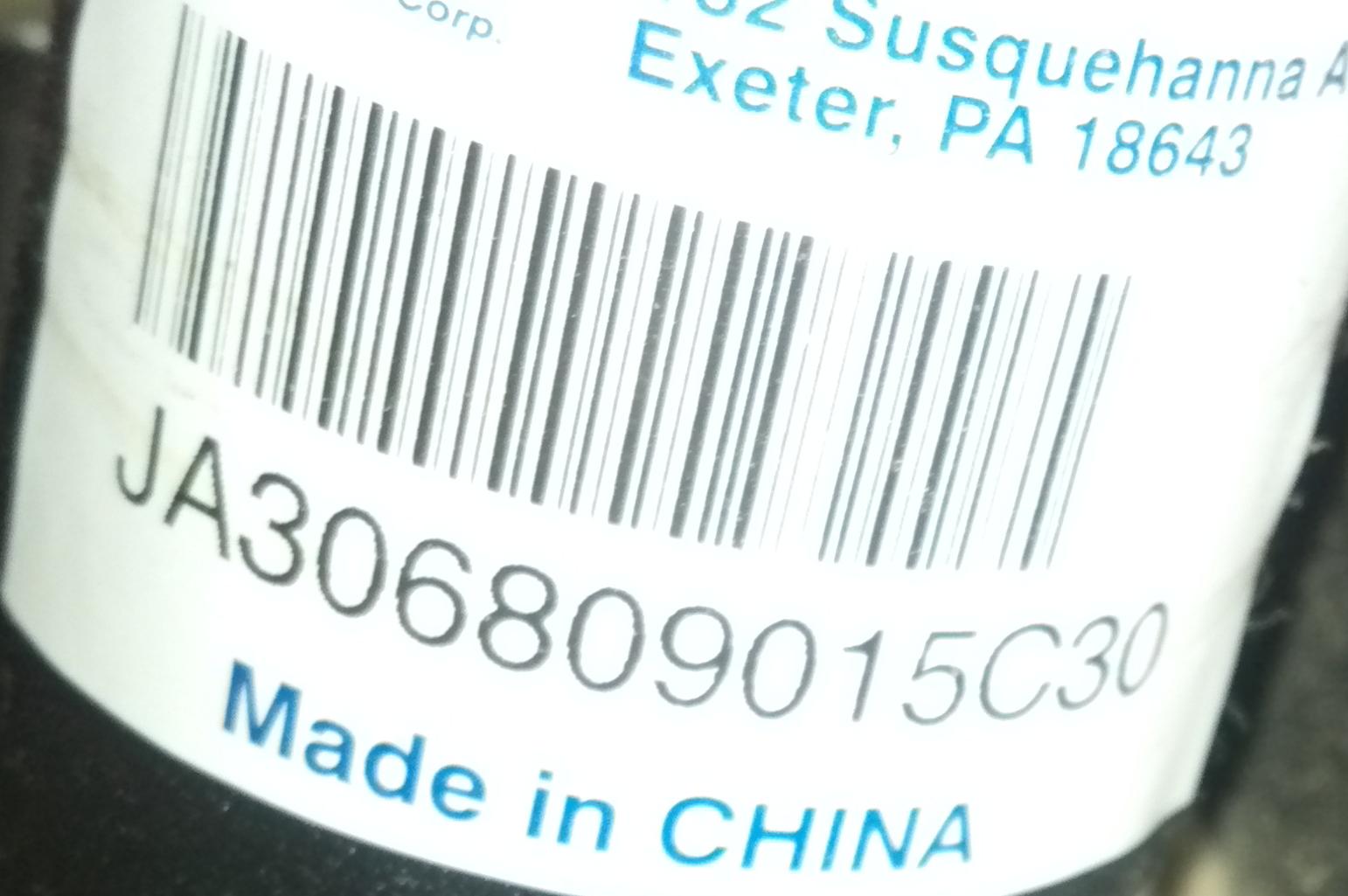

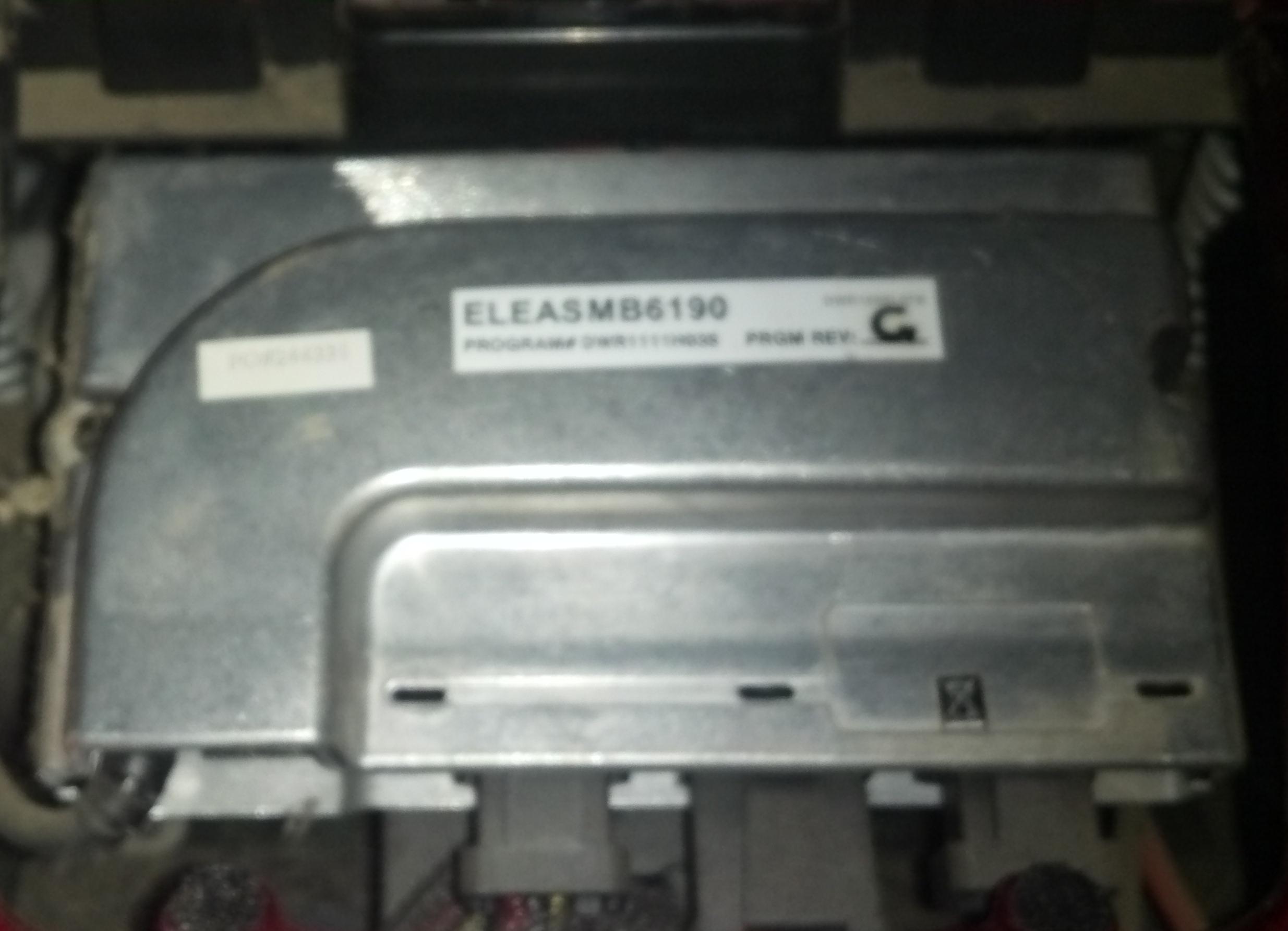

Postby BobBoyce » 06 Sep 2016, 10:39
I had to do a bit of moving stuff to get at it, it's essentially being used to hold boxes (stacked in the seat) and store paperwork/mail in the seatback pocket. The label on the side is Jazzy Select GT. I popped off the rear battery cover and found a serial number sticker on the rear of the seat mount post, JA30689015C30. I popped off the front cover and found the controller cover, label reads as follows. ELEASMB6190 and DWR1235L279 on top, under that is PROGRAM# DWR1111HO35 and PRGM REV: G
Here are photos, not the best but what I was able to get with my phone in a dark bedroom at about 5 AM
Jazzy Joystick
Jazzy Charge Port
Jazzy Serial Number
I was going to add another photo but limited to 3.
Bob

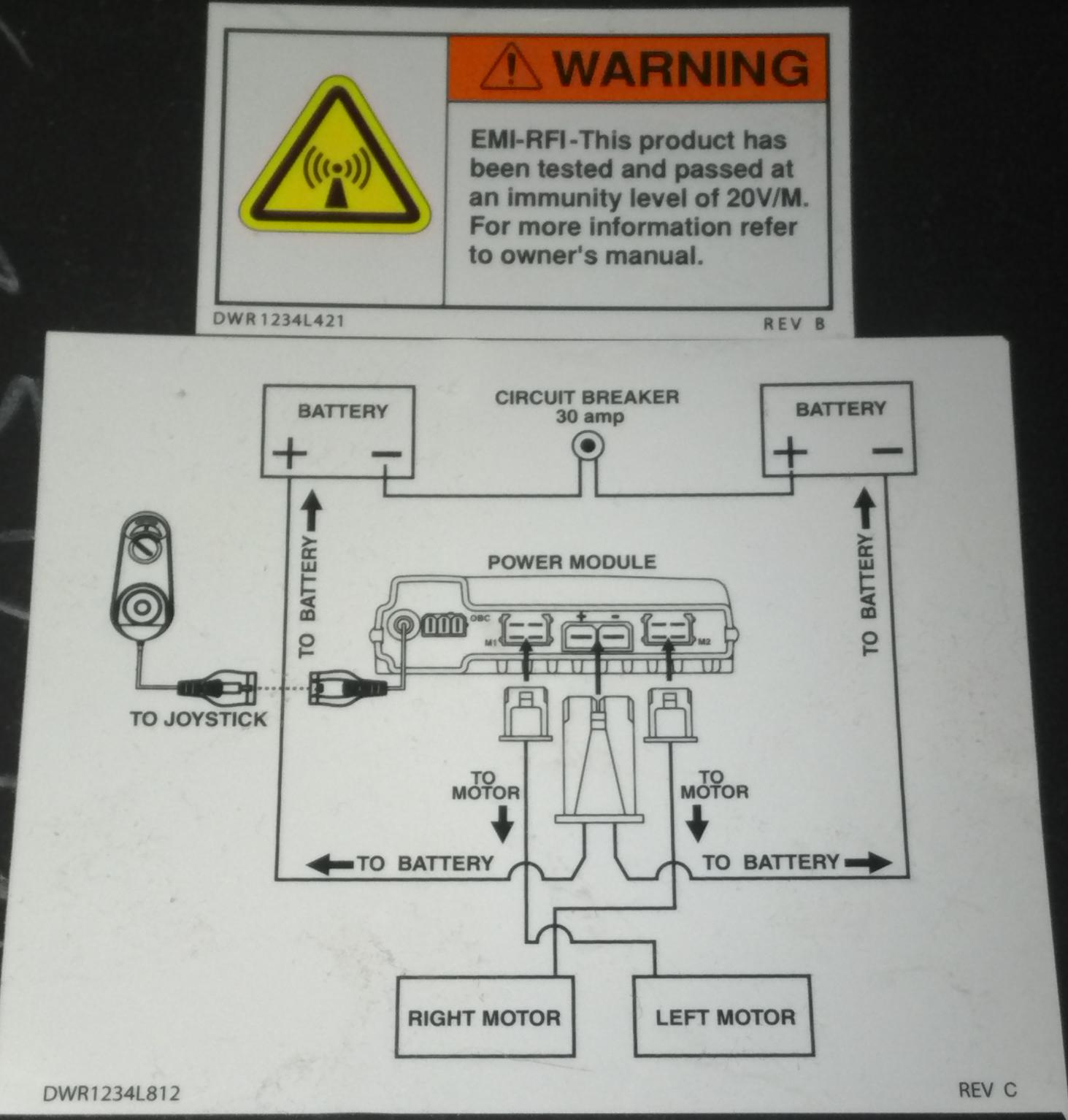

Postby woodygb » 06 Sep 2016, 10:46
Penny & Giles GC joystick Jazzy select
It is a US version of the VR2.
Postby BobBoyce » 06 Sep 2016, 11:00
Ok, here are 3 more photos
Jazzy Controller Top
Inside of front cover
