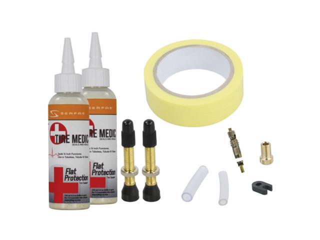

They didnt have 13"x3 or 3"x8" tubes so my good friend Matt used liquid latex (its not slime) in the tube its what they use on tubless tires.
Left the nail in and said roll! So I ran around the shopping mall and back and its working great. It took 5 min tops.
He said the bicycle offroad and street racer market have all gone tubeless and cant understand why mobility industry still uses solid tires that takes the street shock and transfers the energy to the user or worse still uses tubes and risk getting flats for customers that need the softest ride possible.
He said for someone like you or I that roll a lot you could put a small kit together and put it in a back pack.
If you get a flat just remove the steam pour in the latex put the stem back in a use a portable canister to get air in and roll!

nice - glad it worked out for you - all this is making me nervous now and maybe i made a bad choice - i didnt even mount them yet - what can i do - i am not going to invest more in that chair - but i started it and if anything - i will get the inner liners to add - then the tube and slime and thats it - after that - nothing more i can do with that setup -
other chair - i can do the tubeless rims when shirley is ready for me to pick out a set etc, - no rush - once hes done with helping the others - i have a while to go before i get it complete with adapter i am sure - the plus side - i cant complain much with the 646se and foam tires - the ride is actually soft to me - could be suspension and foam could be softer who knows - i got the itch to go to black tires and thats how it all started -
so if i can end up with a nice tubeless rim - black tire and then add the slime or what ever - would feel better - so now your going to leave it that way with the stuff inside ?
i also read - not sure where - that some sealants could eat the rim ? over time - slime heavy duty kind - now thats another thing to think about -

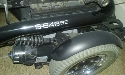

BM - the tire you have on your Green Chair - that looks like a nice tire - not so high tall past the rim - would i be able to get a tire like that on the tubeless rims i get from shirley at some point ?
that tire looks like it can clear the fender and i wont have to remove it - by the way - when you got sick there - did you send it my way ? i feel sick the past 3 days and not much better today - havnt been this way in years - even my worker shes sick also - we both sick - fever - chilly - cold hot - etc,

Aim at the wheel and fender . Take pics that let us see the room you have in there . You may have worried TOO MUCH . :?

Theres enough room.

Burgerman wrote:Theres enough room.
i will try taking better pics tomorrow night - still not feeling too great today - now its snowing here - i called my mechanic - emailed - he wants me to call him when i ready to talk about the adapter etc, - i know he can find someone to do it -

Theres enough room.
There IS enough room...

Postby expresso » 07 Jan 2017, 18:16
if the height of the tire dosnt change - then yes theres room for the fender also - i dont mind if its wider by 1/4 inch etc, - as long as it goes outward away from the chair frame -
a 10 inch rim gives alot more options in tires and rims but that size would give me issues for sure - at first i figure i do 10 inch and gain speed or why do it - but i changed my mind now - i want it as simple as i can do it - if its a bit wider its ok -
taller its ok also but its easier of i can keep it under the fender -
taller would interfere i believe with the lock down thats welded there - i use that for my charge cable - thats close - the way i look at it - with the adapter and rim - it should bring the tire out a bit anyway
