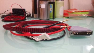

Postby shirley_hkg » 21 Jan 2017, 11:48
Finally , the first charge lead is made . It was very much time consuming than expected .

Postby expresso » 21 Jan 2017, 16:34
shirley_hkg wrote: Finally , the first charge lead is made . It was very much time consuming than expected .
Looks nice and you got nice 10 AWG wire also - i just did another one finally as a spare just in case - its consuming thats for sure - 4 hours for me - i double check everything and slow to make sure - mines came out a bit shorter than expected - i must have extended the power wires on the first once i made to match the 36 inch balance cable -
this one i cut the balance cable to match the length of the power wires with the bananas -- which results in the cable being only 2 foot long -
Postby expresso » 21 Jan 2017, 16:39
BM or Any one who done this cable - would you know what size Heat shrink works best to get it over all the cables with the fuses - etc.
turns out the only kind i have that fits over everything is too large - thick heavy walled with glue inside - the others i have are too small - -
what size do you use BM ? 1/2 inch ? 2 :1 ratio ?

its the heatshrink - i think i need one that is 1 1/2 size but not dual walled - normal wall and 3:1 ratio - this way - i can easily slide it over everything and shrink tight enough - but when dry not hard like the dual wall kind which is what i have
i find it much easier to use normal kind with glue - hard to find the sizes i need - again i find kits with a ton of nothing i need -

if i can find the rubber kind here - i get it - or else i find tons of the silicone kind and if its good enough the military - i cant imgaine it not being good enough for a charge cable - which i havnt used any in the 3 cables i made -
but i remember this now - i did want to use something to wrap it around tight a bit - so i can slide the loom over it - etc, - just to make it easier to make - if i cant find rubber - silicone should be more than fine for this purpose -
i plan on making another one - full 36 inch long - and then have to make the female end for the ADD ON - and maybe make another Male end to see if i can use the cell monitor - if it works - just curious - not stressing it too much - my system works fine without it -
