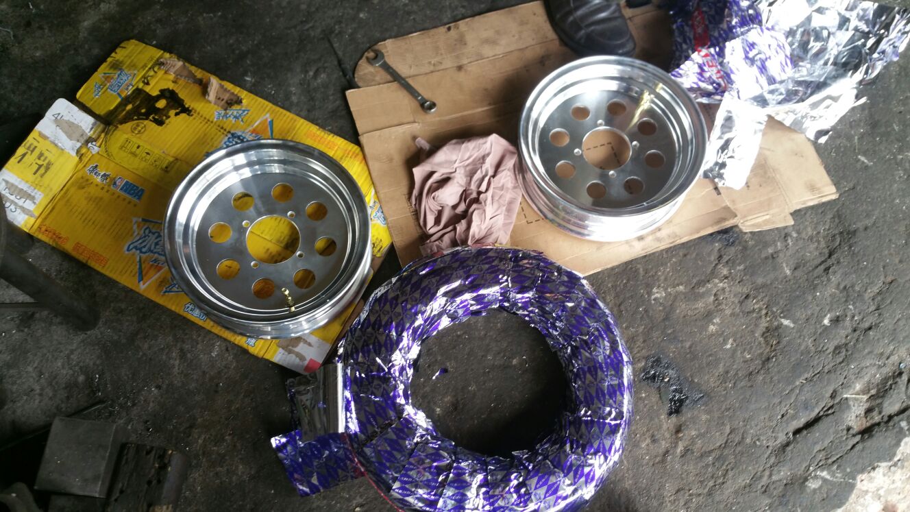

Mounting your 10” type on the rim .

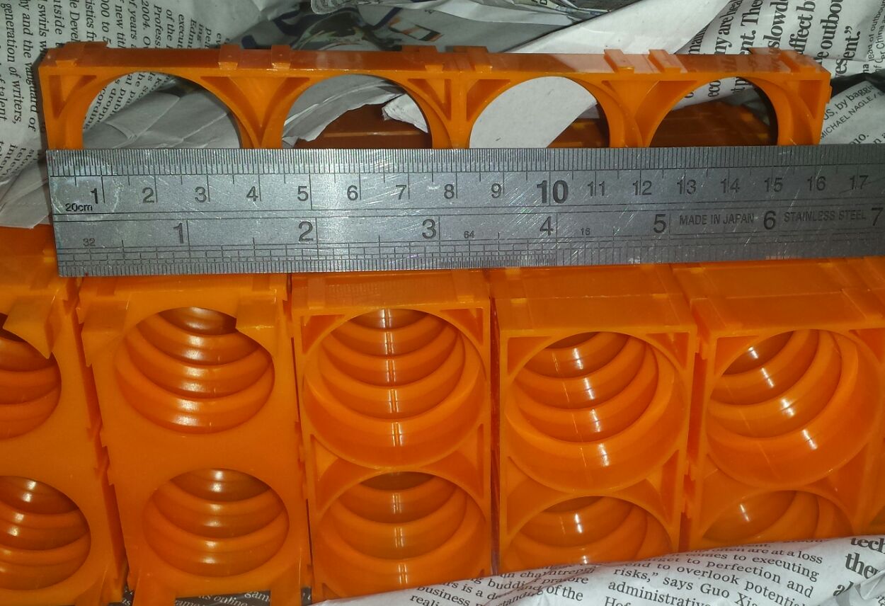

I have 200 of these 38mm holders that are no longer needed .
I can throw in for free ,if you want them .

200? I actually don't have a use right now. Thanks anyway!

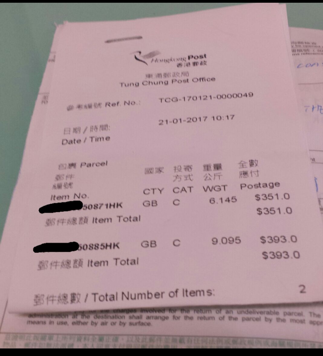

Tyre is heavier than rim .
2 parcels , 6 and 9 Kg .
4 --- 6 weeks to reach UK .
Will PM the tracking numbers to you .
