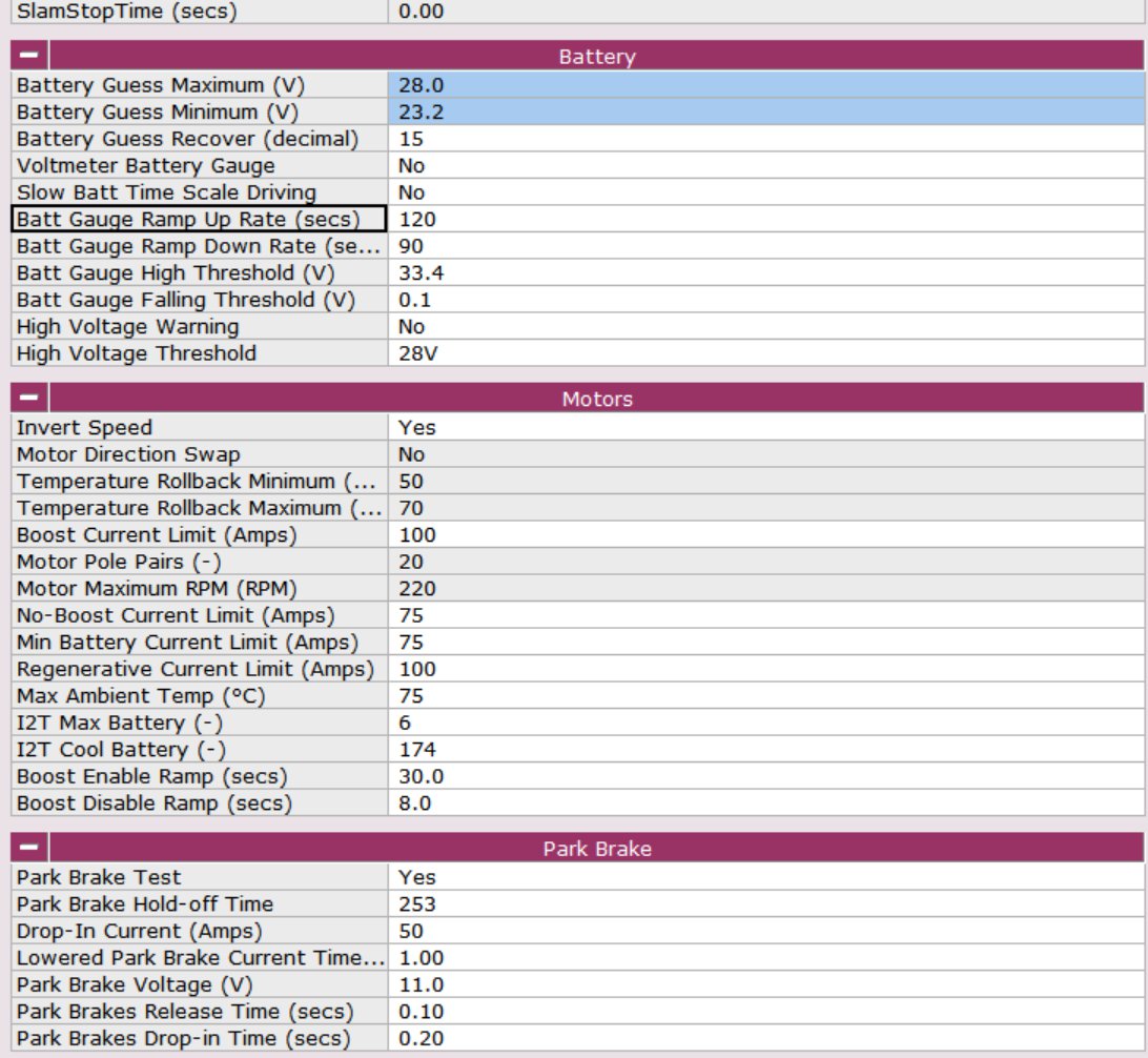

Postby stevelawiw » 03 Feb 2017, 19:10
I have a query...
I have 4 levels.
Lite (dealer)
Standard (Enhanced Dealer)
Advanced (OEM) which leaves a good few technical things greyed out...
And Service. I expected "write" as shown in the manual which only allows you to write a fixed profile and not editable. But Service appears instead, and seems to allow access to almost everything including stuff like below, giving us ample opportunity to really stuff things up!!! :D IF it allows me to write this to a controller. It does let me save to desktop. Seems to be a higher level than OEM unless I am seeing things.
I can confirm that the Service level does allow you to write to the controller, and that it is a higher level than OEM.
I'll try this for a while to see if I can get used to it, I get one green light now at 26.4v rather than four(max).

Postby Burgerman » 03 Feb 2017, 19:58
Set the empty light to 8x 2.7 to 2.8V
Posts: 71106
Postby stevelawiw » 03 Feb 2017, 20:14
Ok I'll try it. It's set to 22.4

Postby Burgerman » 04 Feb 2017, 13:10
A safe figure is about 3.05v red light if you want a 3 to 5 percent reserve. So set it to stop and cut power at 2.8v. These are unloaded figures.
