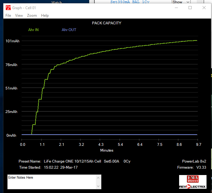

Well, my cells have been sitting over 60 days and today I decided to top them off and measure the static discharge. Right out of the gate, I gubered things up. Cell 01 had just finished charging and I wanted to get Cell 02 going ASAP. Also had to take my dog out quick.
So I didn't write down the mAh returned for Cell 01, I was distracted, figuring that the mAh returned info would be retained in the .CP8 file for that cell. However, all I'm seeing from the .CP8 file for Cell 01 are the graphs.
What are my options here? I don't want to wait another 60 days and start over after I get the rest of these topped off in the next day or two.
Cell 01.CP8.zip
(4.72 KiB) Downloaded 254 times

Postby Burgerman » 29 Mar 2017, 16:59
It shows 101mAh returned.
You guys all need to go on computer driving lessons. 9.6 mins and returned 101mAh before the termination current was reached.
I rest my case! :lol:

Espresso. Let me guess. You have your computer set up in retard dummy mode?, so you cant see file extensions?, and you have not removed the HIDDEN .zip from the file name because you cant see that! (Not sure you are safe to use a PC alone!) :D
Rename Cell01.CP8.zip to Cell01.CP8 and then choose OPEN GRAPH. Once you have configured your PC properly and it will open it. If not I have no clue what you are doing!

Burgerman wrote:It shows 101mAh returned.
Thanks BM. I could have sworn I had seen that info in the .CP8 files for the cells when I first charged up the cells. So it's the Pack Capacity vs. Time graph that I needed to look at for that info. I checked a few of them, but not that one, didn't see the info I was looking for and kinda panicked LOL
